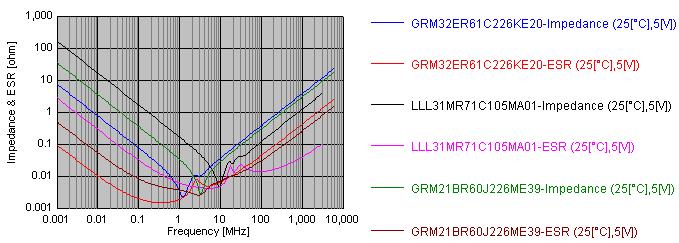

Hi Jake,
The best all round ceramic capacitor (price & performance) appears to be the Murata GRM32ER61C226KE20, Farnell 471-6747 - 22uF 16V X5R 1210, and cost £0.39 each in x100 Pcs.
I will use it paralleled with Murata LLL31MR71C105MA01, 1uF 0603 X7R 0603 – now I have to modify my PCB design which am about 4 weeks into![bawling :bawling: :bawling:](https://files.diyaudio.com/forums/images/smilies/bawling.gif)
For comparison, the graph below shows the 22uF 0805 you originally suggested, 22uF 1210 & 1uF 0603
Thanks again for encouraging me into action in this very critical area.
John
John

Hi Frank, Jaka,
Thanks for the TI link. TI often mentioned the App. Note but I could not find it on their Web site when I search last year..
The capacitor impedance / ESR graphs are generated from the Murata Chip S-Parameters and Impedance library which can be download from there website (2.6Mb). I recommend trying it, as you gain a good idea of variations between capacitor packages & dielectric types. You often find that a smaller value capacitor i.e. a 22uF can have better performance then a 47uF of the same family – and is cheaper, so its well worth trying different values, packages, voltages & dielectrics.
A hint - select the “DC bias voltage” to the circuits operating voltage, as dialectics like Y5V capacitance values can change by more then 70% under different operating voltages. In addition, you have to re-select the “DC bias voltage” each time you select a new capacitor type.
