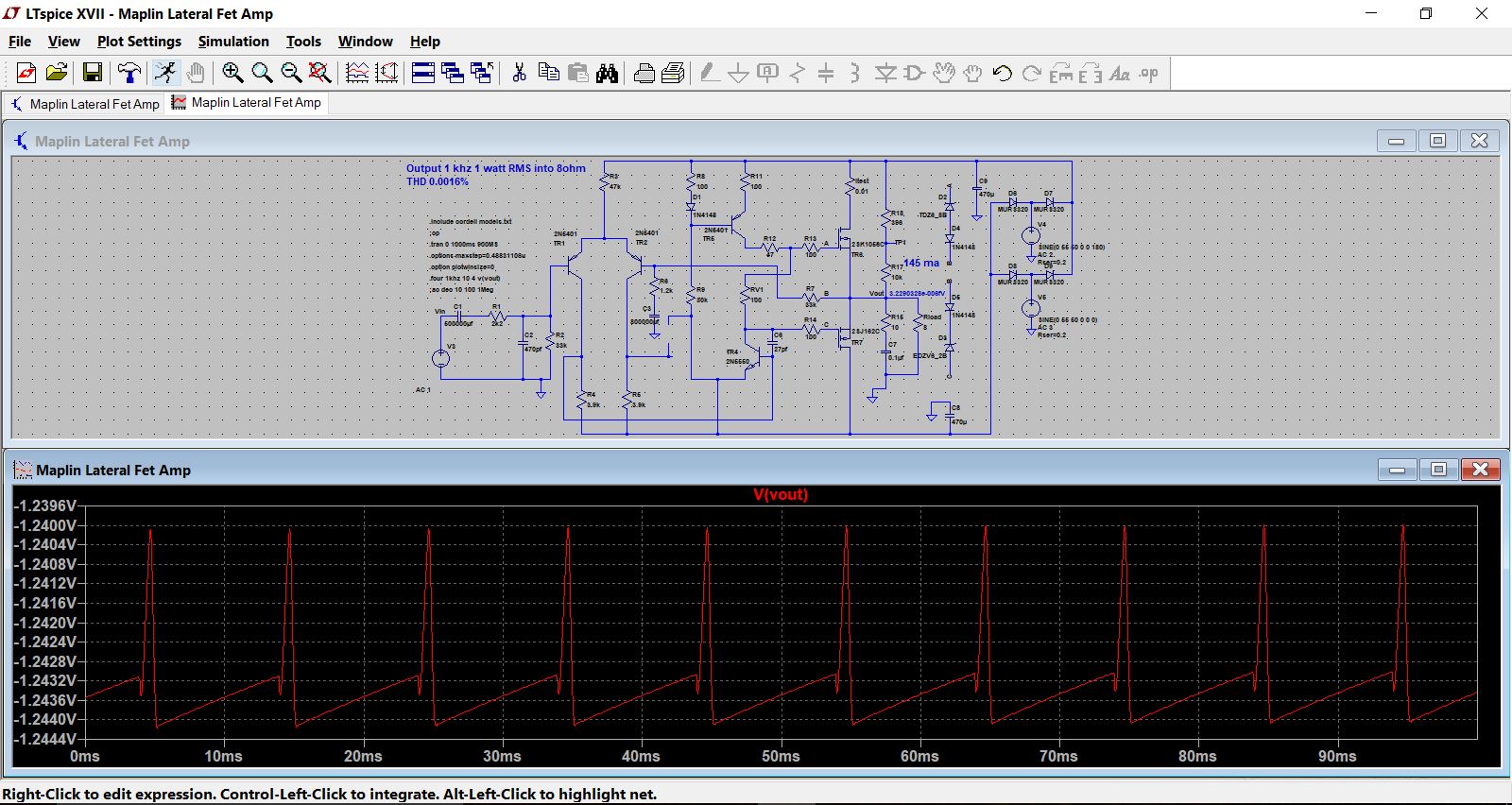

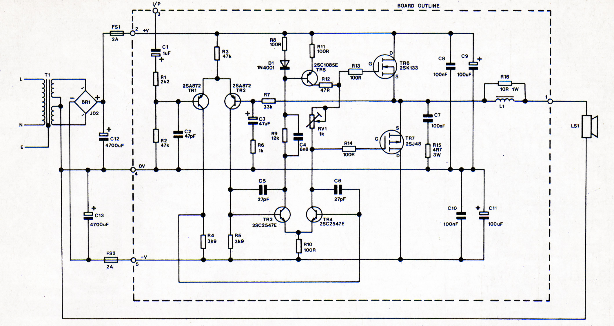

C4 is a mystery...why the rather specific value of 6.8nF?
R12?
Another spin on it 🙂
Think of R12 as providing the base bias current to turn on the current source (TR5). Almost 10ma flows which is a bit excessive. Lets make R12 a 30k and ensure TR5 is a high gain device. That cuts the dissipation.
Do we need TR3 ? Lets remove it and link it out.
Is R10 helping or not ? I would say not. Its reducing the transconductance of that stage. Lets link it out.
Switch on. What happens ?
It works. Outwardly and not a lot changes. DC offset is a bit higher but that could be addressed. All is stable.

Is R12 still needed, in the 90's Maplin article they even mention VR1 being connected between the collectors of driver transistors as if R12 didn't exist, and with no further mentioning at all of its role.
Does R12 really minimize start-up thump as earlier mentioned in this thread?

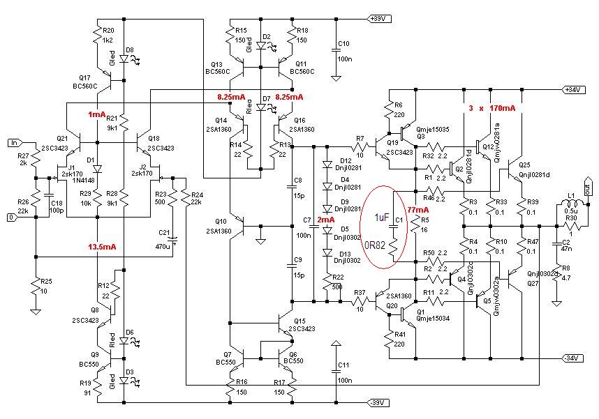

Has anyone commented on the symylarity between this "Maplin" and our Forum's Symasym and Roender amplifiers?
Note in both of these that R12 has been replaced by a grounded common base transistor (Q10 in the Roender).

I think you mean R9 = 12k. The Roender looks like something designed in a simulator! The double-differentiator, if you will, arrangement is common. But although it may seem a clever way to cancel distortion it actually brings with it extra problems that are rarely addressed. The Maplin circuit has some nice properties to it. I'm not sure this was by design or accident, tho.
You've turned it in to the more common, "RCA"/Naim type architecture. Single differentiator and simple Miller VAS. That will work. You introduce some distortion because the dynamic current to the upper FET goes through the variable resistor (RV1) but the lower FET is fed directly. In the Maplin circuit the current is fed equally(ish) to both FETs and the current through the variable resistor is constant(ish). In your circuit you would need to bypass RV1.
R10 in the original also reduces the transconductance, as you say. This reduces the loop gain and should help stability. Raising the loop gain is a mixed blessing because you have to be a lot more careful about stability. I think the Maplin design deliberately sacrifices feedback for stability. It's a cautious design. The pcb layout doesn't help it, though.

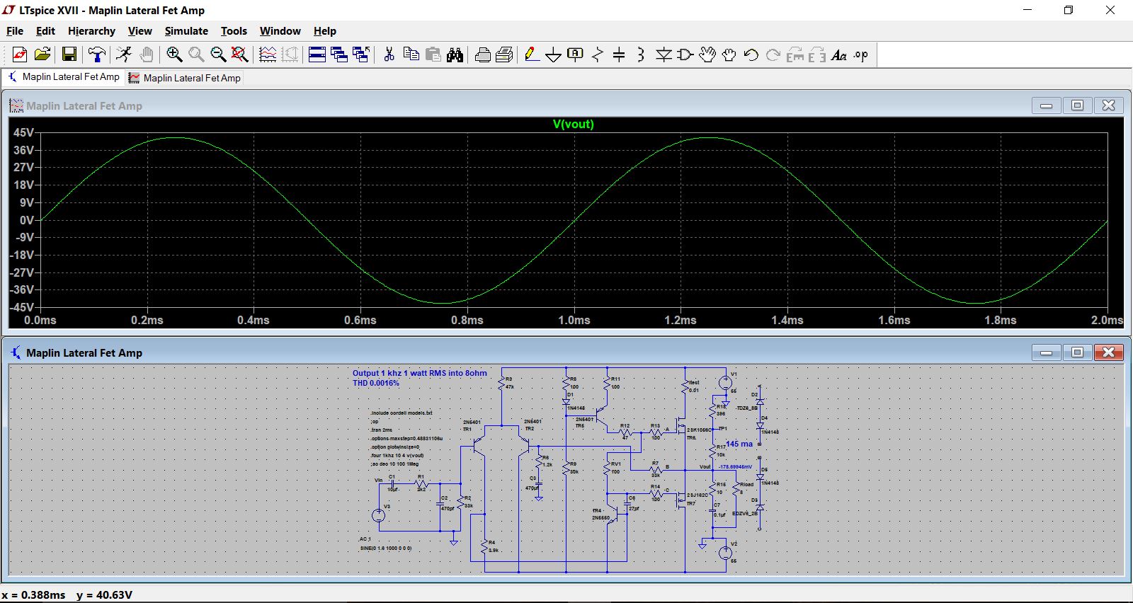

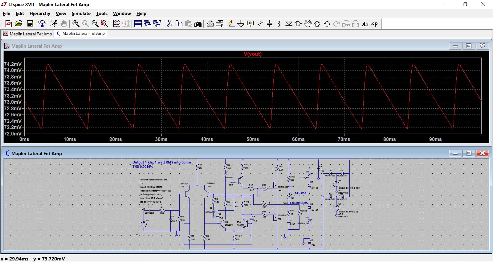

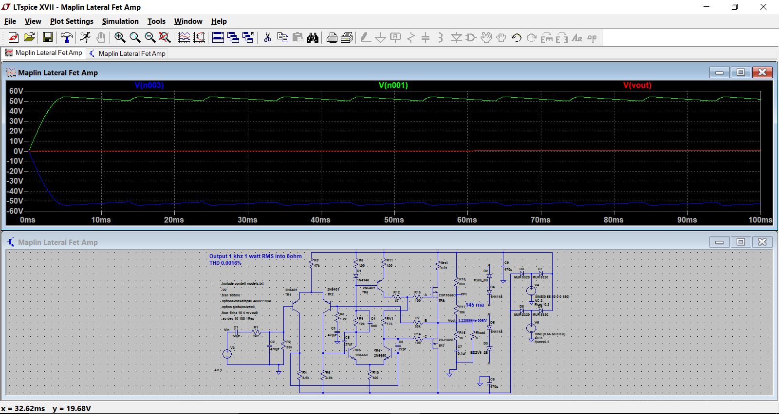

Use LTSpice and slightly overdirve the amplifier at 1kHz. You will see steps in the voltage on TR3 as C4 charges. Make it too large and the design latches after clipping for a while.
R9 (12k) limits current during clipping and improves recovery.
R4 (47R) is harder to explain. It might have been to modify clipping symmetry. The amplifier seems to work with it shorted

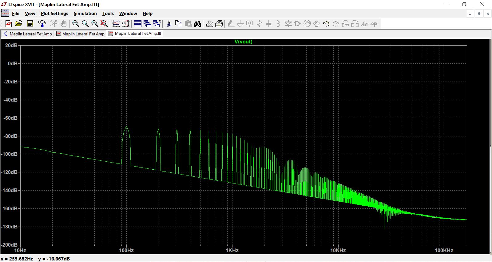

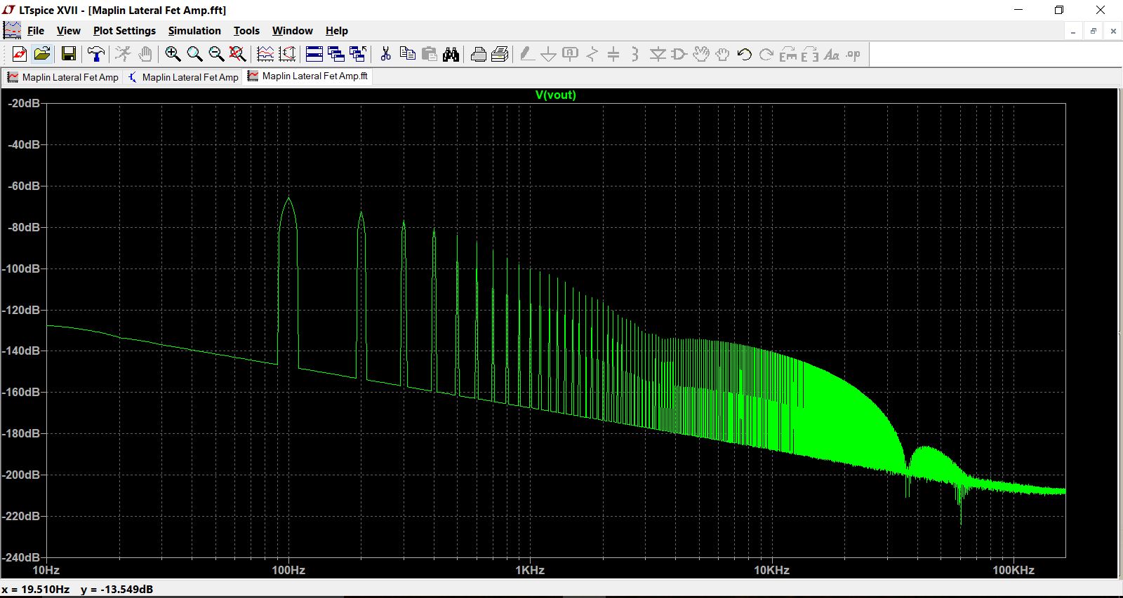

Here is the PSSR for the original. I used 470uF reservoir caps to generate significant ripple. Not the greatest sim in the world but it gives an idea.
