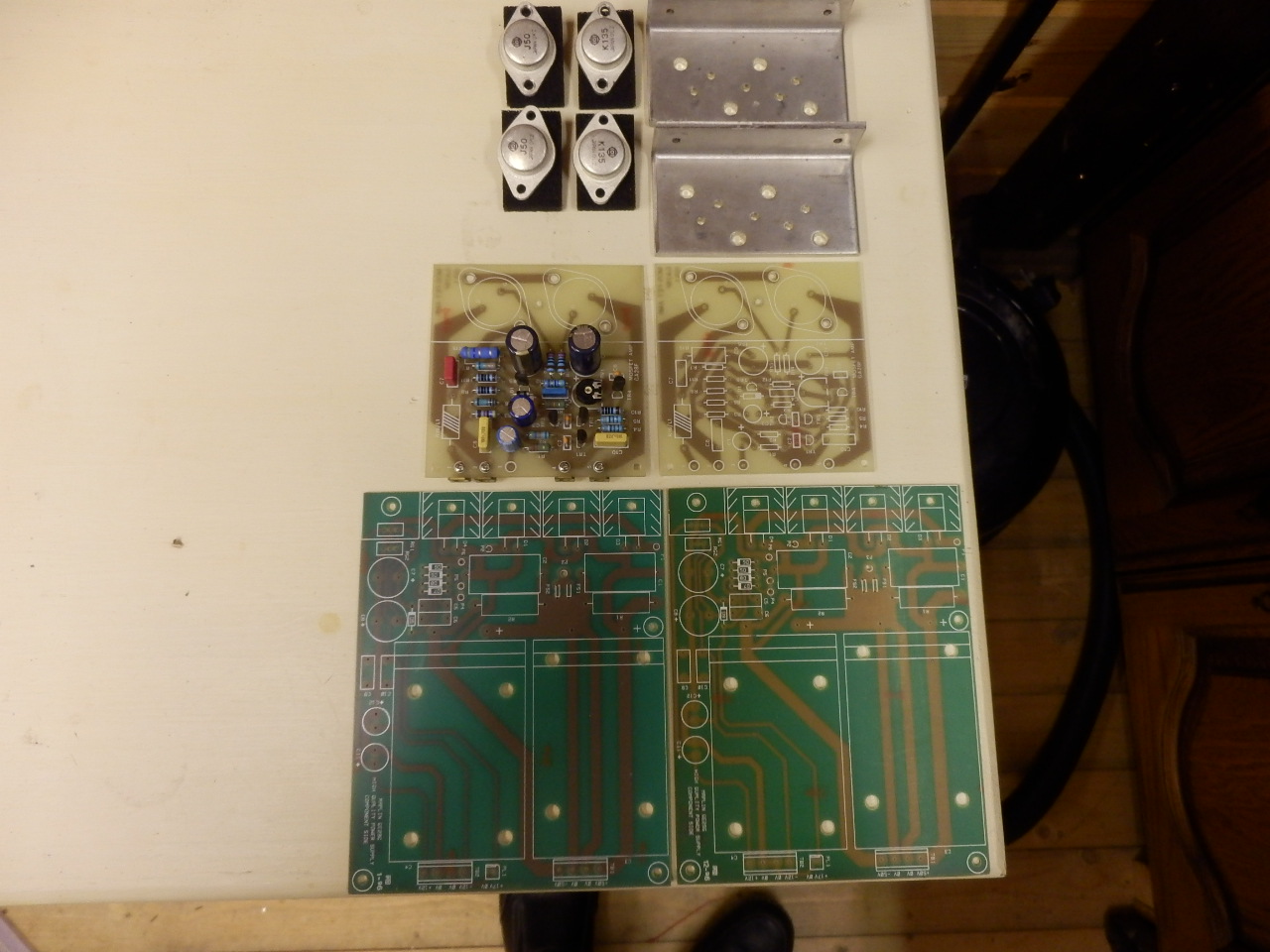

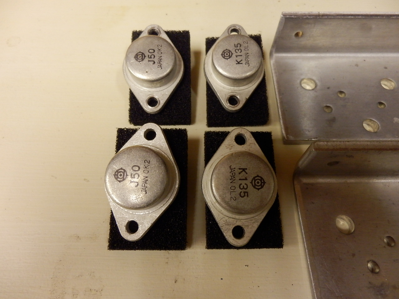

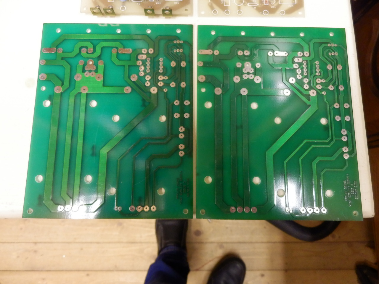

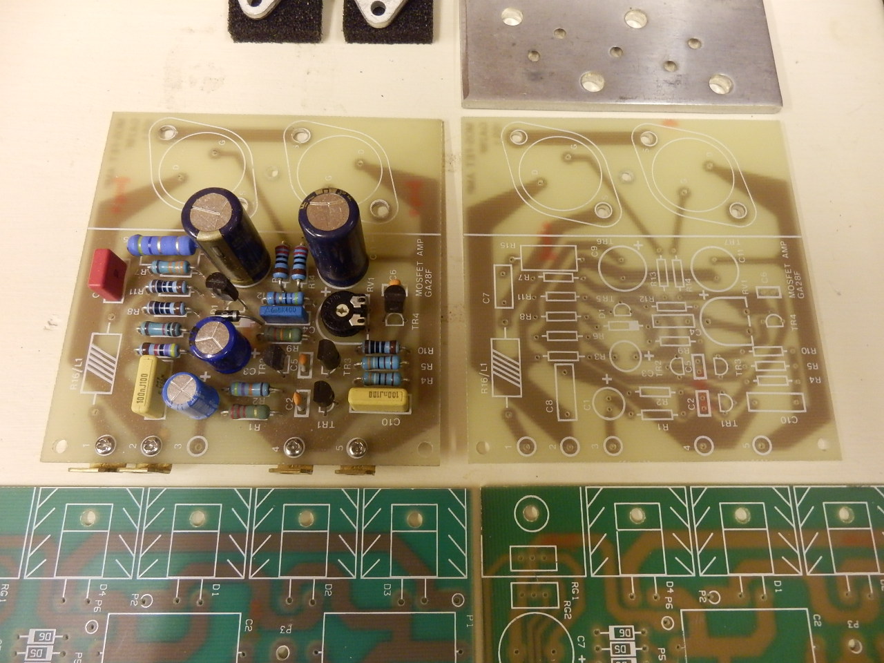

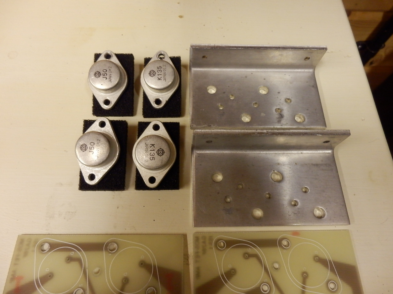

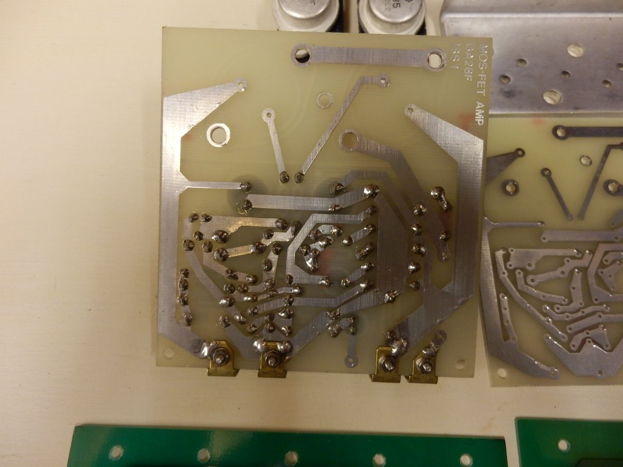

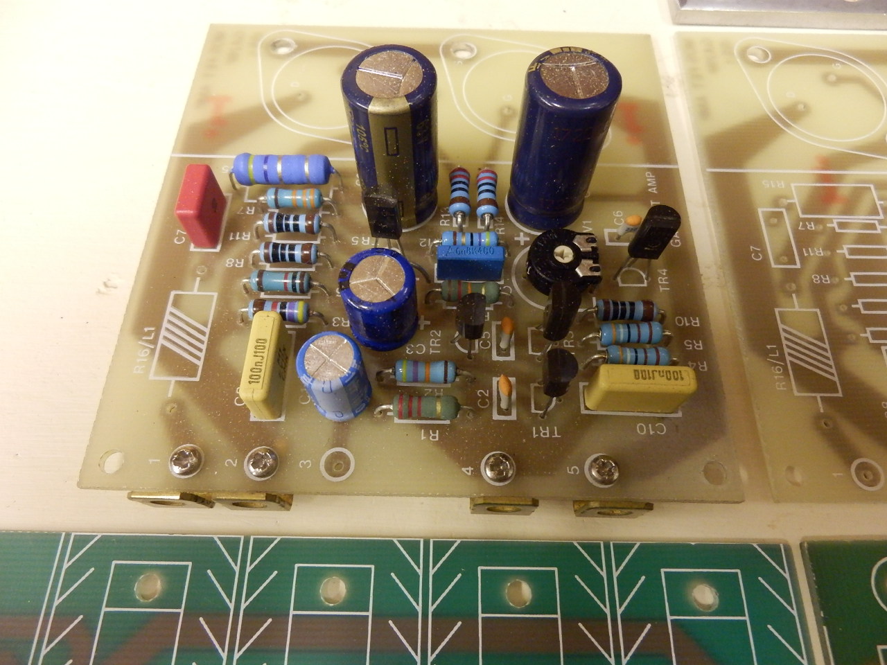

I have made hundreds of these and all worked first time without any issues, so in my opinion if you take your time making the amplifiers as per the correct spec they will work and give many hundreds of hours of listening pleasure
some pictures of my construction

Which R12 are you talking about? On my schematic it's a 47 ohm. With Vout=0V there will typically be about 5mA flowing through it and 250mV across it. Not much impact on TR5 which will have the same current but nearer 50V across it.
If this is the same R12 then I am confused if it needs to be 1W and have thermal spacers put on it.
