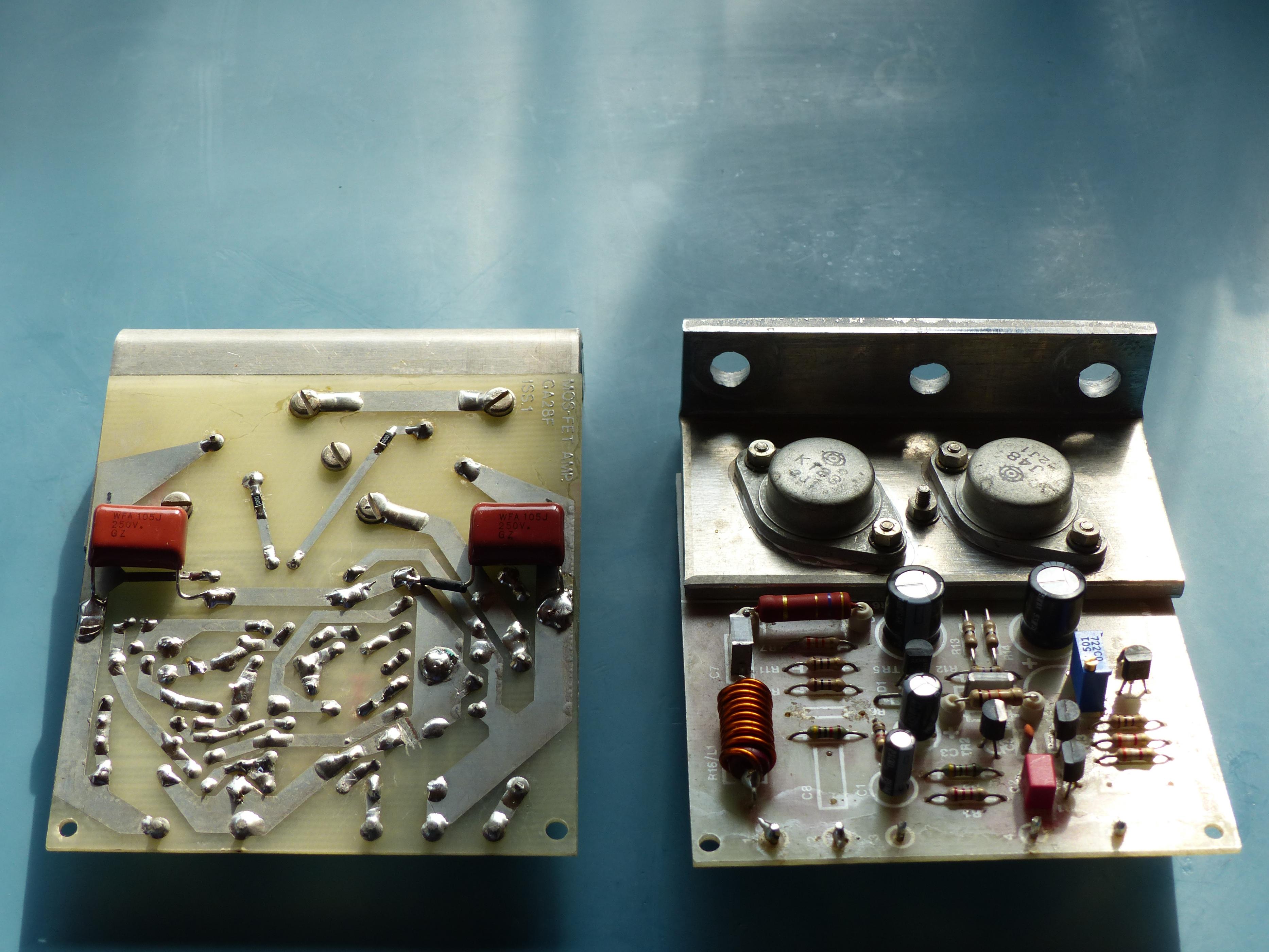

When I get my amps all back together I'll measure the voltage across R12, Wish I had ordered some 1 Watt resistors when ordering the other parts, I put the ceramic bead spacers on R12 when I very first built the amps as I guessed R12 was .5 watt for a reason. Way back then I don't think I ever paid any attention to actually how hot R12 gets, it was a case of, Switch on...... Nothing Blew up, Set Bias, connect Source and speakers ...... I have sound, Lid on, sit back and enjoy
Strange after 35 years plus, these little things are being noticed, and In some cases addressed.
Mods to amps completed, Less fitting new 12k - 1 watt resistor in R9 position.
Original Gate resistors replaced with Zero Ohm Links, Tracks cut and SMD 100R Fitted nearer to the gate pins of output Fet's.
C2 Replaced with 470pf Polypropylene Cap, there was enough room to drill the PCB to get the pin spacing correct.
R6 Position moved, again new holes drilled so resistor could be mounted to board properly.
0v Track cut to separate the zobel network and local decoupling capacitor ground from the input signal ground.
RV1 replaced with 500R 25 turn Cermet trim pot, yet again, a new hole drilled to allow proper fitting of the device
C8 and 10 removed, and replaced with 1uf Polypropylene caps on rear of board.
Top side of boards have now been cleaned so look much nicer than the picture.
