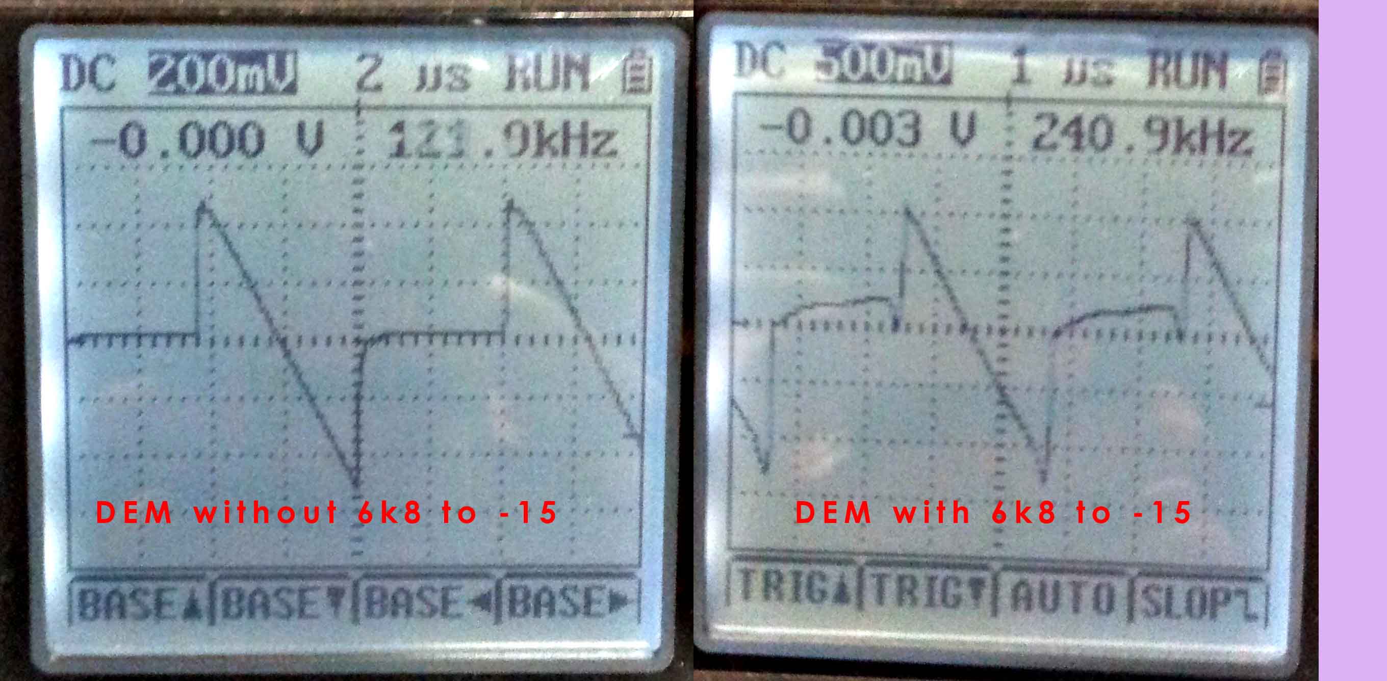

DEM with and without 6k8 to -15V
I've taken a look at what's going on with the DEM with and without the 6k8 resistors to -15V.
They were taken from different chips running at slightly different speeds but I think this shouldn't affect the shape of the waveform.
Take a look and see what you think.
Looks to me like there is less RF energy in the waveform with the resistors. Its almost as if the waveform has less force imposed on it. But then again i think i may have had a few too many beers to be the judge... and i know that the images aren't the best but thought i might share for the sake of a common interest. 😕:up:

I'm happy to know that there is a difference and that its not just all inside my head (for once).
What does that deviation from horizontal between the two waveforms represent?.
If -15V is the analog section supply voltage of the chip.. .. ..
Dunno but interesting, maybe John could comment?. Would you post over in his thread, or if not, I would..
edit: I've just noticed one is more than twice the amplitude of the other.. and twice the frequency.. any chance you could take two on the same scale and at the same frequency?.. I'd be keen to see what happens to that deviation which looks kinda worrisome.

Yeah im really not sure what it all means. If i get time today i'll remeasure to try and get more accurate and meaningful representation of what is going on. 😀 ... but the kids are running around like crazy at the moment...:whacko:
lol haha. not a bad idea, might have a good production line going in a few years.. let the 1541 live on.
yup, its not slave labour if you feed them.
could you use the same sampling rate for the screen shots and then try again with metal film?… yeah I know.. but you're the one with the oscilloscope 😀
edit: and the same chip !!
