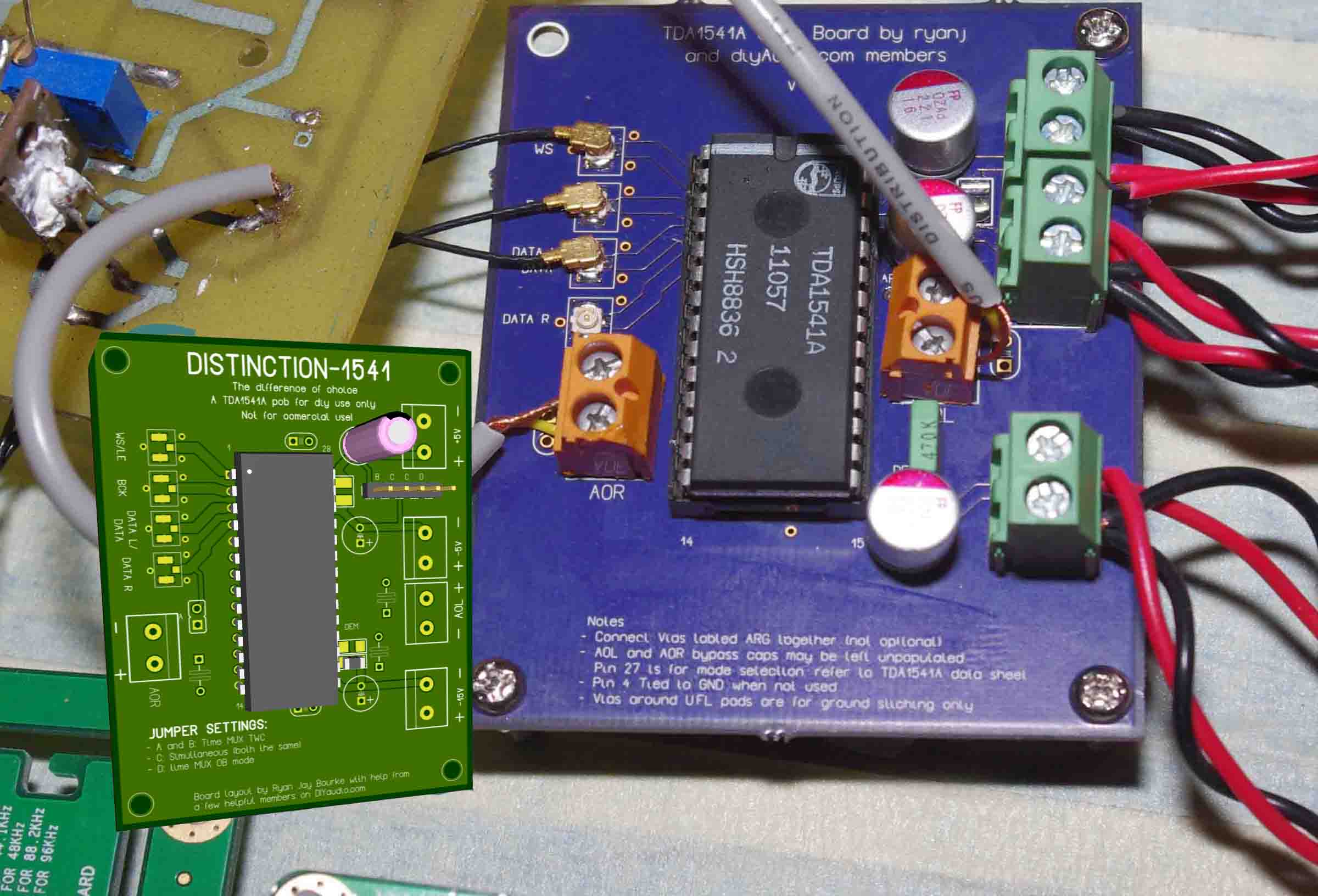

Hi Eldam,
I received my test board last week, and everything works ok. Just a few minor changes to the position of some components. No exact date as yet.

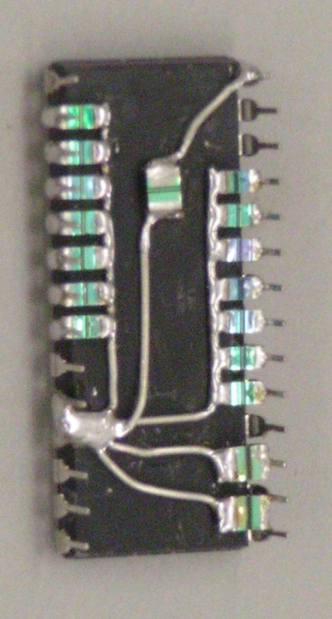

Oshifis only removed the 14 filter caps, not the dem cap.
🙂 : a photograph, a photograph ! cool ! Good work of the printer ?
Oups you right, I writed too fast (and no beers 🙄; the DEM is 470 pF most of the time with TDA1541A - included in TDA1541-non A) : yes of course just the filtering caps !
For those one (but maybe the two bigger) the best choices seems between these 4 :
- none
- acrylic smd (Cornell Dublier or Panasonic... IIRC)
- silvered mica smd
- the smd caps used by AMR (don't know the type, any AMR owner reader here with a usefull input ?)

Hi Eldam, always a pleasure to read your posts, thanks for your support.
Ill attach a picture of the current test setup I have running at the moment. Ive also made a few changes to the design that I will also attach.
To comment on the sound improvement would be slightly biased!... but it does sound better than my home made acid etched board by a good margin.
In the amended design I have spaced the power supply caps out a bit and also added jumper pins for easy selection of data input modes.

Wow, Very nice looking... I like it. And it has now a name with deep 3D meaning.
"but it does sound better than my home made acid etched board by a good margin." : :xfingers:
Do you get a chance to the Panasonic LE caps instead the FPs of your photogaph ?
Hi Eldam,
No i have not really played around with different caps in these positions as of late, as i have never really noticed as big improvements compared to layout configuration. Ive always been more focused towards lowering the nasty "jitter!" which i have found to be any area to obtain the biggest audio quality improvements. Capacitors - for me are always a fine tune adjustment.
