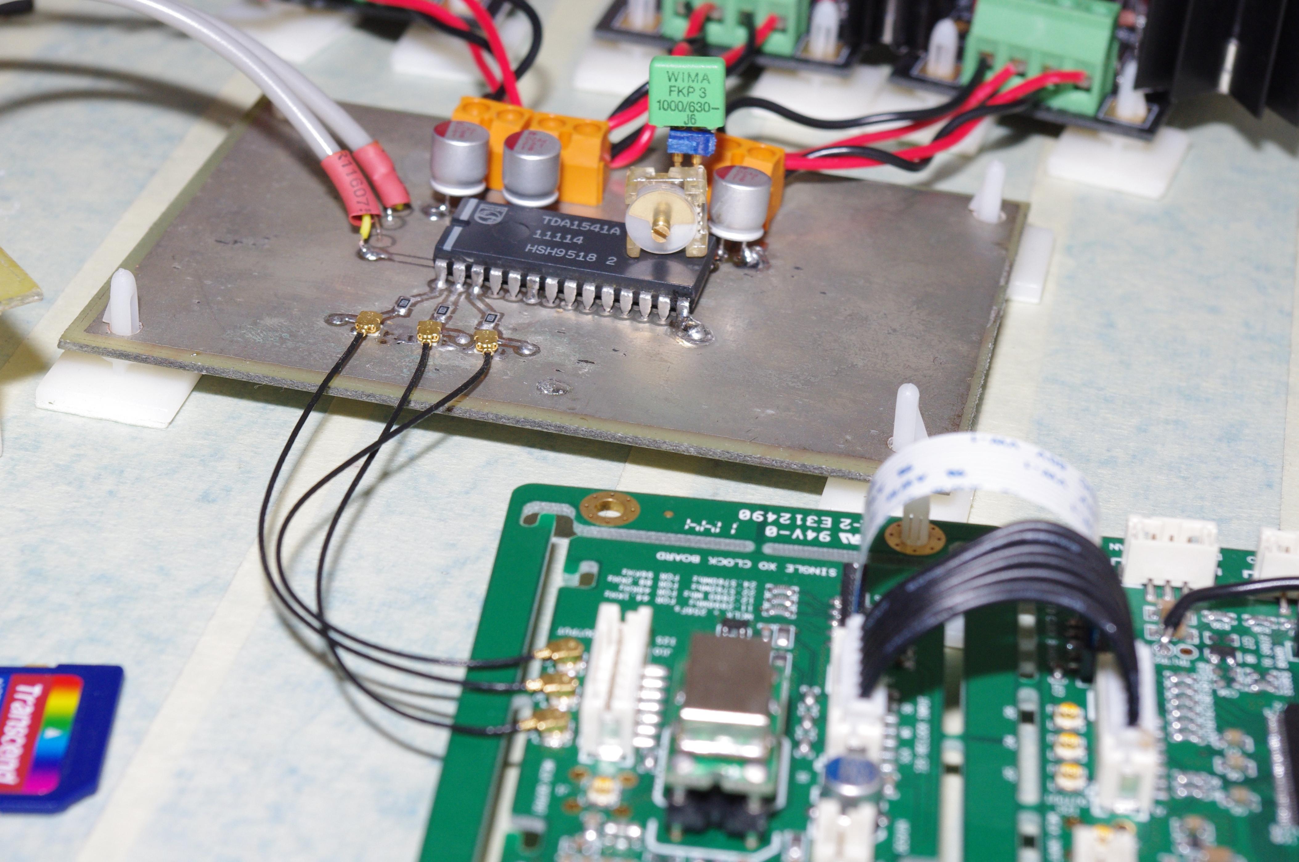

crystal layout

Is it bad to put a four pad clock "island" close to the left of the dac chip or below the pcb and put vias on the midlle of the pads for the ones who want to stack a crystal board for more complex design (frquencies dividers... ?)
If no the first version for a v2 ? Bad idea from me because bad layout (because of the RF needs?) ?

Eldam,
I would use separate supply for the clock board, so two pads close to the DAC chip could be enough.
The crystal clock board I'm developing (PCB almost ready) provides 2 u.fl. connectors (one for the DAC and the second for the source) and 2 pads to fit the board vertically close to the DAC.

Why not have 4 pads for most of the crystals avialable on the coreboard itself ? Because RF (with the dac chip as for the source distance can't be avoid but just minimized with PLL, buffer...)?
What is the best trade off according to you :
-crystal near the source and power supply on a stacked board (assuming supply is less fragile than RF signal).
- or crystal with its PS on a pcb stacked above the Dac chip ?
What is hard putting 4 pads on the core boards as there is space avialable with the BCK and Dgnd not far (one for supply, one for the signal, one for Gnd and one not connected) with vias on the gnd & + V for the stacked pcb ?
Does an uf.l connector allow less crossing ? Caps being below and in the center allow the space for the 4 pads ?
Is the 4 pads not universal between different crystal brands and size ?
For example if you design just for a cuted crystal or a four pad crystal but others people want to put something else, what is the most versatile design in relation to sound quality ?
It seems important as the source are more and more of a SOTA quality : Acko, hifyDuibno e.g.
Anyway, with the 4 connectors uf.l connectors there is a good trade off. Finding a design with four pads and 1 uf.l connector for its signal pad without RF problem in the same time is maybe a problem if the two solution are both on the pcb?
I surmise uf.l connection if SOTA because the impedance matching and the coaxial shield with the gnd to be more jittered than a trace with soldering on a same pcb ? Does uf.l wires exist in 2cm, 3cm ? very short to avoid EMC and more jitter ?

But why use a circuit that was bettered by a simple capacitor? The grundig 9009 cct with the DEM synched to BCK is quite a bit simpler and mirrors very closely to the cct provided by Philips themselves.
Discussed here too: http://www.diyaudio.com/forums/digital-line-level/11949-tda1541-dem-reclocking-26.html
Anyway, it's very simple to add a smt resistors or a bulk ones between the pins.... this doesn't need to add traces on the pcbs. I often forgett what T. said about 3D design for DIY... we don't look for beauty in the eyes but in the ear, if Sound quality don't suffer of a 3D layout here with added little Dale resistor or smt Sussumu it really doesn't matter to have traces for that...BTW, traces can be sometimes worse because too close of an another trace !
Shane, Ryan, did you try both solutions already (with and without the resistors for the DEM clock ? Better result with the non-A (good SF book) TDA1541 which has this cap inside its substrate ?
What do you think of the pads and vias for a crystal ? Crystal & PS stacked above or below the left side of the TDA or just the ps stacked and the crystal on the core-board with two series pad before the pin of the TDA for a serie smt ferrite bead ? Bad compatibilities with the layout and the u.fl already populated ? With vias both solution could be choosed after by each diyer (one vias on the signal trace near the uf.l signal pad and one trace lose to it on the continous gnd plane ?

Hi Eldam,
With the DEM... I never really found any improvement when i experimented with "locking" on to Word select... I used an air cap to adjust the frequency. I tested by listening to -60dB recordings... Nothing. The only time i noticed a change was when i tuned it way up to 2Mhz+, recordings at -60dB sounded distorted.
Another thing i noticed when tuning and trying to lock at 88khz is that the DEM circuit seems inherently jittery. When i looked on my scope you could visually see the frequency jumping around never stabilizing. So i went back to DEM frequency of around 260khz and left it at that.
I cant comment too much about oscillators, crystals, and their circuits because it is a bit out of my understanding, but i was thinking it would be great if we could add the oscillator circuit right next to the 1541 and have it run off a single LiFePo cell (3.3V). From what Iancanada was saying there is a big improvement in jitter levels. I've run my entire FIFO off a 6V battery and the improvement is quite noticeable, there seems to be more coherency in the music.
Thank you Ryan for the inputs.
Here I was talking just about the 6K8 shunt resistors with pin 15 (Vdd2) like in the link I gave with the John's answers (and no more about DEM clock with Wds or Bclk which is given up):
