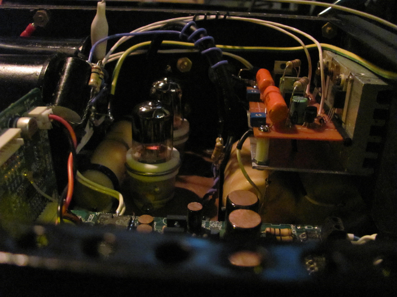

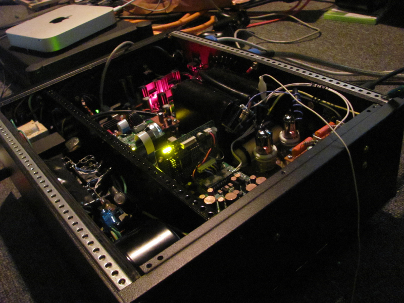

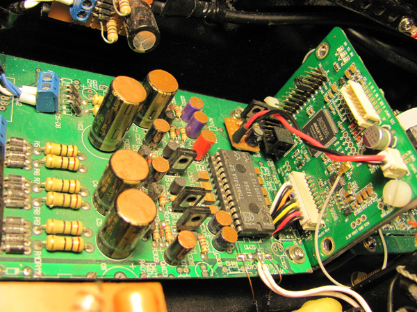

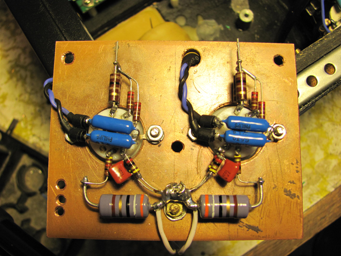

Finally got it all into a proper box. Nice and quiet.. time to put the lid on.
Mundorf Zn output caps potted in bamboo tubing with Elephant ear wax from the zoo !
Joined 2006
Very nice Ceglar! That's a lot of work put in🙂

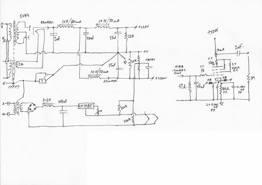

How bout a Thorsten tube output stage and power supply, maybe with transformers like his addagio?
Hi Luke,
If you search around you'll find that his most recent circuits use resistor I/V and the DC output from 1541A (-2mA) current to bias the tube (in combination with some cathode resistance, but not much).
This is all easily built point to point with a couple (or one) sockets
D3a might look like this (or not), but its very straight forward, and with lower Gm tubes, even moreso.
T's B supply might differ, but theres no hard and fast rule.. same with heaters (DC). The main T idea is low bias and utilising the offset current from the 1541A.
No idea how it compares with his cd77 and dp777 implementations but from what little I know, this is a simpler approach (better? dunno) but it was suggested as 'what he would do' not so very long ago. http://www.audioasylum.com/cgi/vt.mpl?f=tubediy&m=221747&VT=T
If you need some ideas, I have a scheme for 5V4G - 2uF - 10H - 110uF then split to [10H - 55uF] per channel, with adjustable CC sourced heater supply which floats at 35V. Heavy 10mA shunt R's across each final filter per channel to help lower noise.
hth

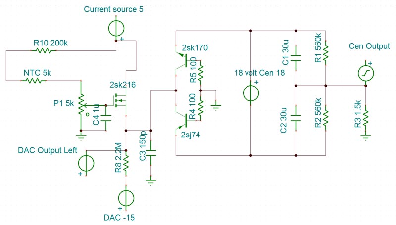

Hi Shane,
Im keen to try another tube output stage but what about exceeding the output compliance of +-25mV on the 1541? With the circuit you posted wouldn't this figure be around +-78mV? Or doesn't this seem to matter?
Have you tried Cen/Sen? I highly recommend it. Ill post schematics of my setup. (I may have already posted it)
In the schematic you could omit the NTC, R8, C3. And Add a cap parallel with R3.
The 18V floating supply is 5, 3.7V lithium cells which give about 20 hours of listening depending on the Idss of the jfets (recommended 15mA+)
