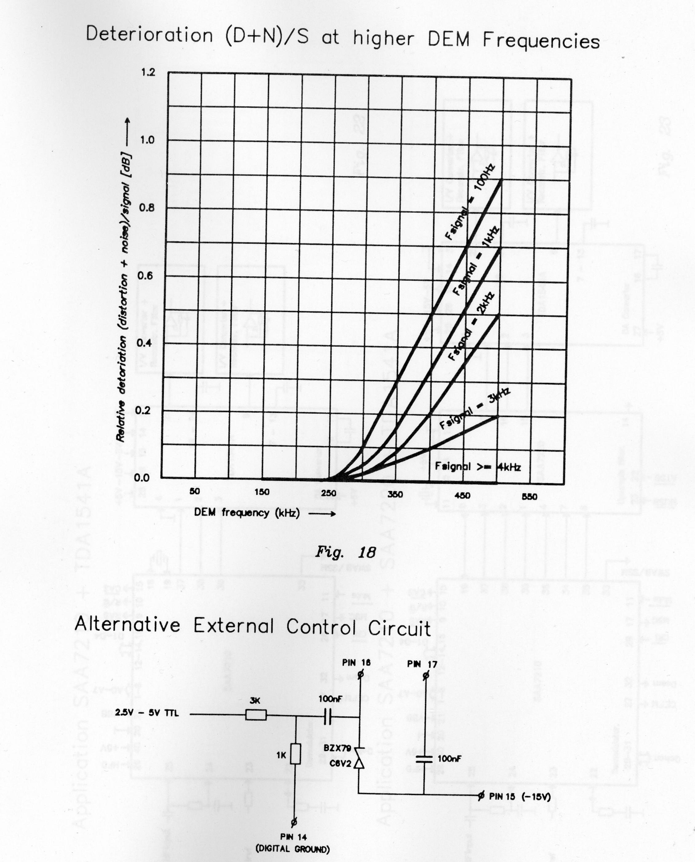

The GD9009 cct has the 1541A in 4x OS mode, therefore synching DEM to WS is has fDEM at 176.x kHz and follows the supplement sheet about fDEM being ~4X sampling frequency.
Nice simple circuit it is, but with NON OS as WS at 44.1kHz perhaps not so well suited. However, no need to throw out the baby with the bathwater.
Technical supplement by Philips provided to OEM using 1541A has a very similar circuit included, functionally exactly the same but slightly different, it explains about the resistors and (in particular for the discussion) D501 as protection against internal breakdown during switch on and off which might cause degradation of the hFE.
For NON OS, simply divide BCK and synch to that. Something like 2k2 series and 100nF silvered mica to pin 16, 17 to AC ground (functionally) via 100nF series to -15V. Not sure it can be simpler than this.. just need the best divider for the job.
You could even tap from several output pins of the divider chip and have the DEM frequency then selectable to suit a wider range of applications and/or experimentation - much like a DEM Gearbox, would probably make for a good supplemental project/PCB.
Shane
For your interest.
Re: frequency
As you can see, synching to WS at 44.1kHz (Grundig 9009 DEM cct applied to NON OS) has the DEM at 11.xkHz, (44.1/4) which is within the audio pass band.
Referring to the last couple of sentences in the attachment, it seems to follow that for up sampling in real time (PCM mode and PC playback) fDEM could be 192k x4, assuming the decoupling caps were appropriate.
