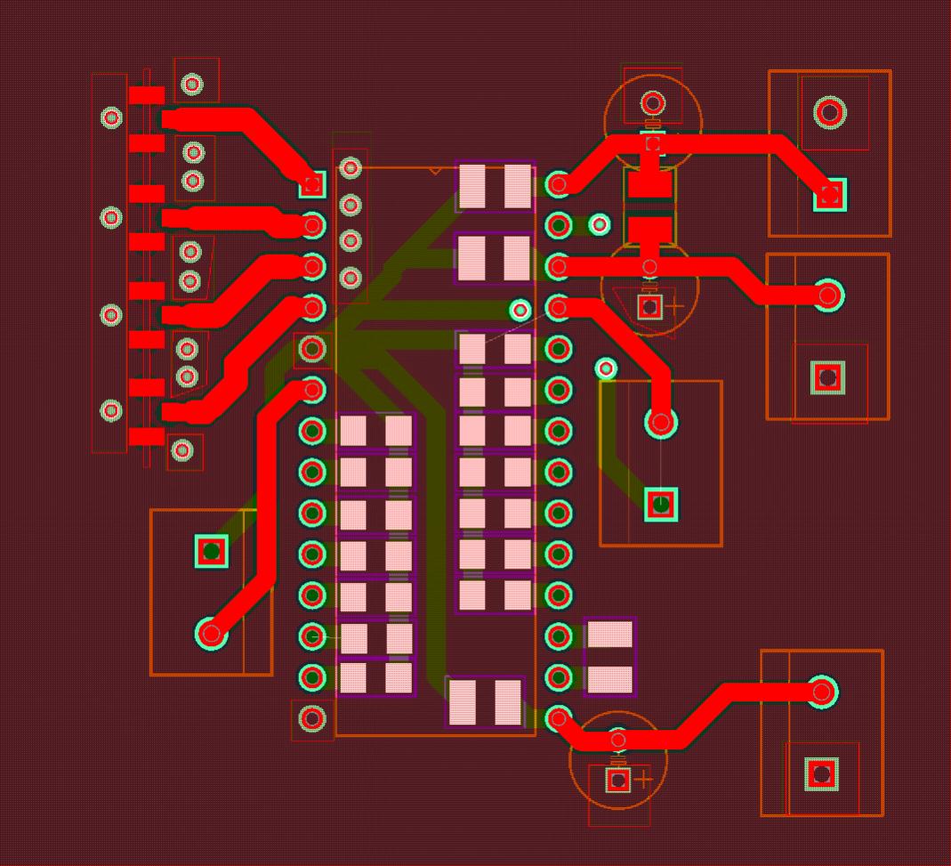

Jaffrie,
The smd resistor can be low noise sussumu between 30 to 100 ohms, or just 50 ohms ! John advise also greater values for I2S attenuation : look at him thread (but beginn at the middle as it's long and had multi versions of the initial design !)
SMD inductors/ferrite beads can be added before the last bigger caps of the three powers voltage and a bigger cap at a edge of the board between. My understanding is when you have multiboards with a phoenix connector for PS is you need the first local decoupling caps have to be near the connector at the edge of the pcb ! General rule of design...maybe i'm wrong. Do you think stand alone 47 uH or 100 uH Murata should not be better ? or ferrite beads (600 ohms ?) . I have no knowledge here... or elsewhere actually !
So for each phoenix connector for PS board (three voltages), then three caps: one for each connector, let say 100 to 470 uF then each voltage. Then serie ferrite beads or smd inductor, then local polymer at 2 or 4 cm to the pins, then on the pins : decoupling with 605 case X7R cap for the best inductance, stay DIY soldering friendly.
What do you think of that ? Others, any experience, here I try to understand it with looking at others pcbs...
Also a question, under the I2S traces on the other side of the board should there be no earth plane to reduce capacitance as well?
Regards the inductor, need to do calcs on the resonant freq as I tune RF welders using tank circuits in the 27 and 40MHz ranges.
Is it possible to add through hole connections for the MSB caps and put the ground side under the chip or at least the caps under the board? Couple blokes here want to test several sets of caps against the recommended versions to check sound differences.
Thanks for efforts gents, this looks most promising!

Different regulators work in different ways. I like regulators operating without feedback for use tda1541A. Others find CCS fed TL431 just fine.
Anyway, with the board that ryan j. has, just the last filter is on the board, so you can use what you like anyway and still make good use of the PCB.
I have less understanding than all of you, here my two cents :
Set3up said than a aditional vias on a strip after the uf.l connector will ruin all the effort (for the one using th uf.l connector, not the vias for flat wire). So if a output signal vias is needed in a RF strip where a uf.l connector is needed : the vias has to be on the middle of the pad where the signal lead (hot point) of the uf.l conector has to be soldered ! Or the matching impedance with the daughter board should be ruined ! Of course if the PCB cames already from a supplier with the uf.l soldered : just forgett the vias in the design. But here for the moment it's DIY friendly with the tools we have... here the soft Ryan uses.
Elswhere it's less important. For power caps it seems less important here but look at in the amr product at Sixmoons link where the bulk caps are: close to the chip body. The idea is if you use smd caps with strips and vias for bulk caps in each sides of the smd pads for soldering: it ruins the inductance : so never use vias on the small decoupling caps near the chips (the 0.1 nf caps) but in the middle of the soldering pads like said Marce fellow.
T. Loesch said here than ceramic has to be avoid for MSB : so if vias of the MSB decouplings pads : pitch has to be 2 mm e.g. for wima MKS2 (max 1 uf) than Mr T use himself at home (testimonies above) and here soldered below the pcb head in bottom position. Set3up testimonied above than smd film caps can be killed too easily with diy use (Soldering iron EMC + the hands of the diyer !!!). So trade off has to be found : acylic like ECDESIGNS, or polymer tantal, tanta, or less fragile smt film caps ! Don't know myself, I liked elswhere with tda1540 the wimas.
About the gnd plain for MSB, many testimonies above in this thread from T. Loesch and Set3up. A testimonie as well who said than ECdesigns give up to come back with a plain continous ground plane ! T advised to go with a piece of copper foil around the body of the chip for inductance & EMC but don't understand which gnd pin is used : ask Set3up here...
For power supply if the core board is a little one for everybody which seems to be the way we follow now i really think like i say above than a design with caps near the chip and near the edges of the pcb (where the phoenix connector for PS are) is the way to follow : a ferrite bead before the two bulk caps with two smd pads could be a good idea (people will put what they want here). here a third pad can be added on the gnd layer for a three lead ldo reg instead (like the TI low noise I linked above in the thread) but think than a ferrite bead or inductor should be enough... For me the bulk caps pads have to be two pitch for choosing the "flavor caps" 2.5 and 5 mm pitch on the gnd side : so three vias : one for the power strip and two for the gnd to choose the width !
I will say here before Ryan loose time we need testimonies about the ground loops and the gnd pins and powers pins of the chips ? Set3up ? Anybody else experienced who read this thread ? Question to ECdesigns in his thread ? (But I'm the first to think than too much people ask too much to John with 2 cents questions...).

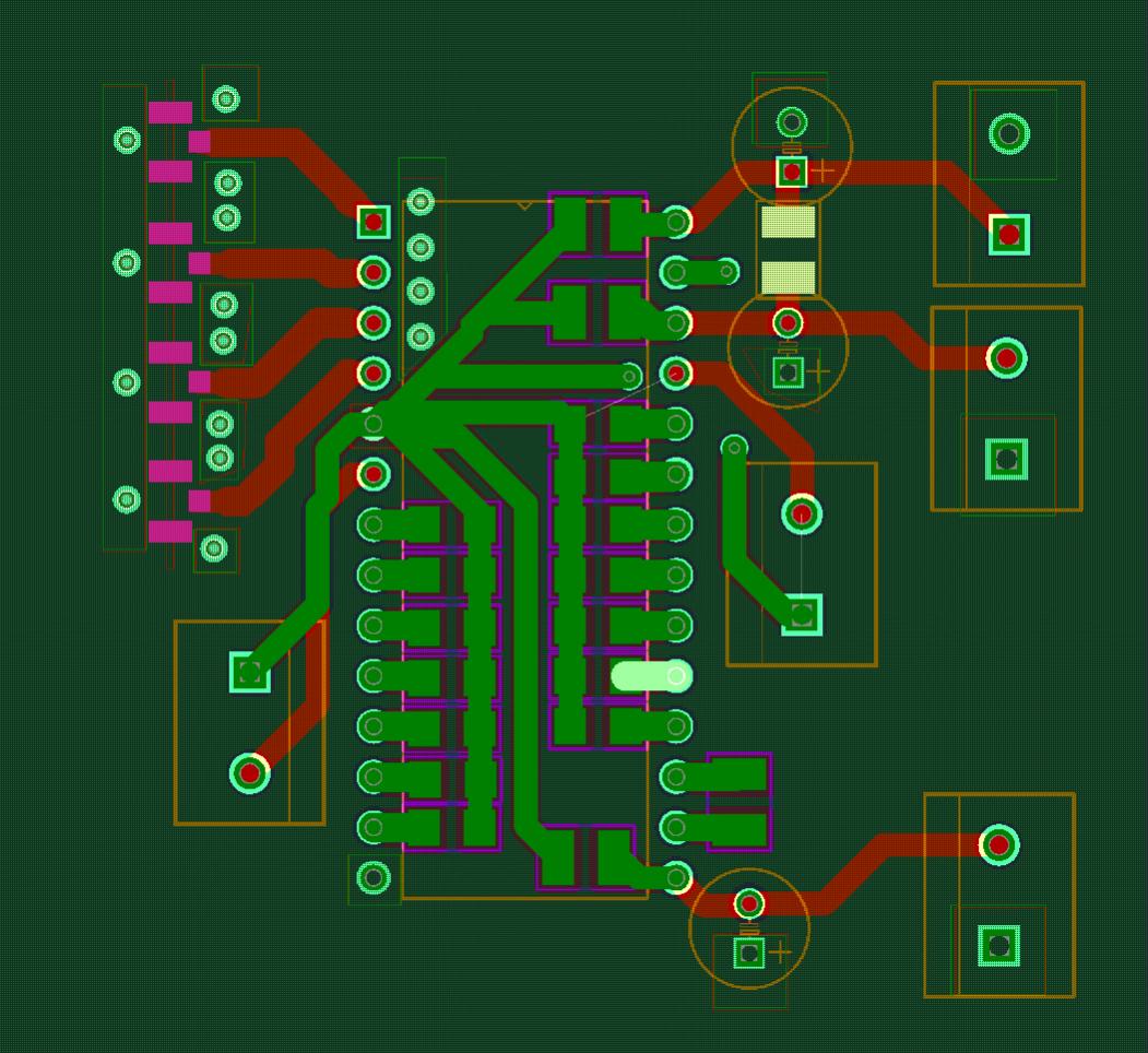

Current layout.
I moved the AOL and AOR outputs so not to cut into the ground planes as much.
Looking good. We'll wait a bit for any more suggestions and then pack up the Gerbers and get some PCBs made.
