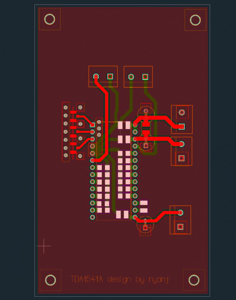

I really hope two project can suceed : AYA GB, if people fellows can help each others (and if P. Rodric agree) will allow for a maximum of people (as this the goal of the original question "Any good kit today") to have enough quality. A not brand new design but a kit used to be sold and reprint will give a good result for maximum people with minimum risk and level with a owner manuel assembly. CFT is doing the work but ha already top material at home. People may thanks to him.
On the more fanatic side: for the moment SET3up is working to something.
Here people are merging to a I2S DAC board with a good quality :uFL connector. It seems a need exist. I can just understand the half oy what you TALK ABOUT (Am I not the good willed Mr Mustach Chewbacca ?) but let's go if a pcb for good diyer can exist and can to be print of a web plateform or be edited in a small GB : it's fantastic also for people to have a good fundation for the tweaks around (source, output) with a SOTA or almost SOTA coreboard (good layout, goos PS, output connection for output daughter board or stacking board; UFL connector to improve quality of I2S connection).
A question to Andrea : if a four pad emplacement near the DAC for the crystal, does it need too a serie smd space for a smd resistor (resonances) or smd ferrite bead (also resistor attenuator if needed) before the dac clock lead ? It need also a powersuply so all the layout for the good ldo 5 leads reg (3.3 V for the Crysteq ?) and the smd caps and/or inductors/ferrite beads around ?
Maybe the solution is much simpler: if the board provides 3 u.fl connector (SMD) everyone is free to use the BCK coming from the source as well the MCLK coming from the master oscillator (4 u.fl cnnector if the simultaneous mode should be an option).

But a good crystal needs to be near the chip or it's a waste if its qualitie is high like the crystech or Laptech ? If a connector near the dac it is hard to make very short, does such wires exist or are esay to do by a diyer (it's very small ! solding the plug on a pcb ok, but the jacks for the wire... Huuuuuurk !).
Maybe be more easy to put a u.fl connector + the fours leads for the crystal also and a through hole for the PS. People can use uf.l connector if external source clock or put an embeded crystal on the four leads (if such a design is possible to draw !) and put its ps on a little board as you described !
2 cents don't know if it is possible... believed the first picure of RyanJ was something near about a crystal close to the dac ?! i have to look at it again. But for sure the last little board he drawed is elegant...

Right, but we are talking about an open solution with several options, so an u.fl smd socket and a short u.fl cable should be a good compromise. Obviously the better implementation should be placing the oscillator as close as possible to the dac chip. In that case we need a 5 pin connector close to the BCK pin of the dac: clock ground, clock signal, PS1 (15V for the sinewave oscillator), PS2 (5V for the squarer), PS ground (the oscillator needs 2 PS rail). Keep in mind we are talking about an oscillator, not a simple crystal. And the PCB I own accomodates the oscillator only, not its power supply, so the total space required on the board is large, while maybe some members won't use an external clock and a slave source.
As I said several times, I would think to a 1541 machine rather than a dac, in which case would be imperative to place the master clock and its power supply inside the main board. But this would be a much more challenging project, and seems that no one is willing to follow this idea.
BTW, if anyone is interested, I'm available to share the oscillator and to ask Laptech for a quote.

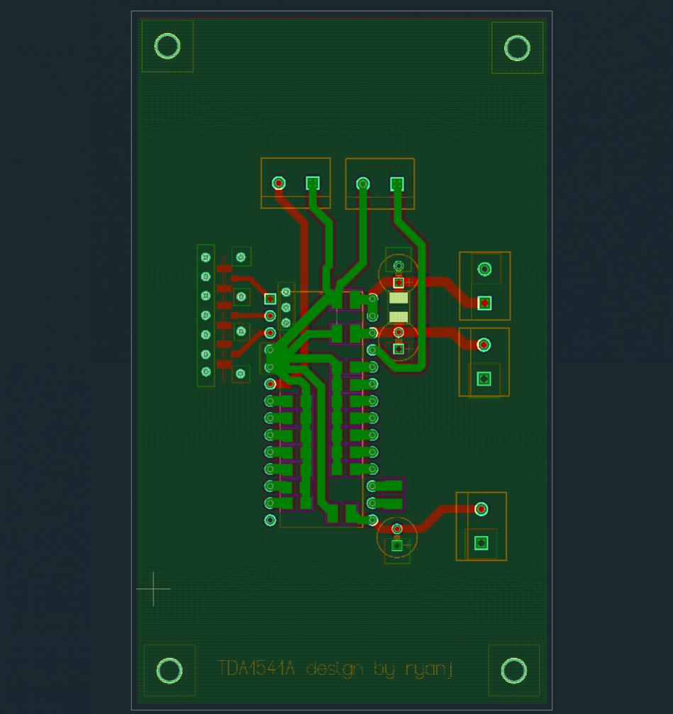

AudioLapDance, im not overly keen on putting regular pin headers for I2S inputs because it will compromise the signal itegrity and upset the U.FL configuration, which is by far the optimal way to keep the signal as close as possible to the ground return - an essential digital design parameter.
I could add a pin header for the analog output, I wonder if a U.FL connector would be good in this position? To keep as little impedance on the output up to a very high bandwidth? hmmm.
Sounds good. Well it's good to go for now! So how about you set up the gerber files as outlined in post 904 and we'll order up some PCBs through one of those shops!

ryanj, digital is 90% fine, as best as it could be. Just don't add another pads for thru-hole pin header. They will ruin all the effort made with u.fl.
1. Add another u.fl for 4th "unused" tda's pin - so you could connect it for simultaneous input, optional and won't harm.
2. Calculate the trace impedance - use "coplanar wave" mode, find the track width and track-gnd spacing suitable to get trace equal to u.fl impedance. I've assumed u.fl are 50ohm.
Saturn PCB Design - PCB Via Current | PCB Trace Width | Differential Pair Calculator | PCB Impedance
for 1.64mm PCB and 8mil track-gnd spacing i get 50mil track width. Tad too much.
Would be great if you'll go 1.2mm PCB thinckness in production. They are the same $$ (at least at chinese proto vendors i'm aware of), and provide lower track and via impedances.
40mil for 1.2mm PCB and 7mil spacing.
3. You might leave "mode selector" floating, so the end user will connect it to +5, -5, gnd based on required TDA's digital input mode in particular configuration.
If you doesn't leave it floating, then you can disregard the "1.". Most users will need the regular I2S only.

Yes, please allow for the possibility of simultaneous mode. Then this could perhaps be "the" board for folks who have Ian's stuff and want to try the 1541A at its best.
