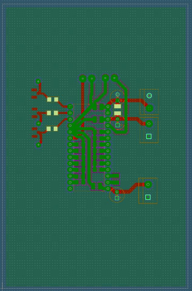

Its seems we've moved on a bit, but for those interested in my basic design - before I convert the file to a Gerber, any requests for slight modifications?
Add a regular pin header on the I2S?
any digital leads crossing analog leads or ps leads ? (if so and just a 2 side pcb with contigous plane : a simple hole to solder a wire to go to 3D design or staking are sometimes better... DIY it is : Mr T. advise !)

Im using the CEN IV, which is a current conveyor with passive IV conversion, there is a thread about it:
http://www.diyaudio.com/forums/digital-source/195483-zen-cen-sen-evolution-minimalistic-iv-converter.html
The FIFO improves the quality by quite a big margin, but it has more to do with the quality of the clock - Crystek 957 is the one im using. But any other crystal with low phase noise is what you want to go for.
And also the I2S signals to the 1541 need the ground return as close as possible to the I2S lines, this is why U.FL conectors are the best choice for interconnection.
My understanding Between two chips I2S complete line (PCB + wire) shouldn't be longer than 10 cm... these length is often writed...as a maximum or I2S could ne worse than a SPIDF with hardware management (crystal). But I don't understand anything to RF...
If NOS design : no crystal on the core board so short I2S needed absolutly ? Am i correct ?
It's main for the clock line than the 2 others if no master clock or FIFO. As the TDA1541 is less sensible to jitter (abraxalito inputs) maybe 10 cm with UFL could match. the pcb just needs maybe : tda pin : then pcbs leads for serie resistor then UFL connector. And the shorter UFL wires... Of course contigous gnd between the leads, the chip & the UFL wires. The ones provided with the Ian FIFO but maybe the FIFO avoid such problems and allow bigger wires !
Ideal should be UFL + holes for DIY in a GSGSGSG arrangement for a flat wire (and not GSSS : no utilty= bad) , but sure UFL are more SOTA I surmise...
For -15, +5V, -5V , decoupling cap for both polymer (2.5 pitch) and smd (605 case) near the pins, at least the last one (smd) ?

In this configuration to my ears it sounds great but I cant guarantee that it will measure well as im certainly no electrical engineer. But the grounding layout is very similar to a lot of good well known designs (ecdesigns).
AudioLapDance, im not overly keen on putting regular pin headers for I2S inputs because it will compromise the signal itegrity and upset the U.FL configuration, which is by far the optimal way to keep the signal as close as possible to the ground return - an essential digital design parameter.
I could add a pin header for the analog output, I wonder if a U.FL connector would be good in this position? To keep as little impedance on the output up to a very high bandwidth? hmmm.
The way I'm using pin headers is each signal is backed by GND and about 1 cm (CS8412) or 2 cm (USB to I2S) from the chip producing the I2S to the pin header. Then 1 cm through the connected header/footer and then ... what 2 cm on your PCB to the 1541 ... Toight!

Hi CFT,
Would Pedja be open to providing just the tda1541 section as found on AYA2,3 including only;
WS, BCK, Both DATA L & R inputs to the chip via uFL (and also GSGSGSGSG if possible).
Provision to connect (trace with solder pad)DATA L/R, and same for pin 27 to 26 or ground (user can select I2S or PCM operation)
The three power supplies for the 1541A including SMD bypasses
Thru hole at 16, 17 (use cap or connect own DEM cct)
SMD decoupling caps as per.
Thru hole for analog outputs direct from chip.

Hi RynaJ,
What news ? Did you ask some helps to Marce fellow to show him your layout (your picture) and had hints ?
Do we can use jumpers with wire and through holes to avoid bad crossing leads if not 4 layers pcbs ? (T. Loesch adive about making 3D pcbs when DIY: look is not importanty but the result for the diyer !)
I'm sure he is able to give few very usefull and see in a look problems who need to be avoid on your pcbs : lookt at the good hints he gave on the AD1862 thread.
