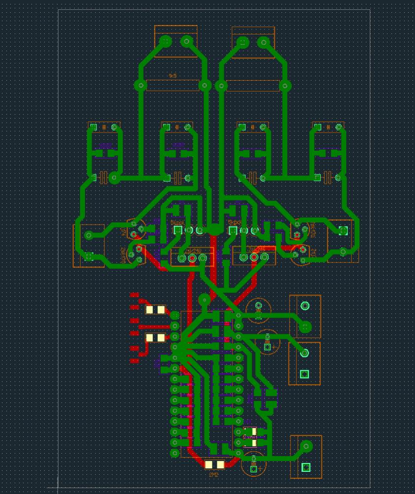

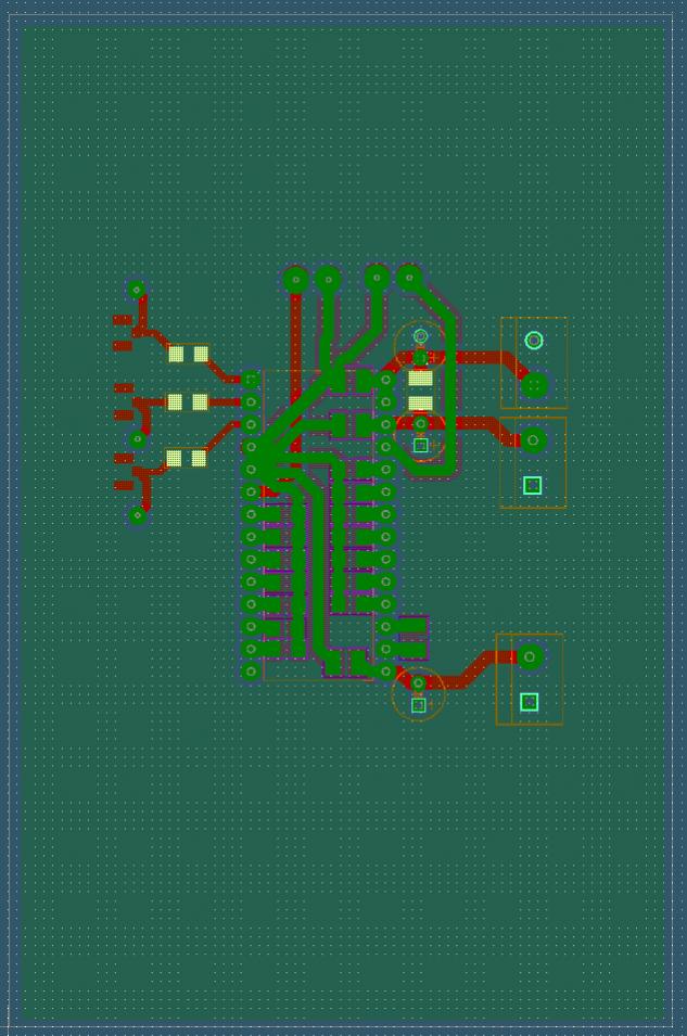

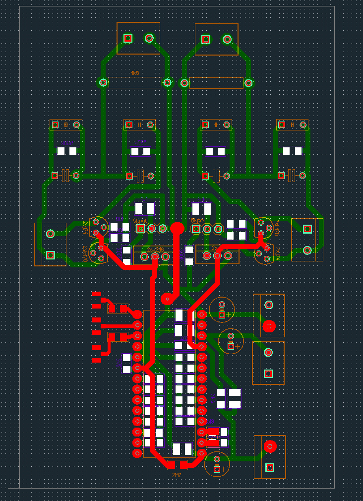

Not off topic at all! This thread is about 1541 kits or PCBs and you're got a fine one-- very well done PS decoupling and DEM decoupling.
What file/drawing do you have for it? Could we convert it to a gerber or something and get some PCB made? And you've been using it for 2 years so we know it works!

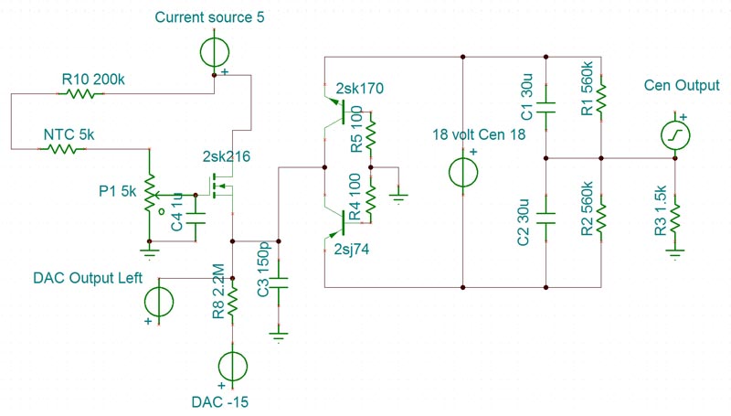

🙂Thanks for the kind words.
The program i've been using is TINA. Converting them to gerber shouldn't be a problem but im not sure where that particular design is on my computer, ill have to dig for it.
Another design i've been working on also in TINA has the CEN IV and 2ma current injection built into the same board, ill attach the layout to see what people think. Bare in mind that i've designed it in a way that makes it easier to drill holes by hand, so the vias are covered - but i guess that can be easily changed if need be.

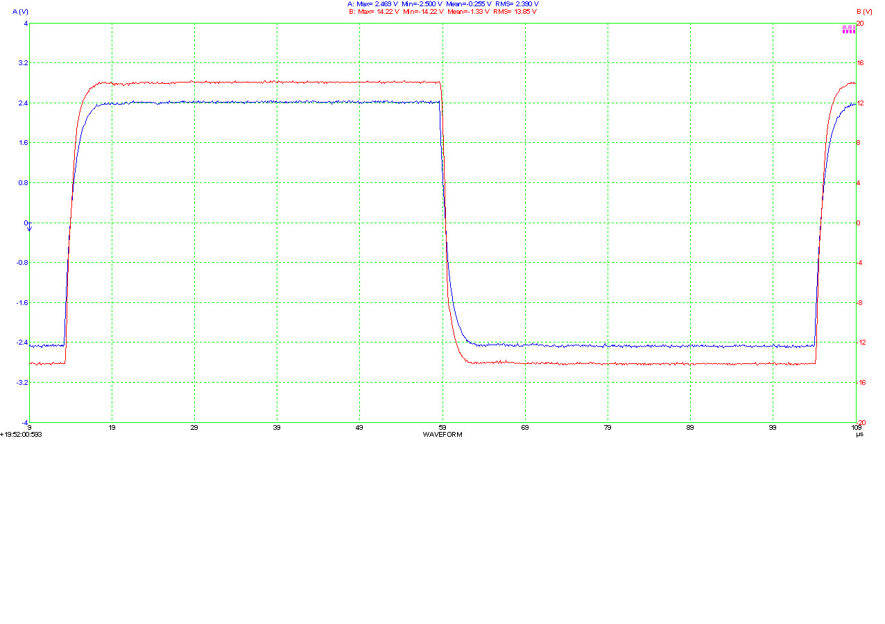

Ill also attach a measurement of the CEN outputting a 10k square wave in my current setup. The Red is out of an F5, the blue is the CEN.

Hi Ryan,
Can you tell me more about the I/V that your using
& does the Fifo really improve the sound over I2S
connection ? I too have a QLS 550 & would like
to incorporate the dac into a single box wave player
