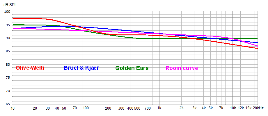

I do not have found speakers and DIY speaker kits that follow this kind a "Harman Kardon" curve something like in the following picture. Where lower frequencies are little bit boosted. I love when I also can enjoy sound without needing a separate subwoofer for lower frequencies.
Picture from this site.
