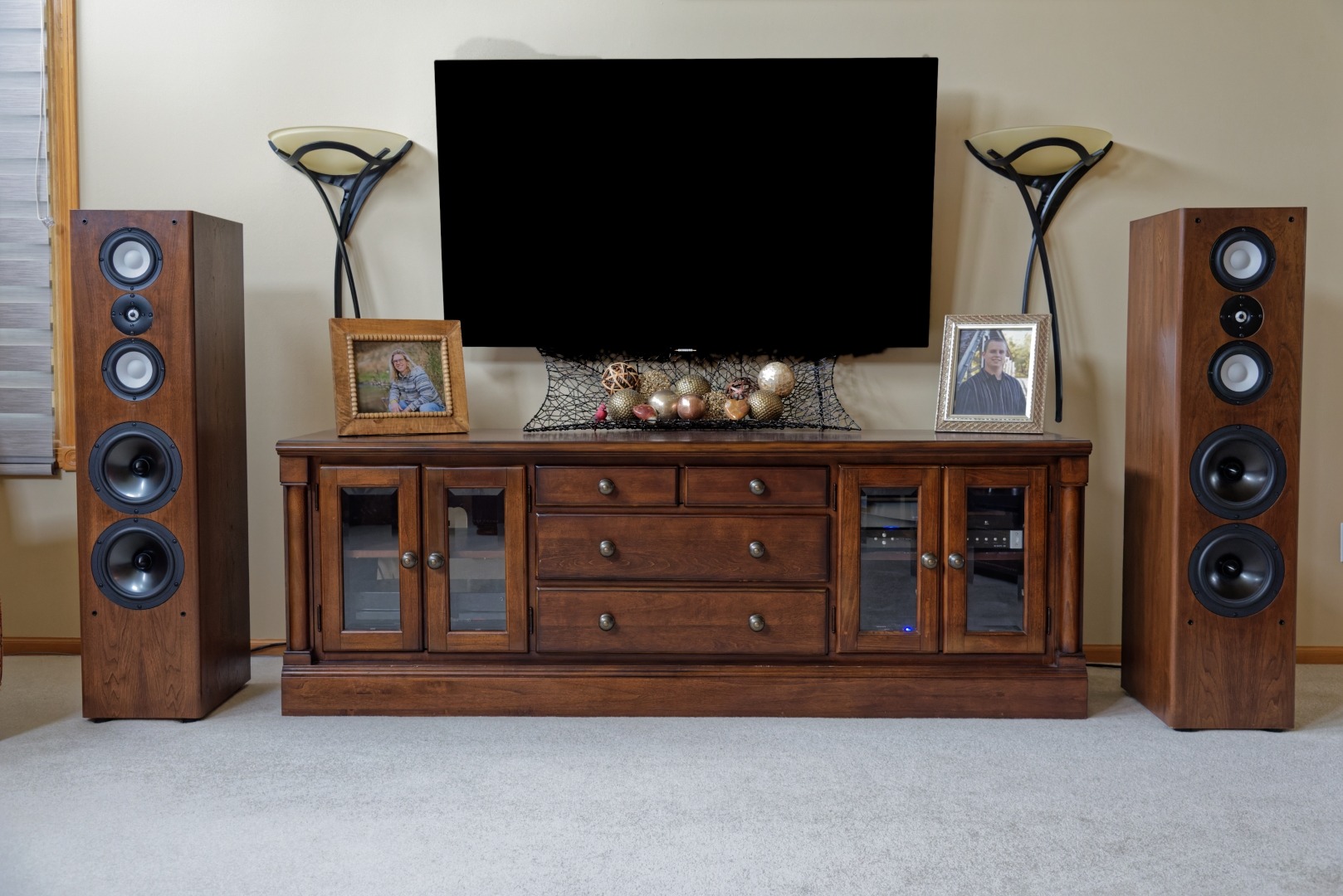

I am thinking of building a 3 way speaker. Anthology II got my attention. Could someone please explain me the differences between different speaker replacement comparing Anthology II MTMWW vs Statement II WMTMW? For me placing speakers like in Statement II would be more logical. Any thoughts about that?

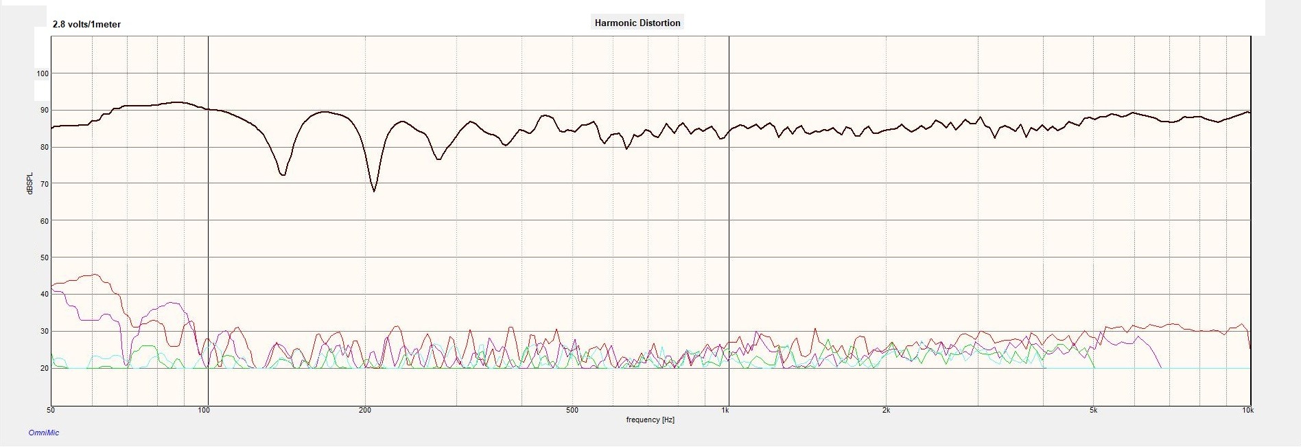

I do not have found speakers and DIY speaker kits that follow this kind a "Harman Kardon" curve something like in the following picture. Where lower frequencies are little bit boosted. I love when I also can enjoy sound without needing a separate subwoofer for lower frequencies.
Picture from this site.

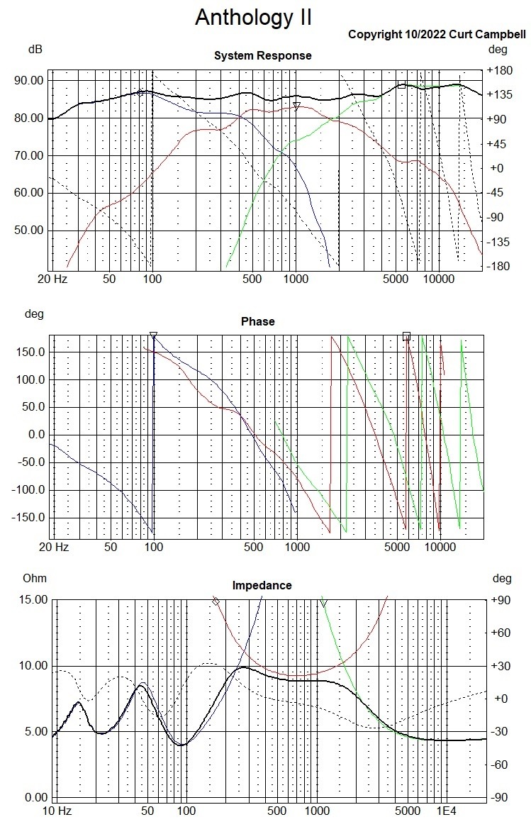

- Anthology II
