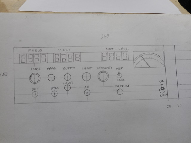

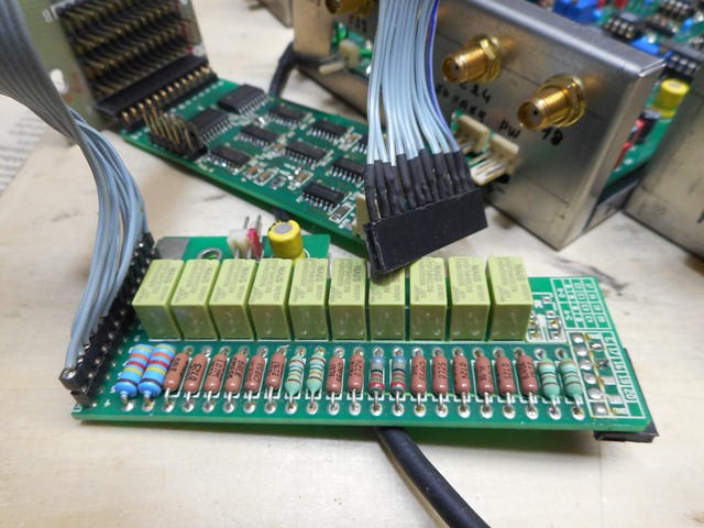

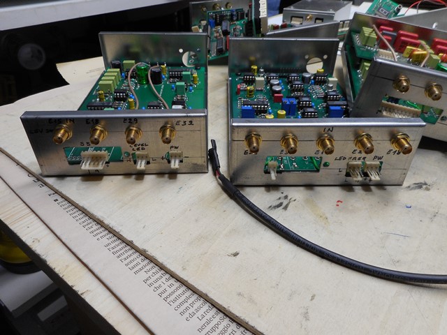

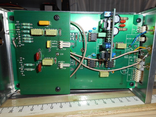

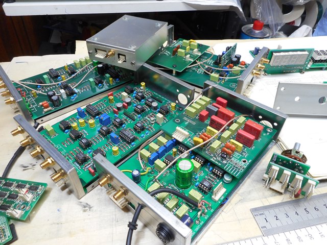

Hi guys,
unfortunately the life commitments did not allow me to terminate the analyzer.
Many other things have been done:true RMS digital voltmeter (with AD636), digital frequency meter and potentiometer gang stepper relays.
My heart cries, I can not finish this stupendous project.
Almost all stages are already calibrated and boxed shielded.
(I will send some pictures).
Cordially and Best regards

This looks like a beautiful piece of work. I hope you will soon get an opportunity to finish it. When you do, let us know and show us more pictures and tell us how it performs!
Bob
Pictures
WOW, nice work.
I'd say get it working leaving out features that will save you the most time.
Or get the oscillator working first.

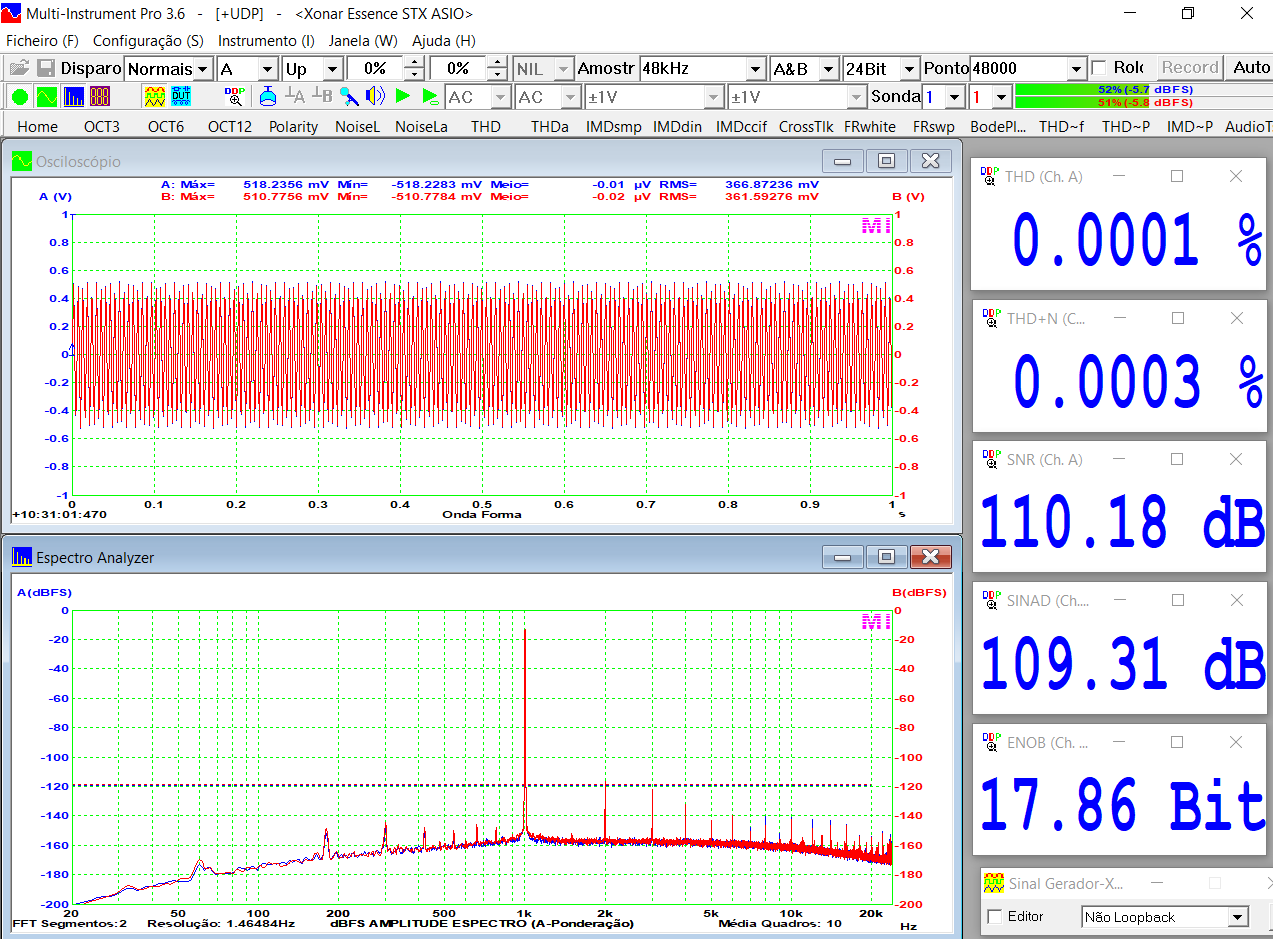

Hi Bob,
I have the QA401 and a solution using Asus Essence STX with an input attenuator.
Now i´ll try the EVGA NU in order to work with 384kHz sampling rates.
I like QA. is very good, but a good software like Virtins, a good audio card and something like the Jan´s audio front end is, IMHO, far better.
Look at this screenshoot the loopback of Asus with LME49990 at the line output.
Actually the problem with this cards is the lack of better QC (in my card, the right channel is 10 times worse in THD than the left channel - .001% versus .0001% - .001% is excellent for audio reproduction, but not so good for audio measurements).
