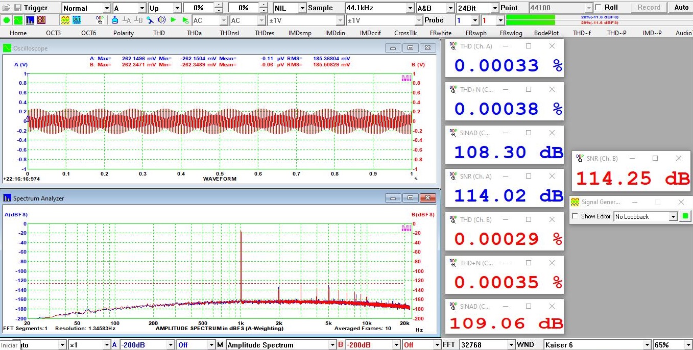

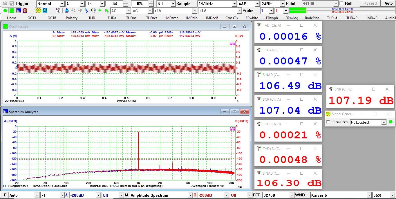

Still I mean even the Asus loopback. I have never seen such noise figure for a soundcard, let alone an internal one.
Phofman,
Last week arrived here a NU Audio card by EVGA (180$ card). This card is newer than ASUS Essence STX and has an advantage: sampling rate higher (384kHz).
I replaced the "audiophile" amp pop ( at line output for an LME49990 x2 and the THD and SNR were improved a lot.
The ASIO driver is not working properly so, initially, I´m using ASIO4ALL.
Below are the loopback tests, one is the best THD spot and the other is the best SNR spot (different line levels).
The THD numbers are worse than the ASUS ones, but SNR is better and the card is unshielded in a PCI-e extender over the bench. When I shield it, the numbers would be better.
