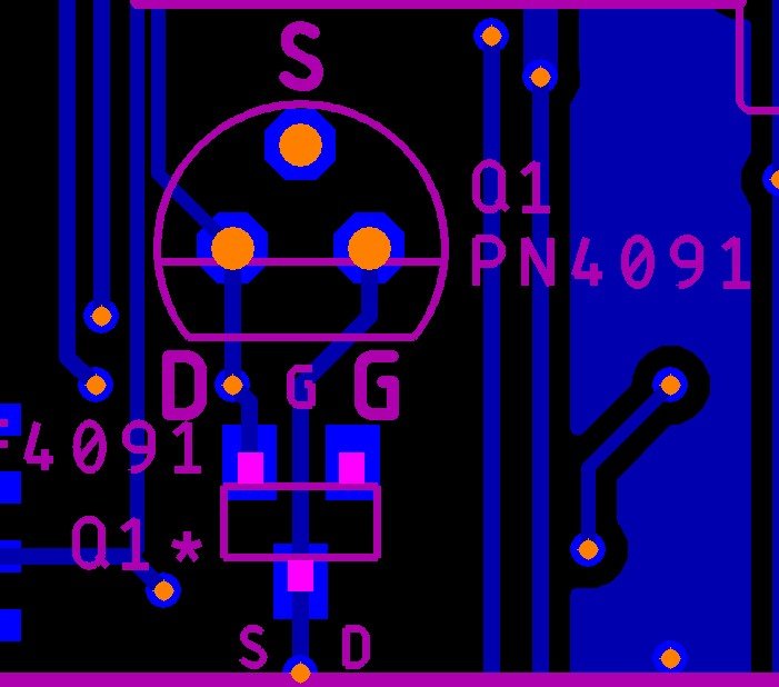

I had indeed set DRC to 6 mils and JLCPCB didn't have any problems creating it, quality of the boards produced was very good. The digital part is at the bottom and the analog part (Bob's) is located at the top. I needed to connect a number of signals (mostly the E signals) from the relay outputs to the analog parts, thus creating long traces with vias. Maybe that's part of the problem. Other than that, the digital and analog parts are separated as much as possible. Most signals are named in Eagle, so you can follow them through.
Okay, I've looked at the layout enough to provide a few comments.
Imo it's not advised to use parallel footprints, IC1 || IC12A, IC2||IC12B etc. layout for the NE5534A as was done originally (single), sub OPA1655 or other single packaged devices, as necessary. that will clean up the layout considerably. I would not use any leaded parts, mica caps etc, use MLCC NPO(COG) instead. leaded ecaps are fine to use.
You have a no connection to Q1* (SOT-23) source, sch shows it in || with Q1, source is not connected to ground, a DRC error in the copper pour, oops
Thanks very much for your comments! I will definitely remove all the parallel components in a future revision. Interesting observation about the leaded parts, I think component choice is even more critical than I thought. I will update the BOM with MLCC NPO(COG) components!
The Q1*-source is connected via GND, I checked the gerber file myself and it seems fine. Also, the board itself shows a connection, so no worries here. Thanks again for helping!

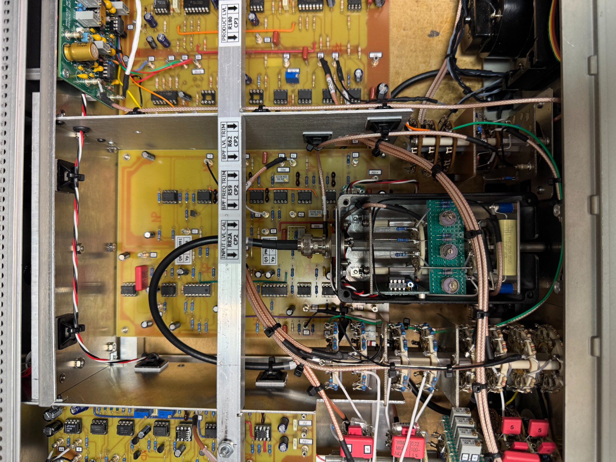

I will check mine when this weekend, but I think I also tweaked the values of the series resistors on the 200K band. I used polystyrene capacitors for the 200K band. I used WIMA film caps for the others. My build uses the rotary switches like the original design. I was able to find lots of Centra lab parts between eBay and ham fests, and I have quite a stockpile now of switch parts. I used quite a smattering of different op-amps in the oscillator (LT1468s, OPA604, LM4562) as well as 5534/318 in some positions. My bench includes a most exellent HP3585B which between it and a tuneable notch filter have allowed me to make very low harmonic measurements.
Measuring its own distortion, my CDA measures 2K/3Vrms at 0.0003% (-110dB) and 200K/1Vrms at ~0.0063% (-84dB). These are rms values as I've emplemented true RMS measurement using the AD536. The 2Khz value is limited by the CDA's null as the fundamental level is higher than the harmonics.
One problem I've noticed is that at the extreme high end (200Khz), the instrument is only stable at the nominal 0dB input level. If i try to measure 200Khz 3V on the 3V range (which the instrument should be capable of due to the auto-set level) my instrument becomes unstable. I can measure it fine however if I range up to the 10V range (which puts the input level back at the 0dB level). This problem does not occur on the lower bands even as high as 160Khz. I'd be interested to know if anyone has experienced this. I've also included a photo (partial) of my build for information.
VERY nice implementation in that great picture. Much cleaner than mine! I like the shielding of compartments. I'm impressed that you were able to find all of the parts for making those big rotary switches. Quite a few years ago I also upgraded mine, also using the AD536.

I look forward to what you find out. I've made some changes to the oscillator based on readings from this forum and the works of the late Dick Moore on his archive site Tronola. Most significant of which is the 2nd harmonic trim around the level control FET. I'm in the process of putting together a file of my build which includes a lot of photos and details of the modifications and changes I implemented. Once it's finished, I would be happy to post it hear for those who might be interested.
