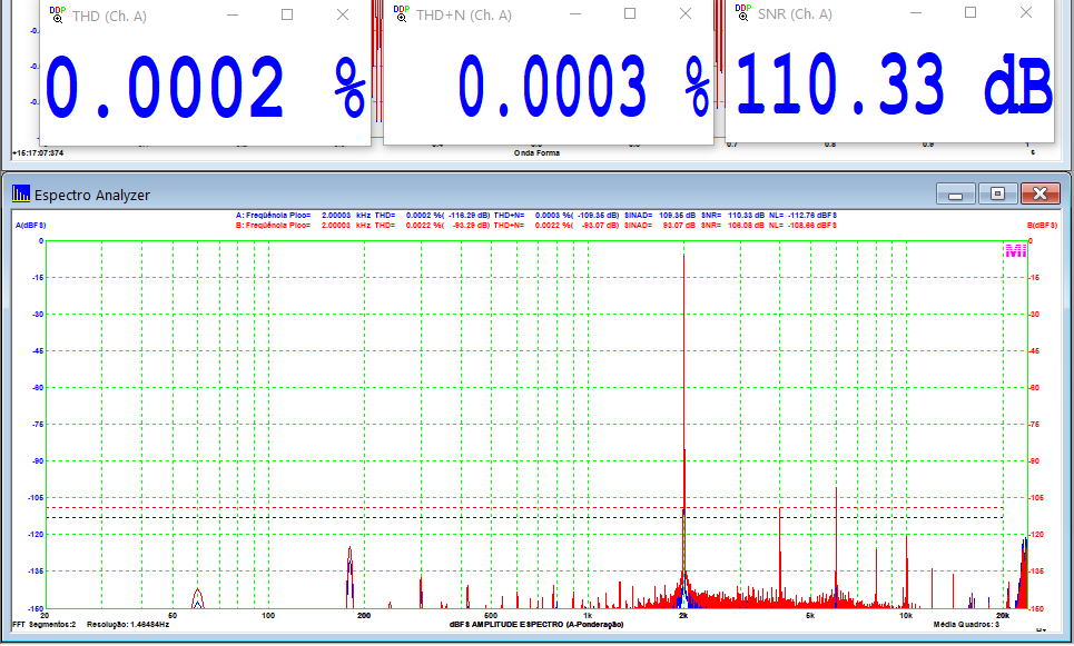

The image below is the THD measurement of an active crossover I designed last year. You can see the diference in THD and SNR between the channels, caused by the problem in the Asus line out.
QA401 can´t reach this measurement´s level, but, imho, is a very good "everything in a box" solution. I´m using its hardware with Virtins (ASIO) and the integration is very good. The residual THD is very good. The SNR is a little bit high for me.

blmn: You spectra are truly impressive for an internal PCI-e soundcard + the LME buffer. 60Hz mains at -170dBFs, 0.0001%THD, 0.0003% THD+N. Also the spectra for your xover output - 60Hz at almost -160dB.
Yep.
The measurements were made at 2kHz because the crossover cutoff frequency was around 900Hz. Since it is a high
-pass side, the rejection of the power supply artifacts is not so impressive.
I´ll try to find a low-pass figure.
I was very careful with the power supply and used the LME49720 throughout the circuit.
At this noise level, the difference in the placement of grounding points is impressive. Moving a few inches makes a lot of difference.
Still I mean even the Asus loopback. I have never seen such noise figure for a soundcard, let alone an internal one.
Neither do I until I used this card.. I repeated this loopback measurements many times and the results were the same. Im using a very short cable connecting the Line IN with the line OUT.
Now the sound card is disassembled because I´ll try to replace the PCM1792 in order to solve the diference of THD problem.
I´m thinking on use a PCI extender and a isolated power supply in order to achieve better noise ratios also. Placing the card far from the PC and near the attenuator pots can improve it.
