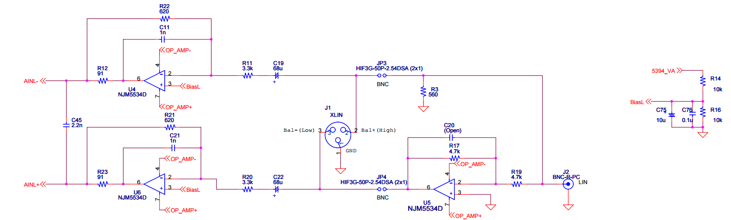

Its not really too difficult to drive an ADC directly for test purposes but you do need to deal with the differential drive and the DC offset issues. the DC offset needs optimization since it relates to some idle tones if not optimized.

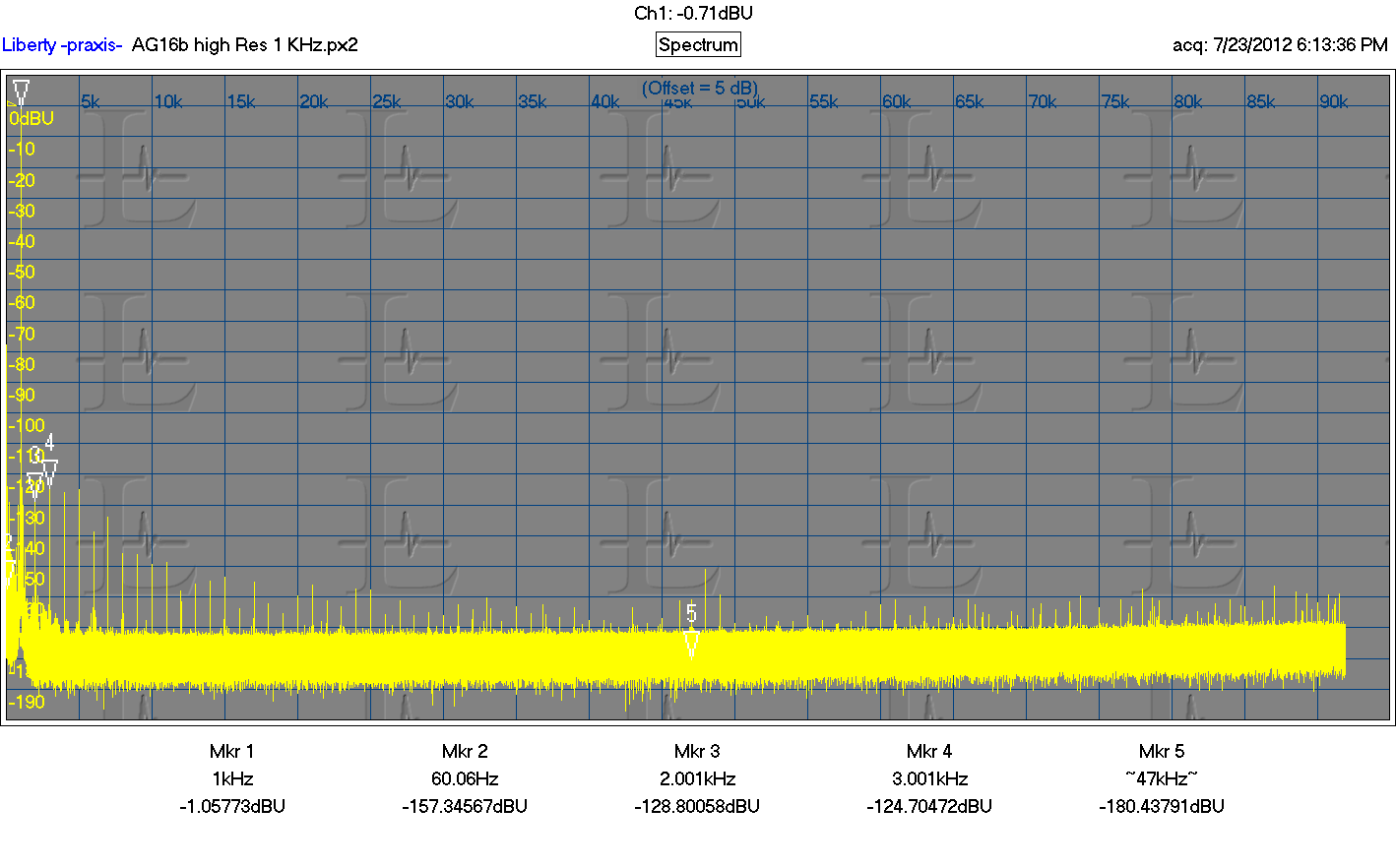

Below is the demo board input circuit. Also measured performance using the Demo board and a Shibasoku AG16 oscillator (some time ago). I think I can get better results today with better sources.

The problem is protecting the the ADC input from damage. The signal has to be balance, biased with a small dc offset between the inputs. Over voltage protection would probably mess up the linearity anyway. There are single ended ADC but then there is the common mode issue.
The exercise is to determine if the ADC is more linear under direct drive. That could be done once under controlled conditions. Next is to test it with a coherent frequency and see if that improves the low level accuracy. Or just use them the way there are.
That is what I am asking to know about. I think the input protection is do-able problem in several ways. Myself, I would add relay auto-ranging before the ADC. The auto-ranging defaults to highest atten and works itself downward. No distortion and protected. But cost a slight amount more. On the other hand, input fets for protection like AP uses dont seem to have any affect. DC biasing ADC isnt an issue with cap coupled input.

The input impedance of the ADC is pretty low and not very linear. Its not a good idea to expose it directly to the I/O interface. If you look at SG's measured results the I/O interface they use or one like the Shibasoku could get the necessary linearity with a low output impedance. Not easy. However there are a number of opamps that do have better linearity that even the best ADC's.

It would be nice to know what the distortion limit is of the ADC direct..... the limit for T&M with that adc device. Low gen output z isnt hard to come by. We will always wonder forever if we dont find out....... maybe asking ADC designers if we dont want to test for it ourselves. Could more easily do T&M on ultra low distortion gens etc. with direct measurement.

Demian, I had found same distortion on EMU1616m and shibasoku AG16A and 725C tied together and it seems due to EMU's input protection diode ,bidirectional zener input to GND.
