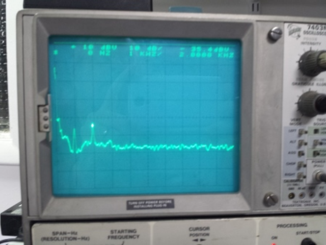

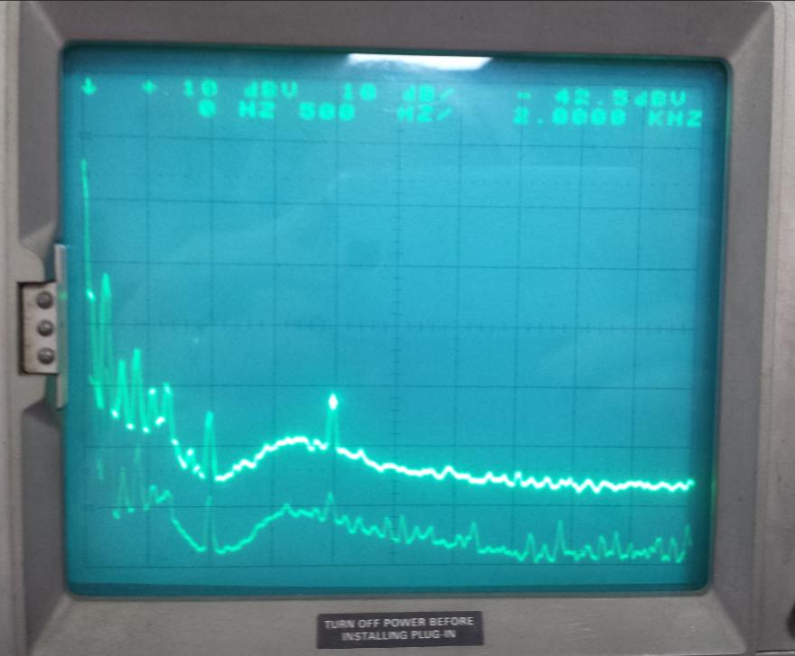

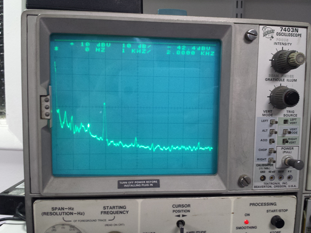

Distortion caused by soundcard input
Here are three plots-
First is the generator connected to the Shibasoku 725. Top line is -90 dB. Fundamental is 1 KHz. You can see some 2nd harmonic.
Second image is the same with the generator connected to an input on an EMU 1616M. The third is the same but connected to a 1212M in a PC Chassis.
The 1616M introduces significant 3rd harmonic. The 1212M brings harmonics and a bunch of noise from the grounds.
The 1616M is stock. The 1212M has the opamps upgraded to LME49720's. The generator source Z is 600 Ohms. A 50 Ohm source is less sensitive, but not free of the phenomenon. I'm going to get some OPA1642's based on the test results here-http://www.diyaudio.com/forums/vendors-bazaar/283672-new-audio-op-amp-opa1622-9.html#post4636374

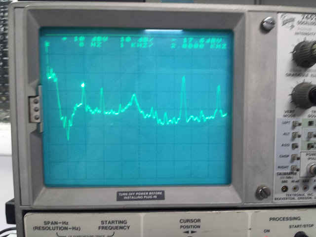

This is the input distortion caused by the input circuit of a Boonton 1120 distortion analyzer with LME49710 input buffer amps. It increases the 2nd harmonic from -138 to -132. In the real world that is inconsequential. But if you are building an SOTA distortion analyzer these are the things that limit your performance.
When I get some samples of the more linear input opamps I'll repeat the experiment and see if it helps.
