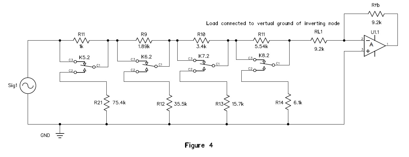

Yes but that means having to buffer the wiper with a non inverting amplifier. A inverting amplifier eliminates the common mode distortion problem but loads the wiper. So how do we win with this? There is a reason why you didn't use pots for tuning in your oscillator.
Yes, you are correct about the tradeoff between wiper loading and common mode distortion of a subsequent non-inverting stage. The latter, of course depends a lot on the op amp used. This is usually a bigger problem with JFET op amps. There are one or two places in my analyzer where non-inverting stages are used anyway, including the output amplifier of the oscillator. As far as I can tell, these non-inverting stages are not responsible for the distortion floor.
This tradeoff was not in my mind in using switched resistors instead of pots. I would have needed a 4-gang audio taper pot with great tracking to achieve my goal (I needed to have the oscillator and analyzer controlled by a single control and a simple linear control of frequency would be undesirable). Such a pot did not exist then, and can be hard to find today. But there are some decent such pots that might be adequate - for example some pots made for multi-channel audio systems. I would not rule out making an analyzer with a quad pot today. But I favor the use of relays.

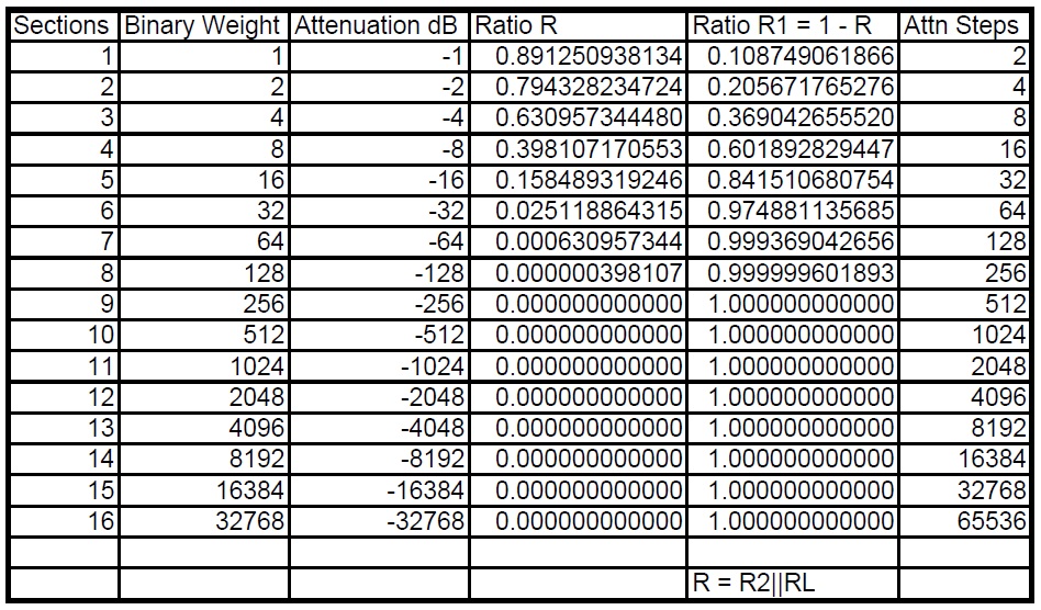

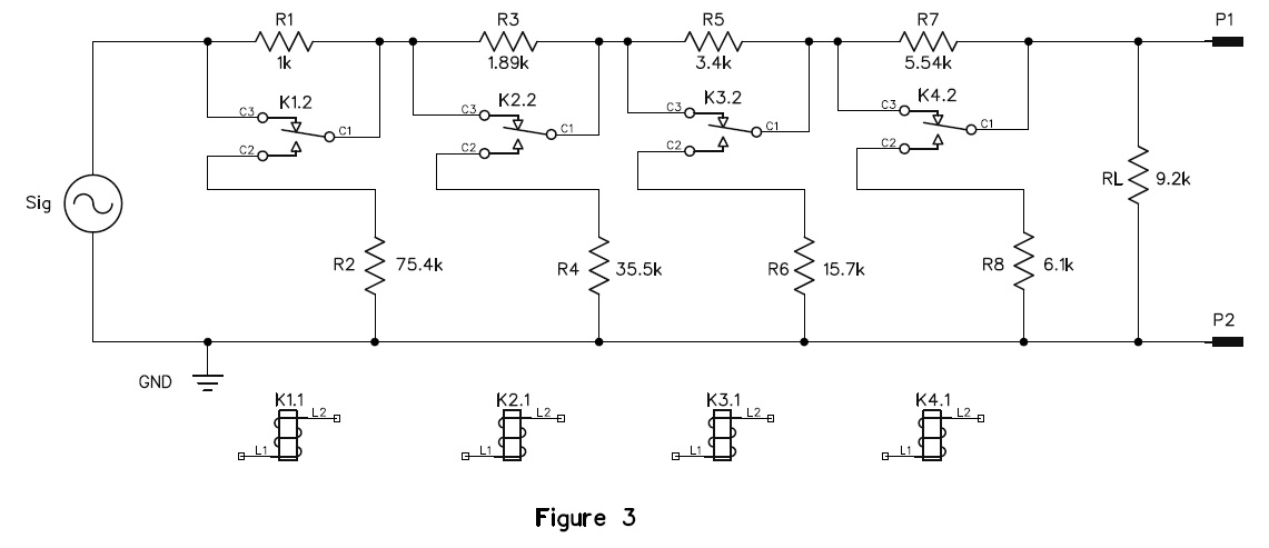

Binary weighted log attenuator
This is short tutorial on how to calculate the resistor values for a binary weighted logarithmic attenuator in decibels.
The first thing to do is to choose a section constant resistance. The section constant resistance is the same as the attenuator impedance, Z. The impedance can be any practical value, 50 Ὠ, 600Ὠ, 5kὨ etc. The attenuator network requires a terminating load equal to the attenuator impedance.
The next step is to decide on the number of steps and the step size. The number of steps is two raised to the number of attenuator sections, (2NumSec ), For a eight section attenuator 20, 21 , 22 , 23, 24, 25, 26, 27 ,. The number of steps is the sum of the binary weights, 1, 2, 4, 8, 16, 32, 64, 128, which sums to 255 steps. The step size can be any decibel value, -0.5dB, -1dB, -10dB, -20dB. Each attenuator section is weighted by step size multiplied by the binary weight.
In the following design example 9.2k Ὠ is chosen for a section constant, four sections, 15 steps and a step size -1dB. The attenuator has a constant input resistance and varying output resistance. Each section is calculated separately according to the weight -1dB, -2dB, -4dB and -8dB. Each subsequent section loads the section before it and the last output is loaded by RL.
First, calculate the attenuation factor for the section weight. The attenuation factor is found by taking the antilog (10x) for x = (-dB/20).
Section 1: -1dB: 10(-1/20) = 0.89125094

To calculate the resistances for our attenuator we also require factors for the difference from 0dB. 0dB is a factor of 1 (unity). Theory: The range of ~Attenuation~ lies between 0 and 1. Therefore, the sum of the two factors equals 1.
Section 1 -1dB: 1 - 0.89125094 = 0.1874906
Section 2 -2dB: 1 - 0.79432823 = 0.20567177
Section 3 -4dB: 1 - 0.63095734 = 0.36904266
Section 4 -8dB: 1 - 0.39810717 = 0.60189283

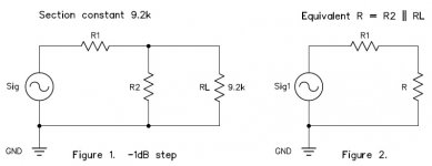

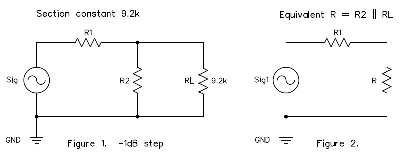

Figure 1 and figure 2 shows the voltage divider for section 1 which consists of R1, R2 and the load RL. To simplify the calculation let R = R1||RL. The values for R1 and R are calculated as follows
Section constant 9.2k Ὠ
R1 9.2k Ὠ * 0.1874906 = 1000.4914 1k Ὠ
R 9.2k Ὠ * 0.89125094 = 8199.5086 8.2 k Ὠ
R can also be found by, R = 9.2k Ὠ - 1k Ὠ = 8.2 k Ὠ
Now extract R2 from R. We will use the parallel formula for resistance. We know RL is 9.2k Ὠ, R = 8.2 k Ὠ and R1 is 1k Ὠ.
1/R = 1/R2 + 1/RL
1/8.2 k Ὠ = 1/R2 +1/9.2k Ὠ. Re arranging
1/8.2 k Ὠ - 1/9.2k Ὠ = 1/R2
R2 = 1/ (1/8.2 k Ὠ - 1/9.2k Ὠ)
R2 = 1/ 0.00001326 = 75.4k Ὠ
All other sections are calculated in the same way using the appropriate section factors.
Table 1 lists factors in 1dB steps and up to 16 sections. You can see from the table 1 that it’s not really practical to do more than eight sections. Figure 3 shows the complete four section switched attenuator. Larger step attenuators can be created by simply adding on more sections and repeating the calculations. An excel spread sheet is handy for generating attenuation factors and calculating the resistances for any number of sections and step sizes.
Sections of multiple attenuators can be cascade to make a combinational attenuator. For example a four section 1dB step attenuator can be cascade with a four section 10dB step attenuator. A binary weighted attenuator can be limited to 10 steps making a decade attenuator. The binary weighted attenuator is switched in a binary count fashion.

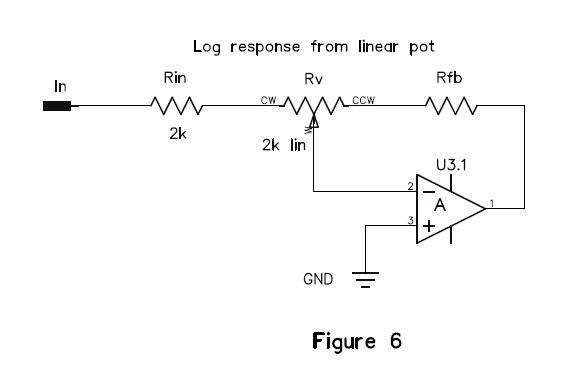

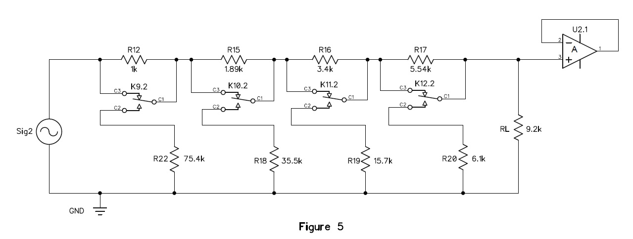

Figure 5 and 6 show how to interface the attenuator to an op amp. Figure 6 show a way of using a linear pot for a log response. A linear stepped attenuator can replace the pot..

Hi David,
I detected a small typo, better to correct that before publishing it in a famous magazine 🙂
Section 1 -1dB: 1 - 0.89125094 = 0.10874906
R1 9.2k Ὠ * 0.10874906 = 1000.4914 1k Ὠ
