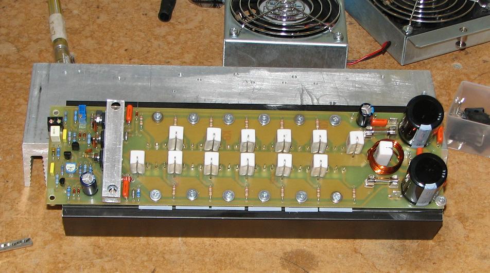

The little PCB is a voltage regulator board +-15 volts
to run the opamps, voltage translation stages and the cold amp first driver stage.
The the hot and cold sides of the output stage runs on a single supply rail of around 150 volts.
The heat sink is a Conrad MF35-151.5.
Its big enough for home use. But for Pro-audio use forced cooling would be a good idea.
The PCB is double sided PTH and I have used SMD components in the driver stages.
I have got a bit more work to do on the PCB to add more SMD devices and put the Filter caps on the PCB instead of handwired as you see them here.
Dan's amp
A piccie of Dan's (danieljw) amp. Bought it with him for a brief visit today. Very nice neat work. PCB is mounted on the black tunnel heatsink. This one gets the Quasi "seal of approval".
Nice powerful amp this one.
Cheers
Q

whoops anthony, my email took me to the last unread post...
150V rail, = power 🙂
Thanks for the extra fet the one i sacrificed in haste was the only one i popped (phew)
the second channel is now up and running 😀
now i just have to finish the case and i am ready to :smash: some speakers.
Thanks Quasi!!!
-Dan

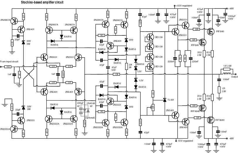

Hi Anthony,
This is the schematic that Dan has used. http://www.diyaudio.com/forums/attachment.php?s=&postid=991050&stamp=1156601436
As you can see the thermal compensation approach is quite different. In this circuit, thermal compensation is achieved by varying the second stage constant current source. As T4 (mounted in the heatsink) heats up its Vce drops robbing base drive from T5 and this backs off the current in the second stage. The FET Vgs drops and the bias falls away. Simple and effective enough, but not as constant as the normal Vbe (Vgs) arrangement.
I too have placed the heat sensing device directly on the FET before, but with this layout with the FETs under the PCB, it's not possible.
Please take the time to have a look. I would value suggestions you have to improve the situation.
Cheers
Quasi

Hi Dan and Quasi
Thanks Dan I will endevour to improve all the time.
Quasi your biasing arrangemnt is over compensating.
The first area I would try is to drop the value of your source resistors down to 0.22 Ohms.
Before you do that you might want to replace D5 with a 1n400x
The junction on the 1n4148 is likely to drift more with ambient temp. also I would try putting an extra diode in series with D5 and T4. This should I think reduce the over compensation issue.
Give it a try anyway and keep me informed.
Also Dan where is that schematic you mentioned, I wouldn't mind having a look at it.
Hi Anthony,
It took me a long time to find the schematic,
It is actually a string of BD139 not MJE340 my apologies.
any how here is the schematic of what i was talking about hope it is useful in some way.
-Dan
