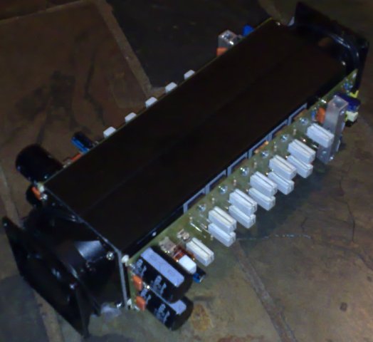

ACTRK600 getting closer...
Hi all,
my ACTRK600 build is getting close to power up time....
currently i am just wiring up the power supply
***I HATE REMOVING THE ENAMEL FROM TRANSFORMER WINDINGS!!!!!!!!!!!!!!!!!!!!!!!!!***😡 😡 😡
Any how here are some pics........... 😀 😀 😀
Hi all,

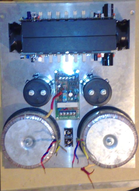

Mr Quasi,
Will 12 DC regulated be ok for the additional low current VAS supply ?
any hints on biasing ????
- Dan🙂
- Dan🙂
two transformers, two rectifiers and two smoothing capacitors.
How are you connecting these?
post 354 confirms ONLY two smoothing caps!
The extra rail is better done as an AC supply totem poled off the AC from the main transformer. Then rectify that high AC voltage and finally regulate it to [+Vrail + 9Vdc]. Yes, a high voltage regulator.
If you regulate to 9Vdc and then totem pole it on top of the modulated main Vrail supply, the "stiff" supply to the front end gets modulated with the output signal. I don't think that would help improve the sound quality.
Another alternative,
totem pole the 9Vac on the 50Vac. Rectify to 83Vdc. Then RC filter it, or even RCRC, to give the required unregulated DC voltage for the front end. The RC or RCRC will filter out much of the modulation coming from the main transformer winding. Watch the voltage on those little RCRC capacitors.
AndrewT said:two transformers, two rectifiers and two smoothings capacitors.
Good point, I assumed the other 2 caps are not in the shot. 😀
BTW: I very nice build.

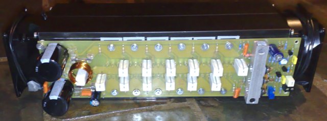

Nice Work Dan
Very nice work Dan,
In your case the first and second stages need about +105 volts and this should be referenced to Gnd. The easiest way to get this is by winding extra turns on your transformer secondary and half wave rectifying and smoothing as shown in the power supply schematic on my web site. Alternatively, to just prove the amp is working you can connect this stage to the main positive rail and sort it out later.
When you first set up for biasing, replace the two fuses with 100 ohm resistors. Then turn the biasing control so that you have maximum resistance between the positive rail and the emitter of T5.
Place a voltmeter across the 100 ohm resistor on the positive rail, switch on and adjust the trimpot until you see a voltage (about 1 volt) across it. Wait and watch the reading for a few minutes, it should continue to rise slowly. Once it seems to have settled adjust again to 3 or 4 volts. This will have set about 40 milliamps through the output stage. Pause here and connect a CRO to make sure the amp is working with a small signal. Do not consider the voltage across the 100 ohm resistor on the negative rail as bias current indication.
All being well switch off and remove the 100 watt 5 watt resistors and place a 1 amp fuse (not a 10 amp) in the negative rail fuse holder and a 10 ohm 5 watt resistor in the positive rail fuse holder. Back off the adjusting trimpot a bit before you turn on again.
Switch on and adjust the trimpot slowly, pausing and waiting to allow the amp to settle until you get about 1.8 volts across the 10 ohm resistor. This has set the output stage bias current to 180mA.
When this is done center the output using VR1, and do a final check on the bias. When you're happy, remove the 1 amp fuse and the 10 ohm resistor and replace both with 10 amp fuses.
This is a bit more tedious than most amps, but it's a characteristic of the simple design.
If you want, we can make a time to do it together.
Cheers

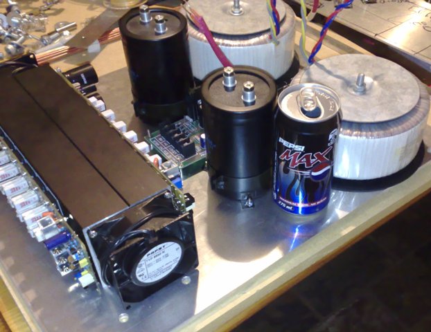

Hi Andrew, Hi Greg,
thanks for the comments,
- each 1kVA transformer (65-0-65Vac secondary) has a bridge rectifier, bridge rectifier outputs will be parallel prior to the caps.
fairly standard supply, I would prefer a single 2kVA (or larger) toroid but i have these from another project.
- I am going to regulate the low current supply using a LM7812 or LM7810 (hoping to get away with LM7812
- I dont think the modulation will be a big issue, the amp PSRR will be the defining factor (correct me if i am off base here)
- I know only two filter caps !!!!!!!!! sacrelidge!!!
didnt you see the pepsi max can ? 😀
what i mean is they have enough ripple capacity 🙂
-Andrew I completely agree with your comments on RCRC filtering I will add it if necessary. 🙂
wish i had a bit more time to fire it all up this weekend !!!
-Dan

Intersting bias procedure Quasi,
I will let you know how i go!!!!!
I was still typing my post when yours arrived!!!!!
- to be honest i am doing about ten things at once 🙂
Ok, after reading that i guess the LM7810 or LM7812 supply floating on the +ve rail is out!!!!
I will have to start winding....
on this note does any one have a "trick" for removing enamel
from ENCu wires chemically ?
-Dan

You can reference to positive rail if you wish, and I've done so in the past. At high power though the ripple will be quite large and this is why I changed it to a gnd reference.
Good luck in the setup. By the way if you parrallel the bridges they may not share the current equally.
For removing enamel, I've used a tiny blowtorch in the past to burn it off and then I just clean up the copper.
Cheers
Q
Cheers
Q

Hi D,
the two toroids are probably bifilar wound.
1.) It would be better to parallel the two secondary windings in a transformer than to parallel the two transformers.
2.) If you want to rectify before paralleling then you will need 4 rectifiers.
3.) If you rectify after paralleling you only need 1 rectifier.
However, if you decide to totem pole the AC from the LV winding to the main AC winding you need to keep the AC voltage ends separate from the ground. This forces one to adopt the dual rectifier solution and create the zero volt point after the rectifiers. This then becomes the add-on to option 2.) above.
I see three options. You choose.
