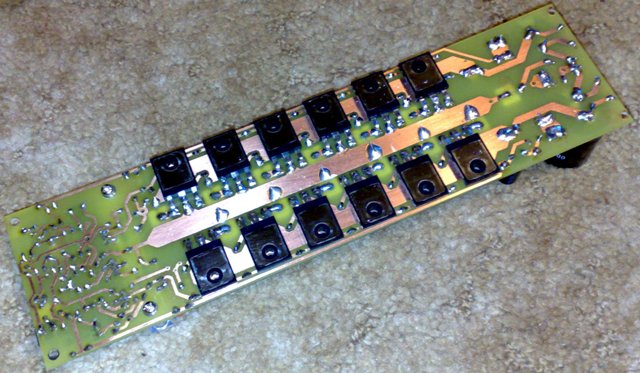

do you have any method of how to calculate the max amount of mosfets you can drive from a given VAS ?
I was planning to add more mosfets or higher SOA mosfets to the output stage of the ACTRK600
I was under the impression it was an equation based on Q=1/2CV^2
basically i want find out how many pairs of MOSFETS you can drive of this VAS. or perhaps how to increase the number.
I really like alot of elements in this design for example quasi complimentary design easy to source parts neat / compact discrete driver stage and i was hoping to tweak it for some higher power use.
-Dan

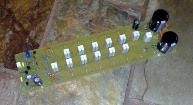

ACTRK600 in progress.......
anyone else building anything similar ????

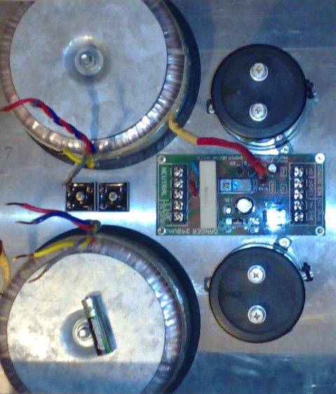

ACTRK600 supply
2kVA worth of supply:
- 2 x 33,000uF high current caps
- 2 x 1kVA 65-0-65 Vac toroid transformers
- 2 x 35Amp high surge bridge rectifiers
- 1 x power supply "soft start" (Ampslab type)
should be enough for two ACTRK600 boards🙂
note the AA battery for size.
-Cant wait to power it up!

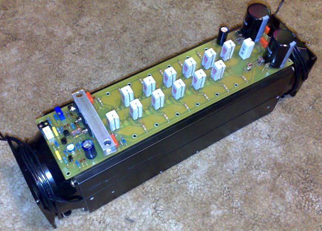

ACTRK600 cooling tunnel....
the cooling tunnel i plan to use for the ACTRK600
with 90% completed board on top - one board of two...
two 80mm ball bearing fans attached. i will set them to low speed for normal use and high speed for +60 deg C.
once again - cant wait to power it up!!!!!!

cheers mate,
yes, i held them flush to the board with some M3 nuts/bolts
there is no movemet/offset (checked the tips in the NMOS350 guide)
- is the bias setup similar to the NMOS 350 guide ?
- yeah fork lift would be handy for this one!
Thanks Con, will let you know when its time to see if they make music or smoke.
Andrew, both fans push air in the same direction air enters the sink tunnel at one end and exits the other. i dont really need both to be honest but they hold the two piece heat sink together
