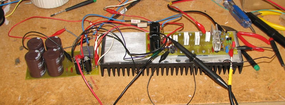

It works !!!!
Stone the crows.....the thing works !!!
I found a board error and some fine tuning is required. But hey it works !! 😀 😎
Cheers

AndrewT said:
Hi Quasi,
that must be some fix if it took all those wires to cure a board error! 😱 😀
Ha !
It does look a mess, but the mess is 3 x AC into the power supply, 3 x DC feeds plus ground into the amp. Two voltmeters are connected plus a CRO and an input signal lead. The 2 x 5 watt resistors are there for protection (JIC). The board fault can be spotted by the now green legged transistors that had to be twisted a bit. 😱 oh well....
Cheers
Q
