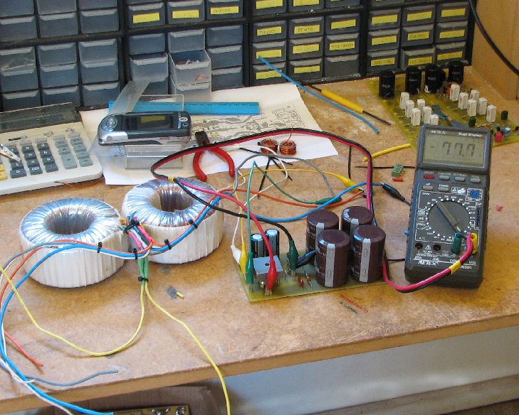

quasi said:
Today I fired up one of the 2 power suplies.
DC voltages are +90v +77v 0v -77

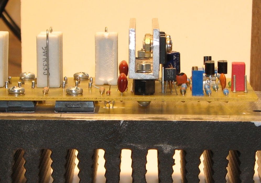

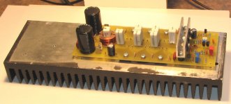

Workhorse said:Hi Quasi,
Where is your latest schematic, which is currently upgraded.....?

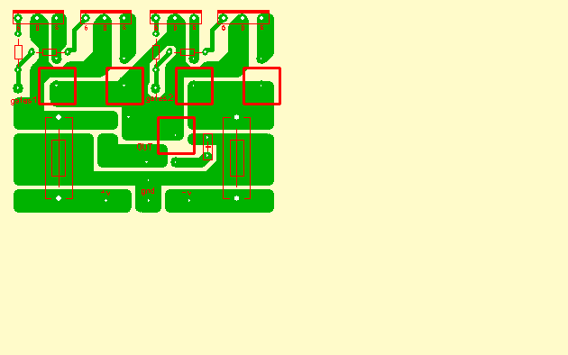

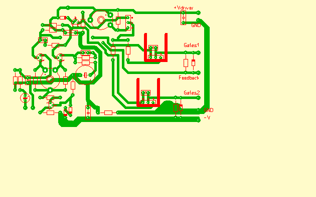

Help
hi everybody
i've tryed to build this amp for 3 times but i've always the same problem:
the sound appears terrible... lookyng into an oscilloscope i've seen that only the positive wave comes to the speaker...
the two positive rail mosfets gets cold and the negative fets remains more cool.
i don't think that there is a connection error because all the 3 prototype has the same problem.
i used the attacched schematic
but i used for input pair the 2sc2240, and for drivers(MJE350) THE 2sa1156 and a power supply of 56+56v but i 've tryed also with +10v rail for drivers...
in the power on instant, the problem seems to disappear and the positive waves is present, but only for a moment
please help me!!!!!
hi everybody
please help me!!!!!
The first thing I would check is the voltage across R16 & R19. When the amp is first setup there should be about 3.5 - 4 volts across these and the voltage should be the same.
Is anything blowing up? Are the FET's ok? Are the fuses ok?
Do you have a copy of the PCB layout you used?
