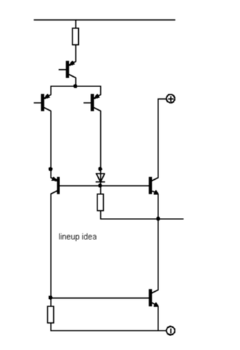

Take a look at the attachment.....
You look like a ..........younger TOM CRUISE in his Teens.......

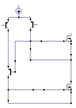

Hi Quasi,quasi said:
Sorry man I still don't get it. The negative rail FETs are driven by a constant current source T5 through T6 (half of the 2nd LTP). As T6's base swings negative T6 turns on harder swinging more current through R16. All T7 does is track the output swing setting its emitter 0.6 volts above that.
Can you describe your view in terms of voltages and current flows, so that I can follow you.

I also would not like to have T8 base connected to output.
Even when using a bipolar output.
Simply want to keep VAS stage transistors separate from output.
This is also shown in my earlier 'lineup-idea' attachment.
The diode shown in my attachment is not really needed.
I agree with Workhorse,
that T8 should have base connected to T7 collector (gate of upper MOSFET).
Hi Quasi,
This configuration facilitates the Negative Rail Mosfets to Saturate efficiently when delivering near rail swings......As the output swings to the negative rails the base of cascode transistor also swiings to negative rails, but if it is connected to some higher elevation potential then it never saturates it self prematurely....that why I prefer it to connect it to gate drive collector terminal not at the output..

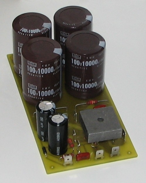

I like your PSU board. I have considered using block bridges like that, but the holes has always put me off - them needing to be a slot. How do you make such slots efficiently?
Umm....I don't.
I loop some thick tinned wire through the hole in the spade terminal and solder, then thread both ends through a round hole in the PCB and solder.
The bridge spade terminals sit on top of the PCB.
