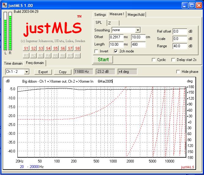

More measurements
A while back, somebody (Graeme?) asked me what the transformer response looked like. Today I measured it by connecting to the secondary of the transformer instead of the usual mike input, and keeping the JustMLS "probe" on the primary of the transformer. Then I used the subtract function to isolate the transfer function of the Xformer. I've attached the results and the response is pretty close to dead flat, within the limits of the sample rate and window size. That's about all I can measure until I get software that can measure distortion. I want to get a soundcard that can handle sample rates higher than 48k - although it is of only theoretical interest since I can't hear much above 15k.

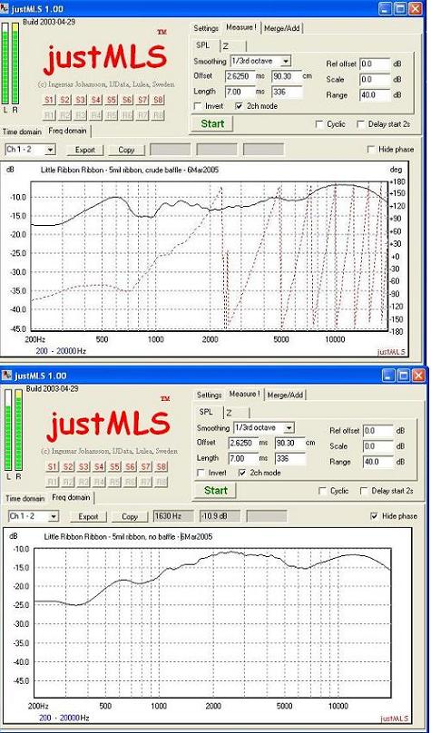

After measuring the big ribbon I decided to measure my prototype "little ribbon" (re: page 1). I measured it for several reasons:
1. I was just interested in it🙂
2. I was hoping to isolate the line source measuring affects of the big ribbon. I measured the big ribbon pretty close, much closer than I would listen. I wondered if some of the response lumpiness could be a function of cancellation effects from measuring it at a distance of ~ 30% of the line length.
3. I also wanted to compare the ribbon response with and without a baffle. My big ribbon measurements only had tiny "wings" and I made no serious attempt at a anything approaching a proper baffle.
I've attached the results of measuring the little ribbon with (top) and without (bottom) a baffle. One note on that baffle - It consisted of four pieces of cardboard taped together with masking tape. It is quite crude and I'll repeat this with a better baffle when I have the time and patience to make one.
You can see, the baffle made a significant difference below 1k. The response is still pretty rough in that area but I bet I can smooth it out with a better baffle. The response of the little ribbon, above 1k, is somewhat smoother than the big ribbon. My guess at this time is that the big ribbon response measurement was affected by line and or baffle effects. This is another area to dig into. I also plan to try out the little ribbon with the 7 micron foil that linesource kindly sent me. I tried it once before and confirmed an increase in efficiency. This time I can compare frequency response. It should improve, because of the lower mass and the mass may also affect ribbon resonances, which could also affect the frequency response and distortion (which I can't measure).

Dhenry,
The Al foil I sent you should be 5.8 microns thick. I do not know how well this thickness is controlled over the different rolls I have. This is commercially pure aluminum and does not respond to any heat treatment. Cold working will cause hardening.
For dipoles, the baffle effect comes in at the quarter wavelength...
13,550 inches/sec velocity divided by 4*baffle width will give you a rough estimate of where the 6db/octave baffle effects will show up on your measurements.
