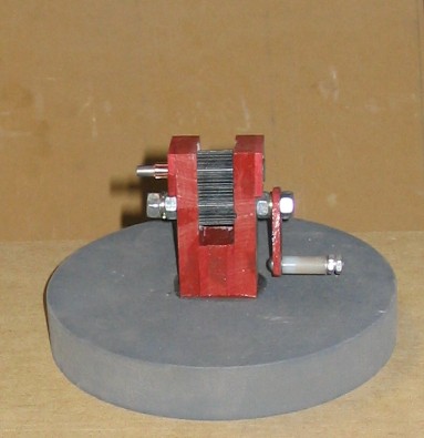

I finally decided to make a propper ribbon pleater. It's nothing fancy and actually a pretty close copy of one I've seen on the web. The only thing of real interest is that I found a source of cheap gears that will work for ribbons up to about 1/2 inches or maybe a little more. They cost all of 25 cents (!) each from BG Micro:
http://www.bgmicro.com/prodinfo.asp...S1155&page=1&cri=gears&stype=3&time_out=44:57

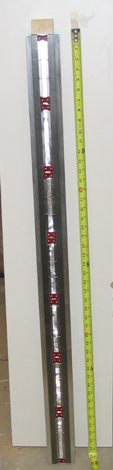

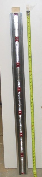

I did not have time last night to do much except post the pictures. Here are more details:
I have not listened to them yet. I still have to re-arrange my test setup as it does not lend itself to testing a four foot tall tweeter. It may take me a day or two to get everything re-arranged and rewired.

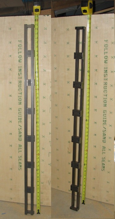

I spent this weekend dealing with two basic forces of nature: neodymium magnets and super glue😉 . I decided to attach all the magnets to each vertical pole piece and then connect the pole pieces with the crossbars. I stuck with super glue for the magnets - it's very nice to get an immediate bond. I worked out a process that allowed me to get the magnets placed correctly before the super glue caught. Towards the end it was working pretty smoothly.
The neodymium magnets I'm using are VERY strong and I can't imagine trying to handle something much bigger. It took some real concentration to manhandle those things to go exactly where I wanted them. It also was a very good workout of my fingers. Once I had all the magnets on one pole (21 magnets) I felt like I was holding a loaded gun.
In order to position the two poles, without getting them stuck to each other, I taped a strip of half inch Styrofoam insulation to the magnets of one pole. Then I clamped that pole to the workbench. I then put a couple more temporary spacers in front of that pole before bringing the second pole piece over. The attraction between the two even at a distance of 1 1/2 inches was tremendous. They were pressing so hard against the spacers that it was very hard to rip away the two temporary pieces. Once I had the two pole pieces separated by just the single thickness of 1/2 inch insulation it was literally impossible for me to pull the poles apart.
One last interesting indication of the power was when I started attaching the cross pieces. The crosspieces were pulled out of my hand at about 2 inches and stuck to the steel poles. It was then impossible for me to separate them or even MOVE them with my hands. I had to use a rubber mallet and hit the cross piece hard to move it into position for the screws.
Once the magnets, poles, and crosspieces were assembled, the completed magnetic path made the assembly quite benign to handle, as long as you kept anything steel away from the gap. I HAVE to get some (non-magnetic) stainless steel screw drivers and 4-40 screws that I use to hold the ribbon ends. Several times I had the screwdriver pulled into the gap, ruining a just installed ribbon
. I also had the 4-40 machine screws jump out of my hand and lodge in the gap, where it was again impossible for me to pull them out by hand. I had to use pliers, which also were attracted to the magnets. Like I said, I've got to get some non-magnetic stuff.
