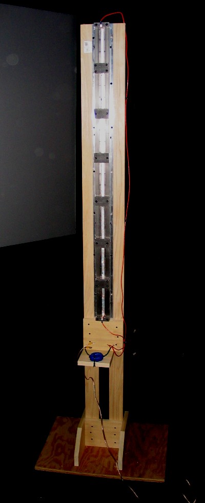

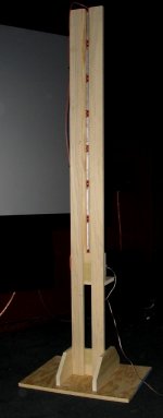

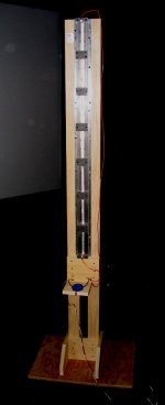

I've built a preliminary test stand for the ribbon and connected all the pieces and tried it out. I'm very happy with my early listening to the driver. It sounds "big". It projects a very detailed full sound (given that I'm only listening to >1.5k). I've done some preliminary measurements and I'm happy to say that the impedance through my DIY transformer is just about eight ohms (as calculated). Feeding it 2.88 volts produces about 95 db, which is about what I was hoping for. When I first connected it up I accidentally ran it full range. As long as I turned the bass knob on my receiver all the way down, the driver was happy with it and produced a surprisingly deep midrange. I'll have to experiment some more with crossover frequency.
Here is a picture of the test stand from the front. I've put on quarter round molding to help reduce diffraction (as linesource suggested). I have more quarter round that I intend to install on the back as well as some quarter inch wool felt to work on the back wave.
Here is the back, showing my transformer. I've wound it with tape to keep all the wire tight to the core.

Looking good Denis!
Here's the process I use for slitting ribbons up to 8'.
Stretch 3 layers of clear packaging tape the length of a glass table or mirror (MDF might work, but haven't tried it). Surface must be smooth and wrinkle free.
I use an Olfa "rotary cutter" available at Jo-Ann fabrics and a heavy aluminum straight edge I picked up at Lowe's or HD. I run the cutter perfectly perpendicular to the straight edge making the cut in one pass. I've found there is less chance of tearing if I pull up both sides of the cut at the same time. I haven't needed to use water with this process.
For the long ribbon "blowing in the breeze" a light resistive load (think 1-3 layers of grill cloth) behind the ribbon solves it for me.
If you want to suspend the ribbon at intervals along the length, I've found the "D" shaped hollow foam weather stripping works well. I like it better than "solid" foam strips.
