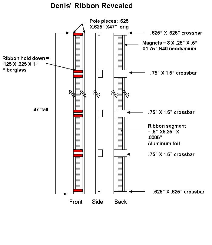

>1. Is your aluminum ribbon a full 36" long with crossbars to >support the structure of the frame each 6 inches, OR is it 6 >segments of ribbon each about 6 inches long with the ribbon >fixed to the crossbars at approximately 6" intervals?
I've included a diagram. It is seven separate segments with seven separate ribbons.
>2. What was your sure-to-be-patented method of holding the >magnets in place while the super glue dried?
I HAVE patented my method (don't try to use it without my express written consent). I call my method "fingers". The crazy glue sticks in about 2 seconds.
>3.Would this method allow epoxy to be used?
"Fingers" (patent pending) is not practical for epoxy - even quick dry epoxy.
>4. Would epoxy last longer (e.g. 20 years?)
I'm not sure epoxy would be better. The magnets hold onto the poles VERY firmly so there is no chance of them falling off. The glue is only stopping the magnets from pushing away from each other and leaving a small (1/8") gap.
>Would I be wrong to think that these "true" ribbons should >sound purer and perhaps go higher than the mylar/aluminium >composite ribbons of the old Carver speakers, or their modern >equivalents? I think that GRollins calls the latter type Magnetic >Planars.
I can't really compare the sound to other planars because these are the only planars I've listened to. I think they sound great but that could just be pride playing tricks with my brain.
>I remain impressed +++ and would be happy with a simple >diagram or two with a dimension or two to help the lead >headed.
Done and thanks - see attached image.

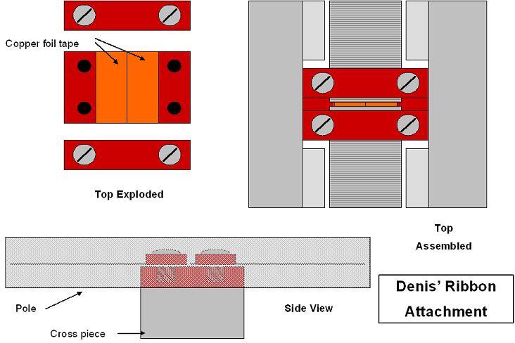

1. I also may have missed this, but how have you made the mechanical and electrical attachments to your ribbon strip - Clamping/gluing/soldering?
2. I also presume that you set the strip in the middle of the gap's antero-posterior dimension. How did you organize that?
3. Is "crazy glue" some sort of methacrylate glue?

Hi George:
1. The ribbon is clamped. I've attached a diagram.
2. I'm going to use temporary spacers on the magnets to center the ribbon.
3. Yes

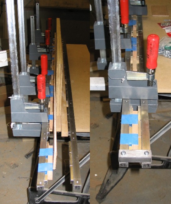

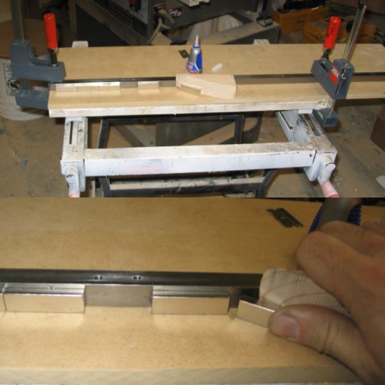

Well I did not get the second ribbon entirely constructed but I did get pretty far. I should be able to complete it this week. I thought I would show some pictures of how I get the magnets on the pole pieces. Getting a magnet on the pole piece is easy. Getting a magnet where you want it before the super glue catches is hard.🙂
The top picture shows the pole clamped to a folding work table. It's really important to get everything held in place before attaching the magnets - you don't want things moving around while you are trying to wrestle the magnet in place. The super glue I used is Loctite brand (I got mine at Lowes). It's got a neat delivery system that allows you to squeeze out glue with the bottle in any orientation. It comes in big bottles and the tip never clogs between uses.
The second picture shows me using a wooden wedge to control the magnet. The wedge allows me to get the end in the right place while keeping most of the magnet far enough away from the pole that it is not pulled out of my hand. I use two hands to do this. The picture shows one hand - the other is holding the camera. I first clean the pole and magnet with denatured alcohol to remove any oil. I put glue on the pole and then attach the magnets. The super glue gives you a second or two for final alignment.

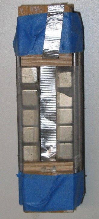

Here are a couple more construction pictures. The left shows the first step in bring to completed poles together. The attraction of two fully populated poles is intense you have to be careful. The first precaution is to tape wooden spacers to the magnets. These spacers are the same size as the gap. Then I put additional temporary spacers that will keep an extra ~2 inches between the poles. With the extra spacers it is possible to handle the second pole without crushing your fingers. I take the second pole and place it against the spacers and then remove spacer layers until the only one left is the gap spacer. At this range (1/2") , the poles will hurt if you get a finger caught. Ask me how I know.
The second picture shows the two poles separated by the gap spacers. It also shows a crosspiece connected. As I said in a previous post, the cross pieces are so strongly attracted to the poles that, once attached, the only way to move them is to “nudge” them with a rubber hammer.

1. Do you think that if one were to make a ribbon like your 6" prototype, that there would be advantage in two screws at each crosspiece. This would be difficult with the narrower crosspieces. In that design is there any disadvantage in using the wider crosspieces that you used in the 3' design?
2. In the 3' version, is there any advantage or disadvantage in using the wider crosspieces at each end of the pole pieces?
3. How much magnetic material is in those clamps?

>1. Do you think that if one were to make a ribbon like your 6" >prototype, that there would be advantage in two screws at >each crosspiece. This would be difficult with the narrower >crosspieces. In that design is there any disadvantage in using >the wider crosspieces that you used in the 3' design?
The machine screws are only used to hold the steel pieces together. A single screw at each corner is plenty. There might be a performance disadvantage of trying to squeeze in two screws; The steel is there to complete the magnetic path. Drilling holes reduces this pathway. Of course if the screws you use are magnetic, that will tend to compensate for the hole. They are less effective than solid steel as they are not as tightly coupled. I would stick with one screw per corner and make the screws smaller diameter. I used 1/4 inch (overkill). You could easily get away with #10 or # 8 screws.
FYI: On my big ribbon I put double screws in a couple cross pieces. I was worried about the frame racking (turning into a trapezoid) without them. I’m not convinced they are needed. It is very sturdy construction. Any bump is more likely to cause damage to the bumper (floor, knee, etc) than the bumpee ( ribbon frame).
>2. In the 3' version, is there any advantage or disadvantage in >using the wider crosspieces at each end of the pole pieces?
I don't think it hurts at all. In fact it might help a little as my femme simulation showed that crosspiece a little closer to saturation than I might like.
None - if you mean the red clamps I use to clamp the aluminum foil. Their purpose is to provide mechanical support for the ribbon and to electrically connect the multiple segments (hence the copper foil strips). In my original ribbon the 4-40 screws and lock washers were magnetic steel. I'm changing them to stainless steel because it's a pain to have them jumping into the gap all the time
>Regards,
>George. [/B][/QUOTE]
Denis
PS
Once again, neither sparrow gas nor bee naught bits. Once again I am disappointed.
