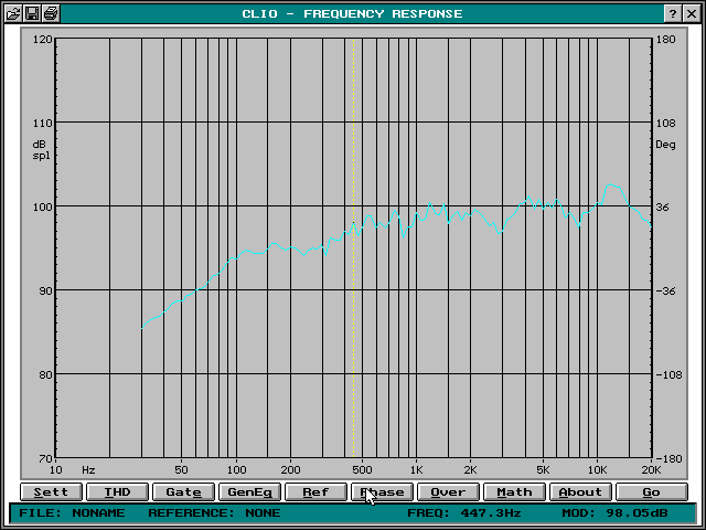

It looks very interesting. How about a synopsis in english? From the pictures it looks like a planar magnetic with three conductors about a foot l(300cm)ong. It also looks like you built a second that is about 4.5 ft (1500cm). How close did I come?

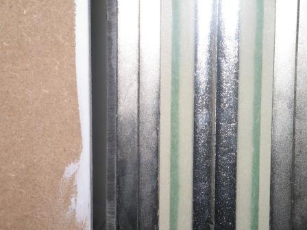

Your site is very informative. I was glad to see all the detail shots of the fiberglass clamp/interface. Very nice work!

I'm ready to declare that my site is "done", at least as far as the Ribbon Project is concerned. I've got several unrelated projects that only have placeholders, but I'll gradually fill them in.

I think you should be able to hit the 105db reference level you are looking for with 2 or 3 segements. I know with my big ribbons I can easily hit 105db with continuous tones without melting the ribbons.
