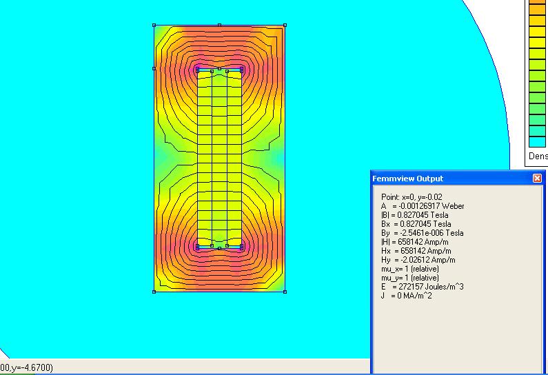

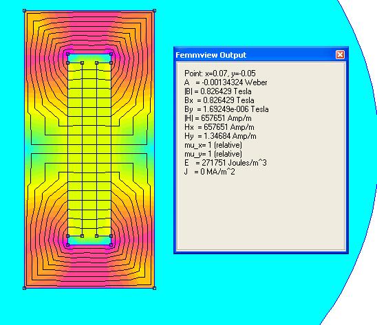

WOW thanks Dhenry... I figured out ... this program is easy to use!!!!!!!!!!!!!!
here's my model
using 1.5"x1.5" steel... with
If I move down to .5" thick Neodmynium I still get a .82 telsa field...
make sure I did this right... the dialogue in the attached pic is a click on 0,0 in the field
here's my model

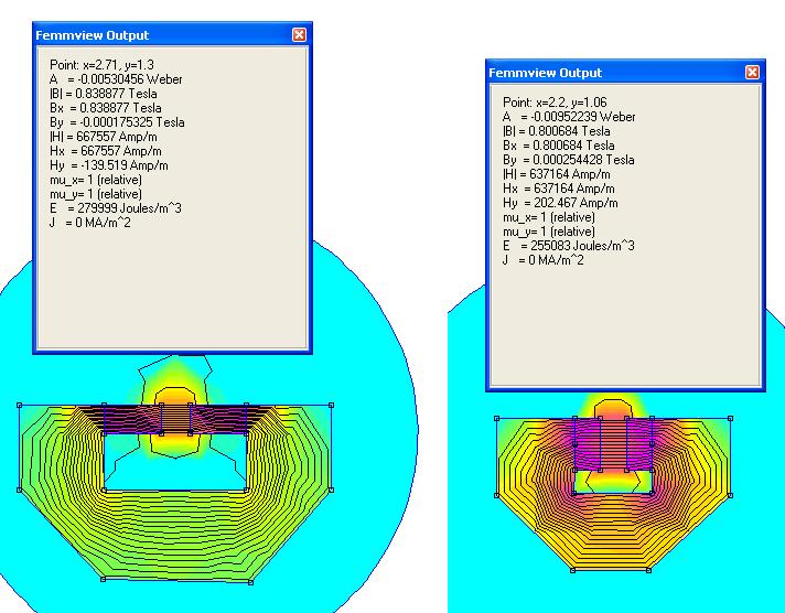

I tried doing side shots... and guessing as to what the extra bracings will do...
the first one on the left in the pic... is a 4 stacked magnet... so 1" thick by .5" deep
the second one is 1" deep, by .5" thick....
as you can see the 1" wide one has the higher magnetic field... around .83 telsa

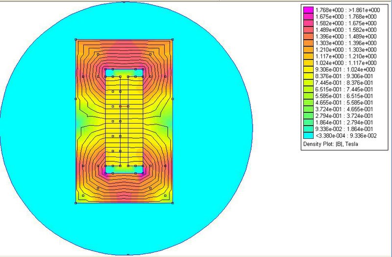

real quick note...
I've been modeling a lot of these sims... and I did a profile sim with U-shaped steel... and the flux in the gap is 0.86 T... good enough I think... and it reduces the magnet costs back to something MANAGABLE...
it's 4 stacked magnets every .75"... which makes a 1" depth...
1 telsa from Dhenry's model but on a profile model with U circuit it's .86

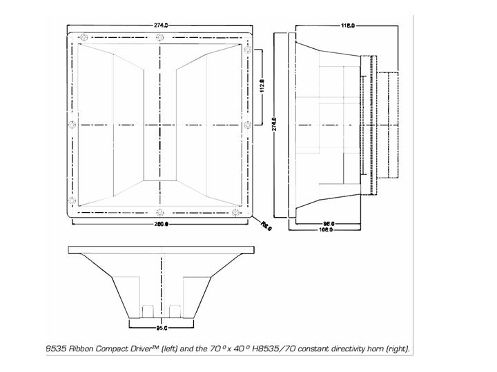

LineSource said:Example wave guide, called compact horn by SA. From SA Compact Ribbon (planar driver). Used to increase efficiency at the cost of more controlled dispersion.
would a more simple 1/2 round or quarter round trim piece like Dhenry and others have used do the same thing?
Audiophilennoob,
A modest diameter quarter round is used to reduce the edge diffraction effects of the pole piece. It will not noticeably increase efficiency. Diffraction is the bending of waves around small obstacles and the spreading out of waves beyond small opening like the pole pieces of a ribbon. When a wave hits a sharp edge, different frequencies will bend at different rates, and this "smears" the image.
Personally, I would not use a waveguide/compact-horn as it often compromises the imaging. A quarter round, or angled bezel often gives the best sound. Quality vs. quantity.
LineSource said:Audiophilennoob,
I see now... yea I won't use a waveguide now I guess
