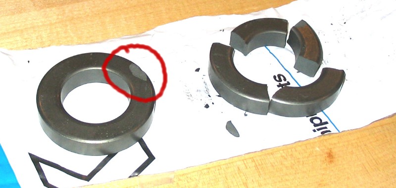

Transformer calculations
CV - GREAT post! That was exactly the kind of information I needed to get me started.
Based on plugging in parameters from my torroids I can see that they have the (probably fatal) flaw of too small a cross section. A very rough calculation says that my F-150-W core has a cross section of ~ .257 CM^2 as compared to the 2 CM^2 in your assumption. Working this through seems to indicate that it is too small to handle the kind of input voltages I need to reasonably power the ribbon.
As luck would have it, I ordered two additional cores yesterday AM when I ordered the new magnet wire and they look like they could work very well.
Here are the calculations for these new toroids and where I use other formulas from the net, I'll post a reference link.
New torroids:
Model FT240-77 (2.4" OD, 1.4" ID, .5" thick - Type 77 ferrite)
http://www.oselectronics.com/ose_p88.htm
u = 1800
mh/1000 turns = 2740
Max flux density of type 77 = .46 tesla
Here we go:
CALCULATE DESIRED PRIMARY INDUCTANCE
Primary Reactance = "CV" Rule of thumb 5-10 times desired impedance
Xl = 2Pi * f* L
http://www.allaboutcircuits.com/vol_2/chpt_3/2.html
L = XL / (2Pi * f)
L = 8 * 10 /(6.28 * 1000)
L = .0127 ~ 13 mh
Xl = desired impedance in ohms
2Pi = 6.28......
f = crossover frequency = 1000hz
L = inductance in Henry
__________________________________________
CALCULATE PRIMARY AND SECONDARY TURNS
Primary Turns = 1000 SQRT (L / toroid mh per 1000 turn)
L = Primary Inductance in mh
Primary Turns = 1000 SQRT (13 / 2740)
Primary Turns = 68 Turns
Primary impedance = Turn Ratio ^2 * Ribbon resistance
Turns Ratio = SQRT (Primary impedance / Ribbon resistance)
Turns Ratio = SQRT (8/.028) = ~16
Secondary Turns = Primary Turns / Turns Ratio
Secondary Turns = 68 / 16 ~ 5 Turns (rounded up)
CALCULATE MAXIMUM INPUT VOLTAGE AND POWER
A = Torroid Cros Section = 1.25cm *1.25 cm = 1.56 cm ^ 2
A = .000156m^2
N = V / (4 * F * A * B)
(Formula different than CVs but mostly units and maybe CV forgot Frequency term?)
http://www.magmet.com/lamination/europeantransformer.html
N = Primary Turns
V = Max RMS Primary Voltage
F = Xover Frequency
A = Torroid cross section in M^2
B = Max flux denisty in torroid in Teslas
4 = constant (something to do with converting peak V to rms?)
V = N * 4* F * A * B
V = 68 * 4 * 1000 * .000156 * .46 = 19.5 V rms
P = V^2 / R
P = 19.5 ^2 / 8 = 47 watts
P = Max power applied to primary without saturating core
R = Reflected impedance at primary
SUMMARY FOR FT240-77 BASED RIBBON TRANSFORMER
Primary = 68 turns (I'll probably use 16AWG wire)
Seconday = 5 turns (I'll use 14 AWG wire)
Impedance @ Primary = 8 ohms
Max power at Primary = 47 watt (more than enough)
I hope I didn't botch the math too badly. Let me know if I did. I got a feeling I'm going to be using the edit button on this one.

omission from transformer eqn explanations
Allo,
My original formula, V=BANw was rougly correct but I neglected to mention what "w" was - it's the so- called "angular freqeuncy", which is just 2*pi*f.
My V is Vpk, divide by 1.414 to get the rms - if you apply these factors, you pretty much get:
Actually, I think I get a factor of 4.44 there - I may have forgotten a scaling factor of 1.1 - that may have been if you use a square wave instead of a sinewave, 'fraid I can't remember.
In any case, be conservative and run the transformer with plenty of magnetic (flux limit) headroom.
I would concur that if a suitable mains toroid can be found, it may be a nice cheap option.They can have ridiculously good topend bandwidth Only thing to watch is the DCR of the secondary - don't want to throw away a load of efficiency.
Anyway, best of luck - doesn't sound like you'll need it as you seem to be well on track.
Cheers
Allo,

Nothing new built or tested, but I was able to dig up some good tranformer references and answers to some of my previous questions.
First the references:
Rod Elliot and his ESP site has a two part discussion on transformer design. I love that guy; he is one of the best DIY resources on the web. It's mostly about power supply transformers but there is enough about Audio and audio frequency losses to be very interesting:
http://sound.westhost.com/xfmr.htm
http://sound.westhost.com/xfmr2.htm
Other good references:
http://www.fair-rite.com/Broadband.pdf
http://geek.scorpiorising.ca/windingtransformers.html
Regarding my question about things that could affect transformer audio quality;
It seems that the key thing to avoid distortion is to avoid running into saturation of the core (as CV said). Even though my calculation showed the transformer could handle 46 watts, I'll probably need to keep well below, maybe 30 watts, to avoid the saturation "knee" of the BH curve.
Two things that can affect phase response and high frequency response are parasitic losses due to stray capcitance between windings and leakage inductance caused by imperfect coupling of the coil field to the core.
To reduce capacitance it seems that I want to keep as much distance between the turns as possible. In other words, rather than having the turns touching each other in the toroid "hole", I should spread them out. It also seems to me that I definitely don't want to layer the secondary on top of the primary. The further apart the wires, the less capacitance between them (?).
For inductance losses, I obviously want to wind the wire as tight to the core as possible for the best coupling (but not so tight as to breake or rub off the insulation!). I THINK I also want the primary inductance (and hence the number of turns) to be as small as possible while still meeting the rule of thumb of presenting an inductive impedance at Xover 5-10 times reflected load (i.e. 8 ohm * 5 or 10). You can't reduce the number of turns too much though, because it is directly proportional to the power handling capability.
Lastly, I think I understand why my Version 1 transformer worked without blowing up my amp. The turns ratio was way too low so the reflected load was probably less than an ohm. The saving grace was that the 20uf low pass filter combined with the low impedance to produce a really high Xover frequency, maybe over 10k. There was so little power in that freqency range, especially listening to FM on a 30 year old receiver, that id didn't hurt the amp.
If anything (or everything) I said is wrong, please let me know. I'm just trying to paw my way through all the information and learn something. I hope you folks don't mind me treating this thread as kind of a Blog of my investigation. It's the kind of thread I would have liked to find when I started looking at DIY ribbons.

Well I got my new toroids today. One of them came with a big chip in it;and that was the good news. The other one came in four pieces
It was a combination of brittle ferrite, poor packing and UPS' gentle handling.
I took the chipped torroid and made the Version 2 transformer. This wooks much better. It gives me an impedance of just about eight ohms. I've got jury rigged small gauge wiring and a couple of clip on connectors so I think I'm losing some efficiency on the ribbon side and effectively increasing its resistance with bad connections. The end result is that I got my eight ohms but only needed a turns ratio of ~ 8:1 (instead of my calculated 16:1). The primary inductance is 10mh and the leakage inductance (measured with an LRC meter and the secondary shorted) was .5mh. I don't know if this is good or not
