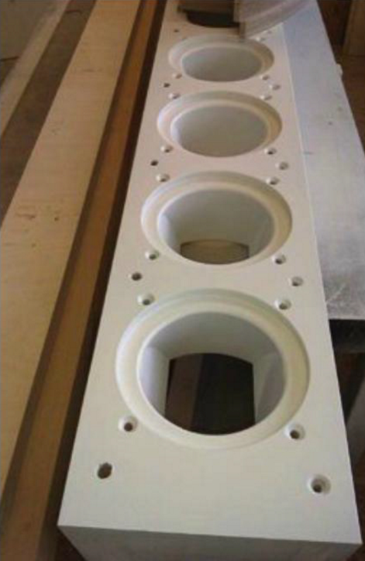

It would be interesting to see simulated performance of an array of TC9's behind a waveguide. To know what to expect at the bottom end.
The first results from that 4 array driver from Joseph with 10F drivers, which are a match to the TC9 size wise do make it interesting to see if we can find ways to avoid that big notch. Just be aware that it will have an effect on the bottom end potential as well.
If we could get it to behave on the waveguide, you could still use the Synergy approach to reinforce that bottom end. However it would make sense to start with smaller drivers when starting from scratch with an idea like that.

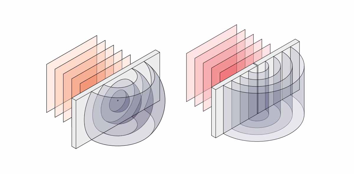

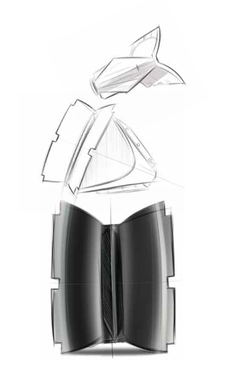

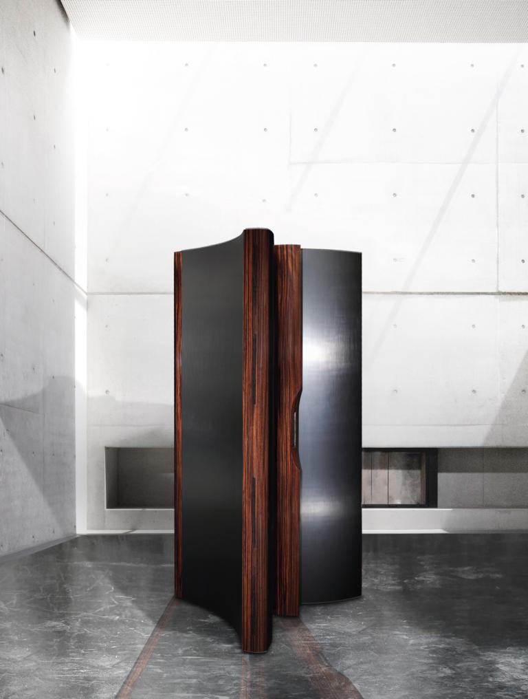

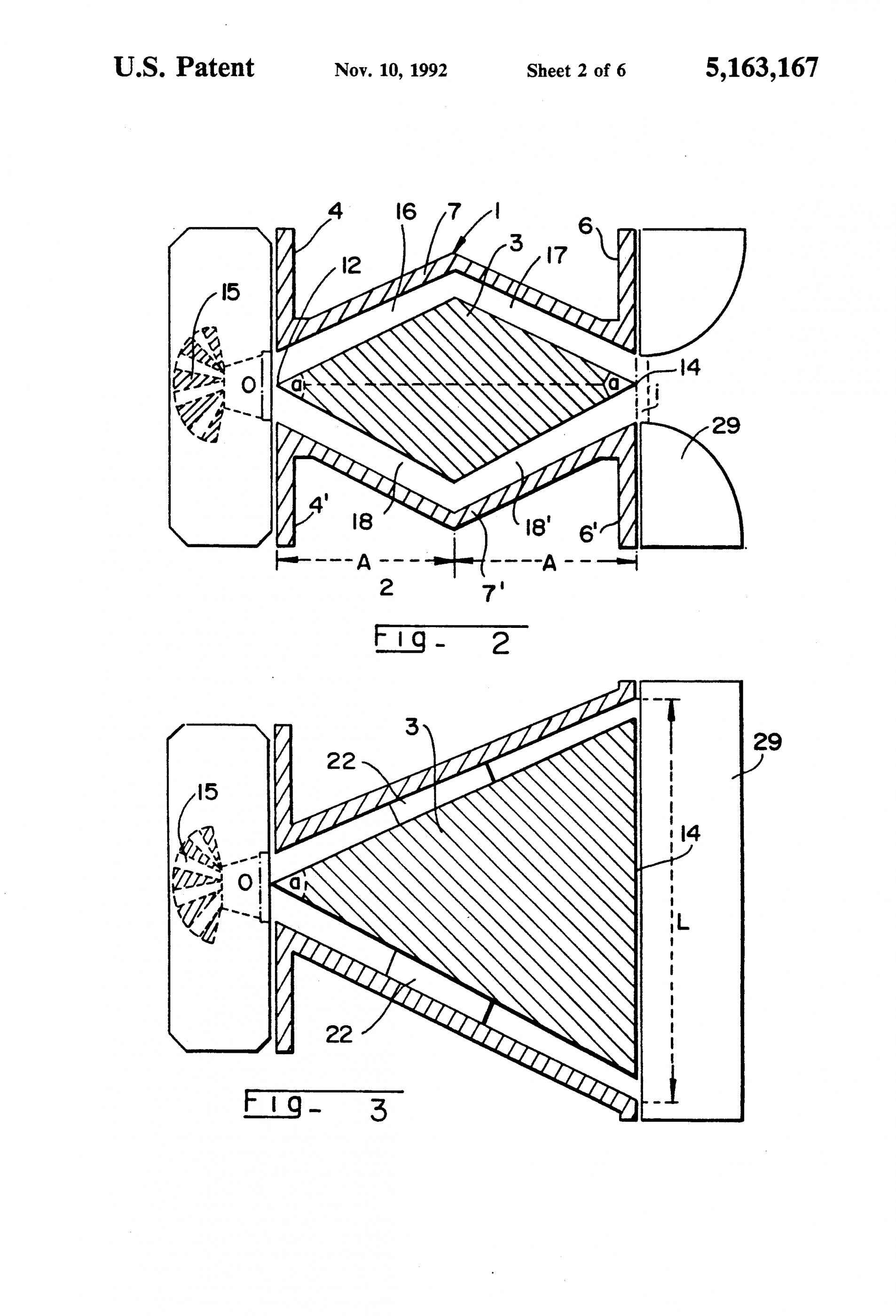

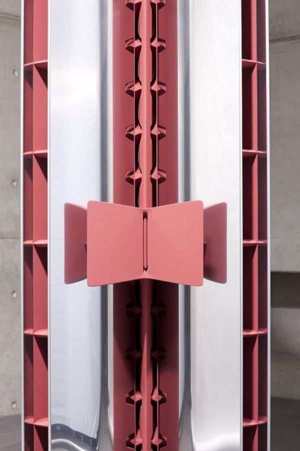

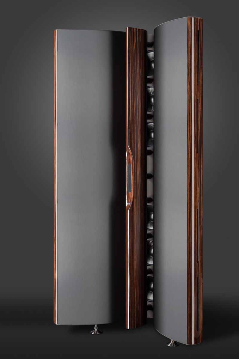

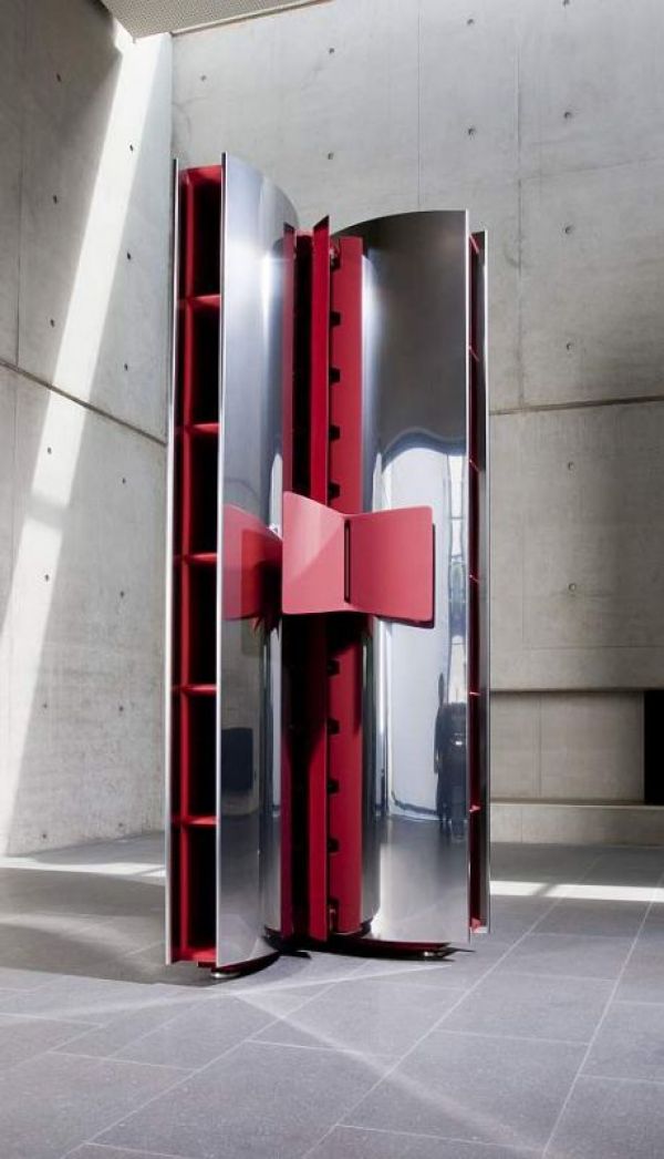

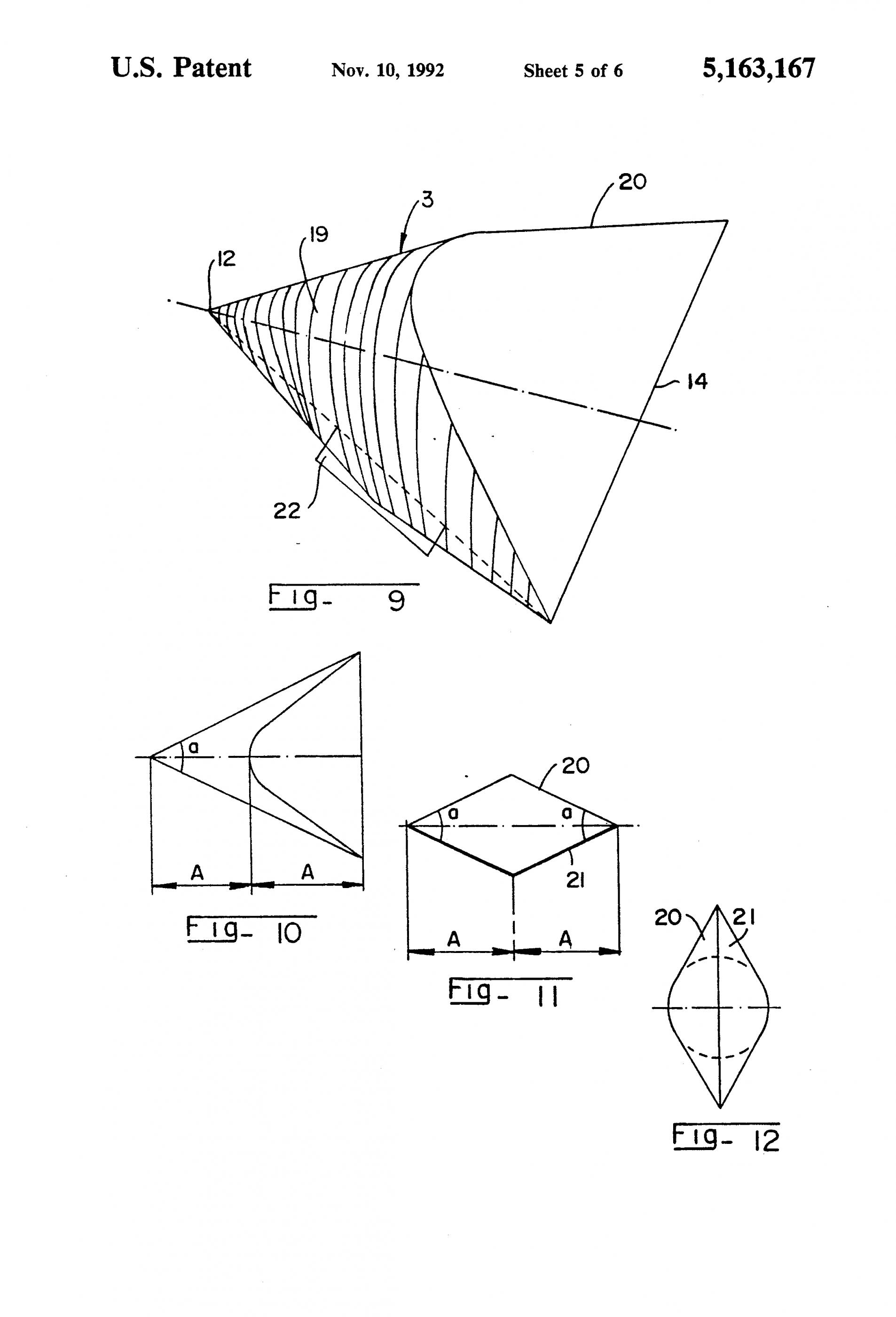

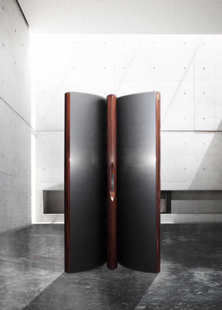

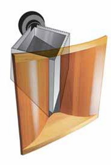

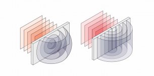

Interesting concept NC535, it somehow reminds me of the Backes & Müller Line 80 and 100.
Except those are not full range line arrays. From 800 Hz and up the single Line Radiation Unit (or, in German: Zylinderwellenstrahler) takes over.
The BM 100 is fully compression loaded though.

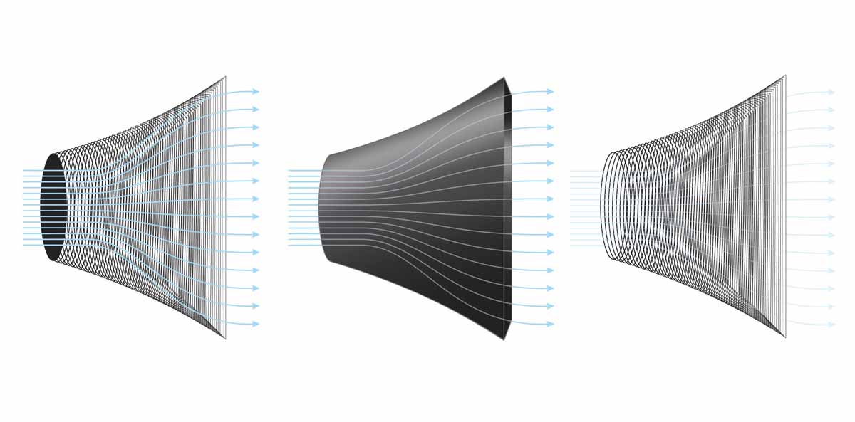

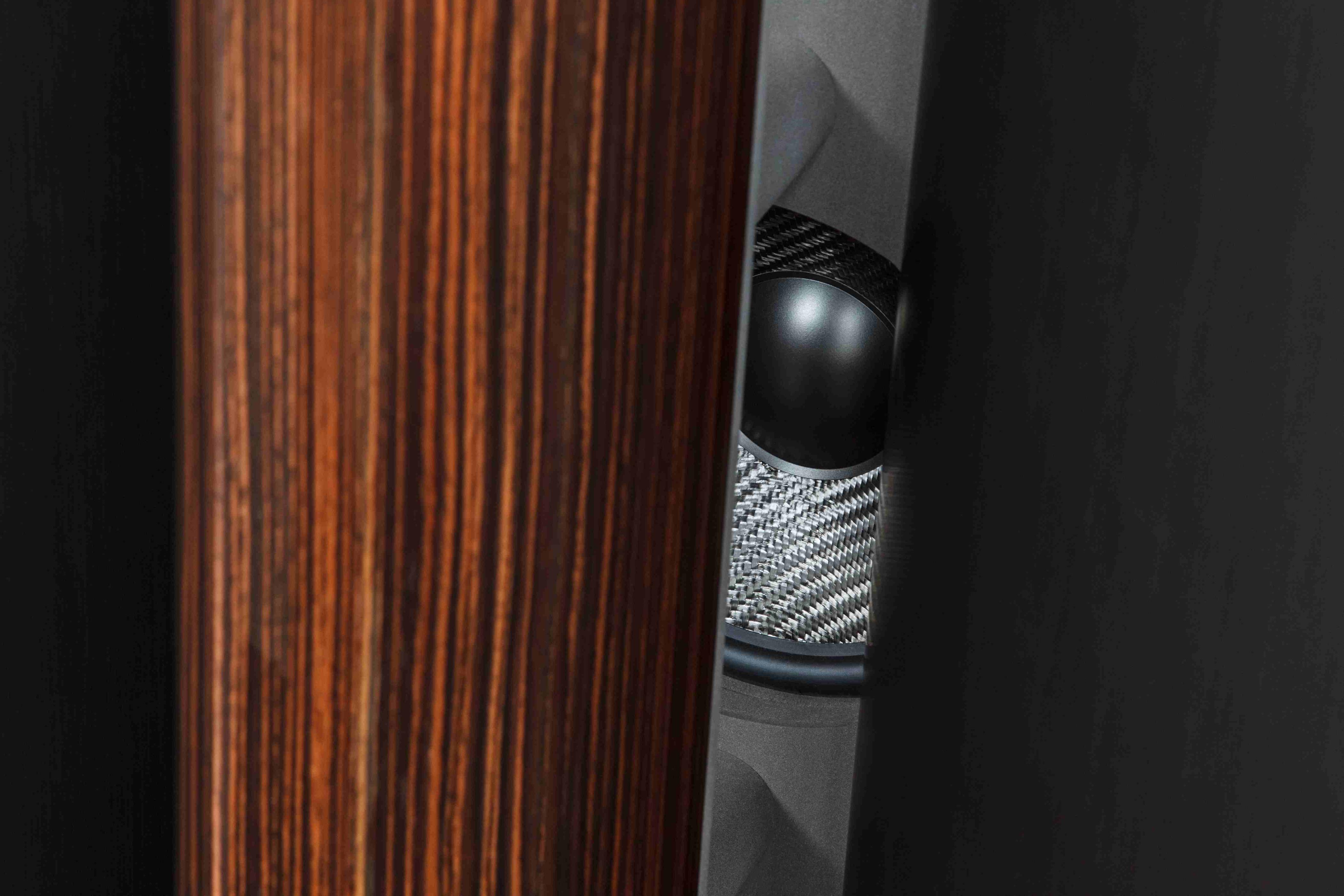

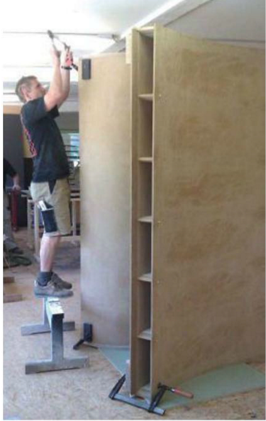

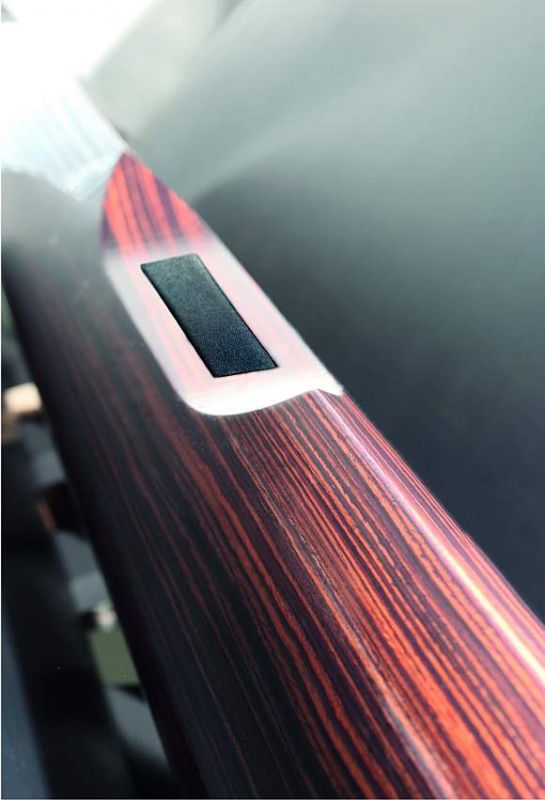

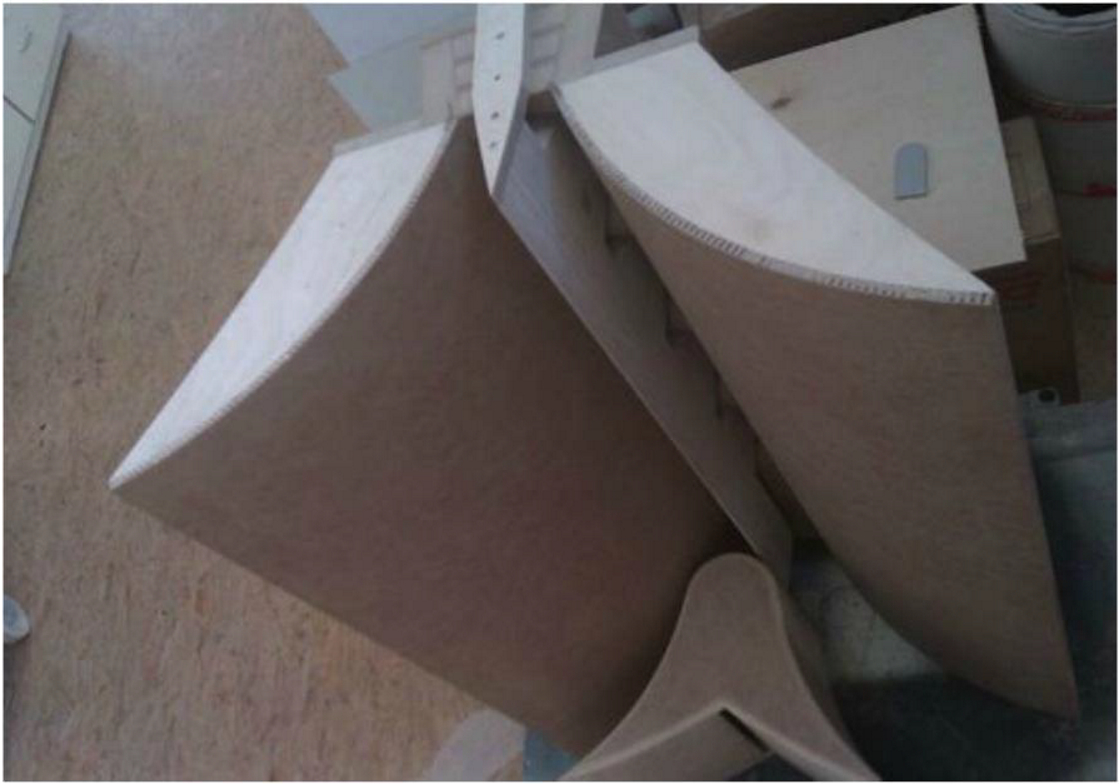

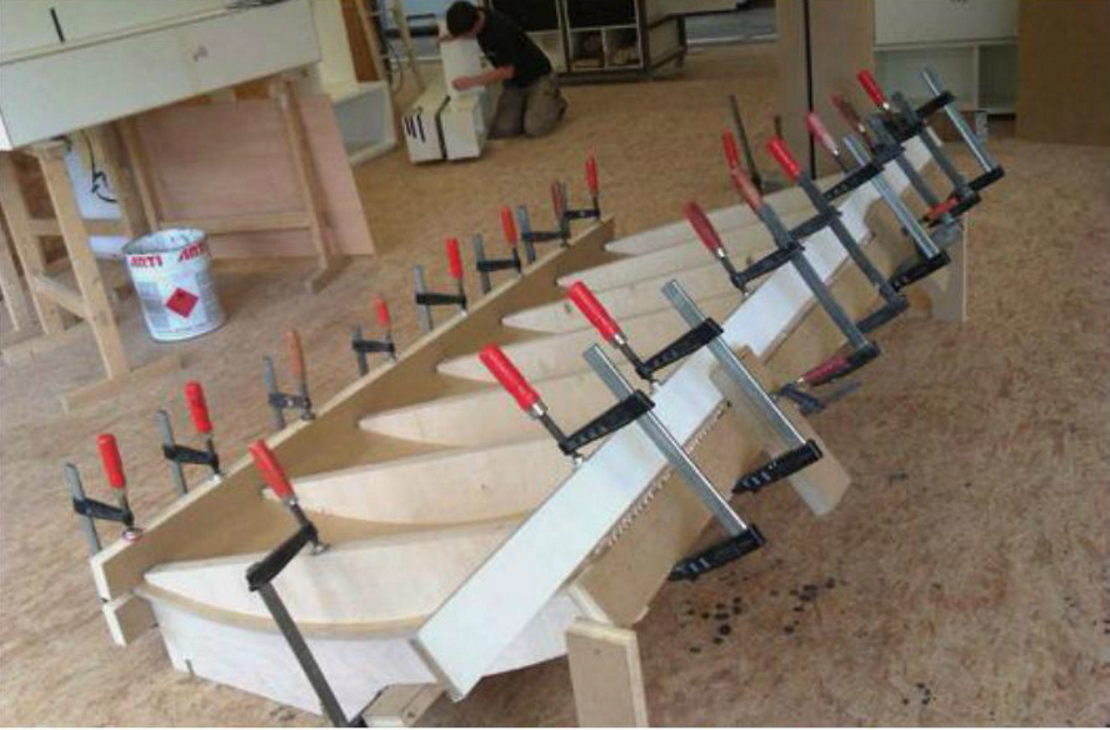

Some mediocre-quality pictures of the construction of the BM Line 100:

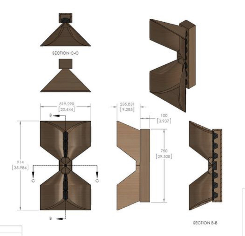

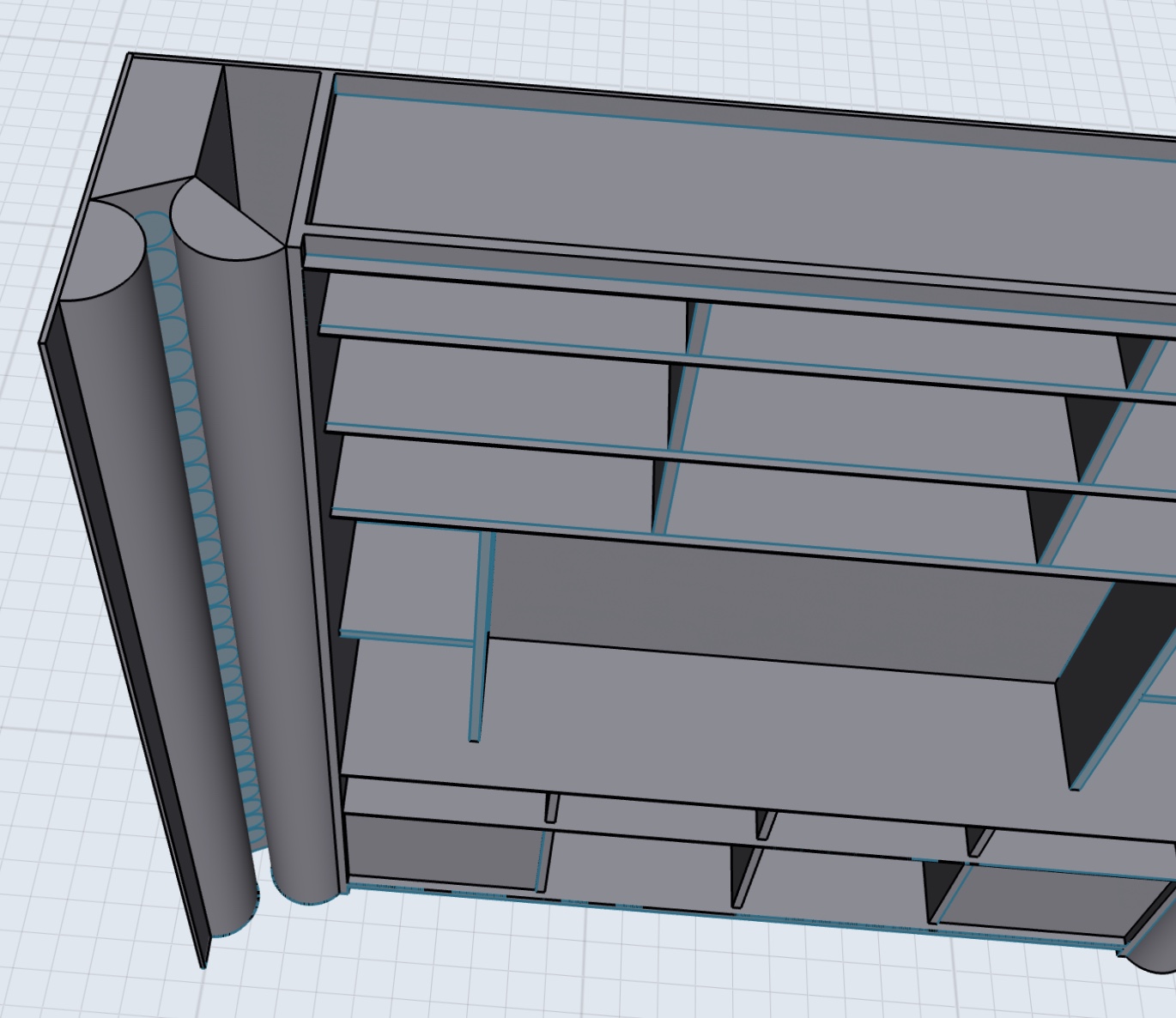

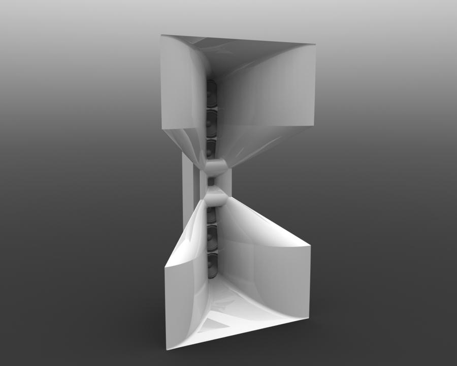

Thanks for the pics, RO. As often they are inspirational. Unfortunately for me the resemblance to my concept is faint and only visual. B&M seem to have mastered the technique of using tweeter/tweeter array as a phase plug for a LF array. I suppose if one can afford a house large enough for those speakers, one can also afford the speakers.
But I want/need speakers that will hug the wall and have minimum footprint. Earlier threads, (Bushmeister's) showed how critical throat treatment is in mating a full range driver to a horn. I think its even more so for a line of them. I may have to fall back to my earlier concept of flanking the corner line array with absorbers and then, if I want a companion bass array, have it play through one of the absorbers.
It was only the visual aspect of your concept - especially the horns - that reminded me of the BM line speakers 😉

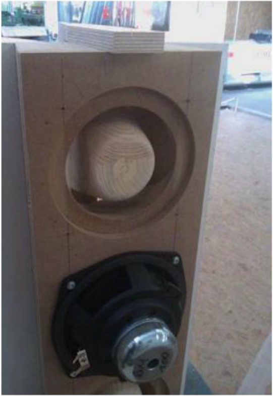

I’m sharing this horn design as well for interest’s sake. This uses six 4” midrange drivers with a single compression driver for 2kHz and above. The hour glass shape reduces the off-axis narrowing effect in the upper treble creating an even power response. There should be very good pattern control in the vertical axis which reduces ceiling and floor reflections. So it does not aspire to full array ideals.
An interesting design. May I ask what size CNC router are you using? I plan to build one of the designs from V1Engineering.com. For DIY they should be perfectly fine - I am still not decided on the model and size.
Do you think using XPS boards instead of wood would work as well?

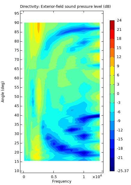

Good day to you all!

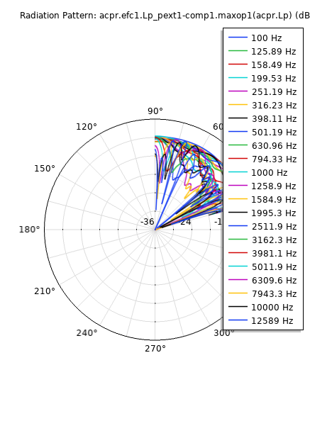

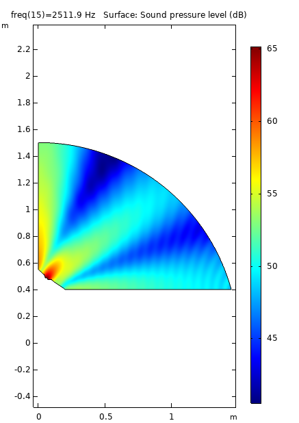

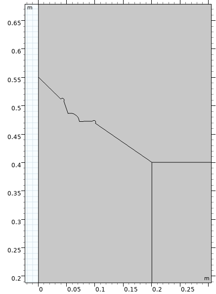

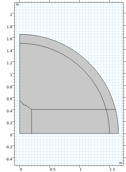

I've spent some time trying to learn Comsol which I have access to trough work in order to simulate radiation pattern and directivity for the proposed corner line array. I think I start to get a hang of it. I do a very simplistic model of the driver membrane, which vibrates in a pistonic motion at desired frequencies with constant acceleration.
The program open up for lots of possibilities to simulate and optimise the design. Some examples:
Simulated geometry of corner array between wall an book shelf:
Zoomed in to see the outer driver geometry:
Sound pressure level at 2512 Hz:
Radiation pattern normalised to maximum level at a radius of 1.5 meters from the corner:
Directivity plot at 1.5 meter radius from corner:
Lot's of interesting investigations can be done here. The software also includes an optimisation tool, so it is possible to optimise baffle/waveguide geometry with respect to desired output. I will try a number of things here and post my results.

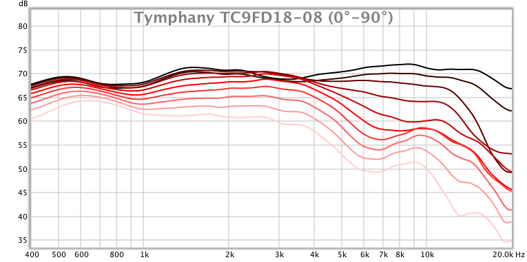

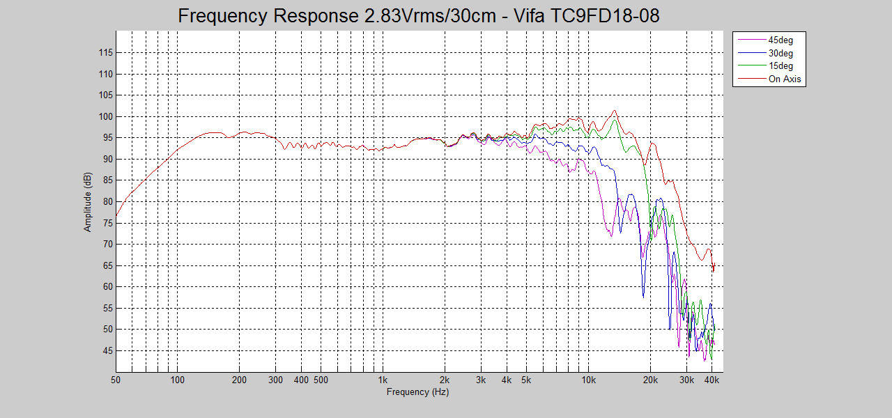

Before continuing: do any of you have directional data for the driver (TC9FD)? I would like to verify the the polar response (as an infinite baffle setup) of the modeled driver geometry so I know I can trust the simulations onward.
I know there are response plots at different angles in the data sheet, but it would be great to have actual numbers/data.

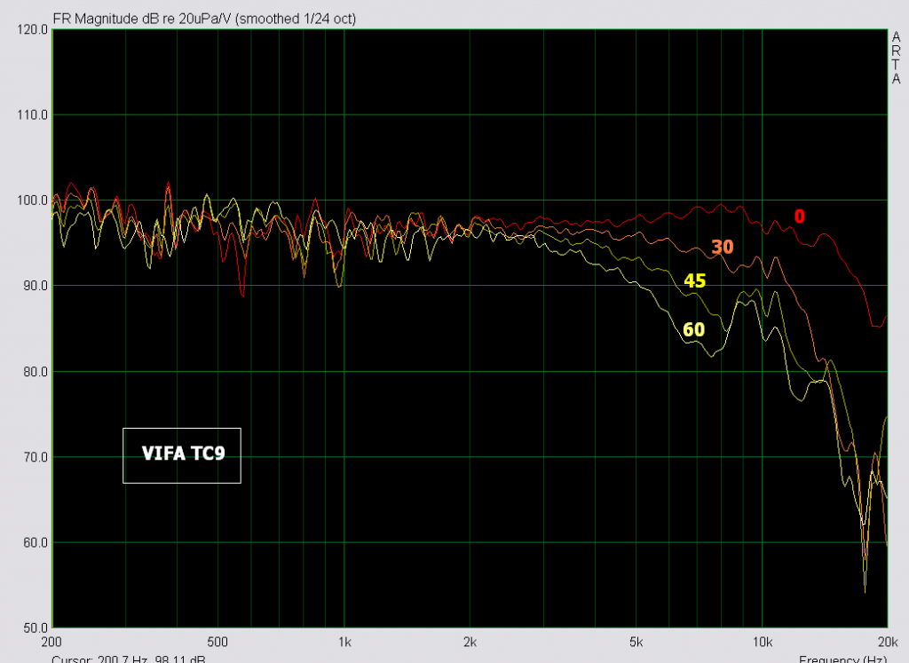

Well then you know you can synthesize directivity for TC9 using Vituix diffraction and SPL trace tools. However, I remember some time ago Art Welter posted a graph of polar measurements of TC9; don't recall where though. Perhaps if you contacted him, he would be willing to share the files behind that graph.
There should be a thread dedicated to the TC9 that has some of these graphs. I've had a lot of those at one time, here's an example:
And:
And:
(not of much use this smoothed and without a legend)
And:

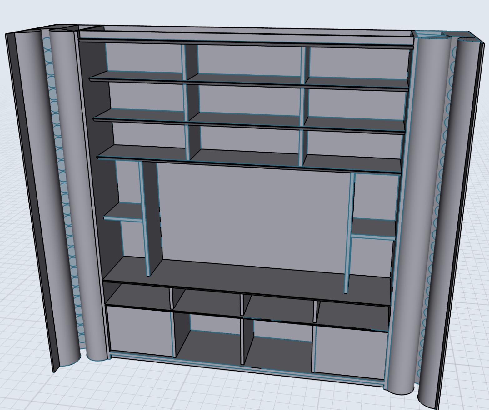

It’s been a while and not much progress I’m afraid. But good things take time!
I have a new suggestion for the design in order to avoid to much early reflections in the room. As I have to stick the speakers into the corners of the room and have some difficulties to dampen the first contra lateral wall reflection my idea is to reduce the off axis dispersion with those absorbing half cylinders close to the arrays:
As I said earlier I would like to have a very clear early wave front unobstructed by the room. Any thoughts of this?

Unless the cylinders are completely absorptive you will get a lot of very early reflections with a frequency dependent nature. If they are completely absorptive you will lose a lot of spl.
Reducing early reflections can be a good thing but be careful not to throw the baby out with them too 🙂
