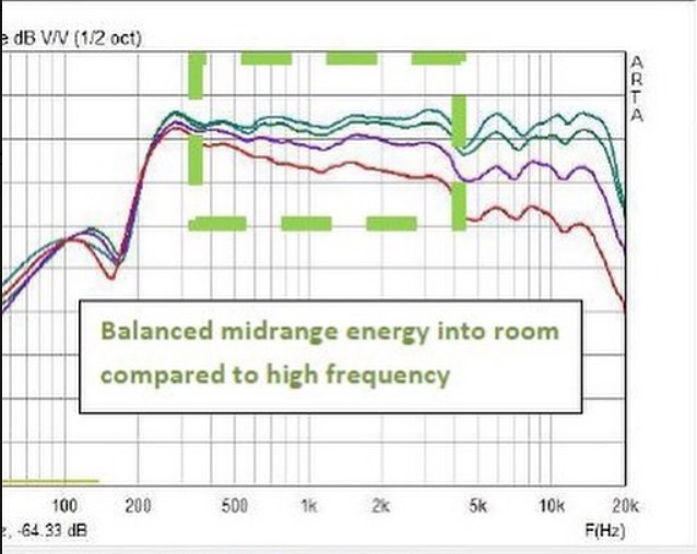

I've selected a volume level that produced the least distortion for the non-horn speaker and then level matched the horn speaker's to the non-horn. This ensured I wasn't stressing the non-horn speaker which would invalidate the comparison. So the horn is -60dB from the fundamental (0.10%) while the non-horn is -48dB (0.80%), looking at 1kHz region.
That is much clearer 🙂 Do you know what the SPL level and distance was for the measurement? Without that information it is pretty hard to compare against the plots I posted, my SPL levels as shown in the graphs are correct and calibrated, distance was about 2.7m in the in room one and probably 2m for the outdoor, can't remember.

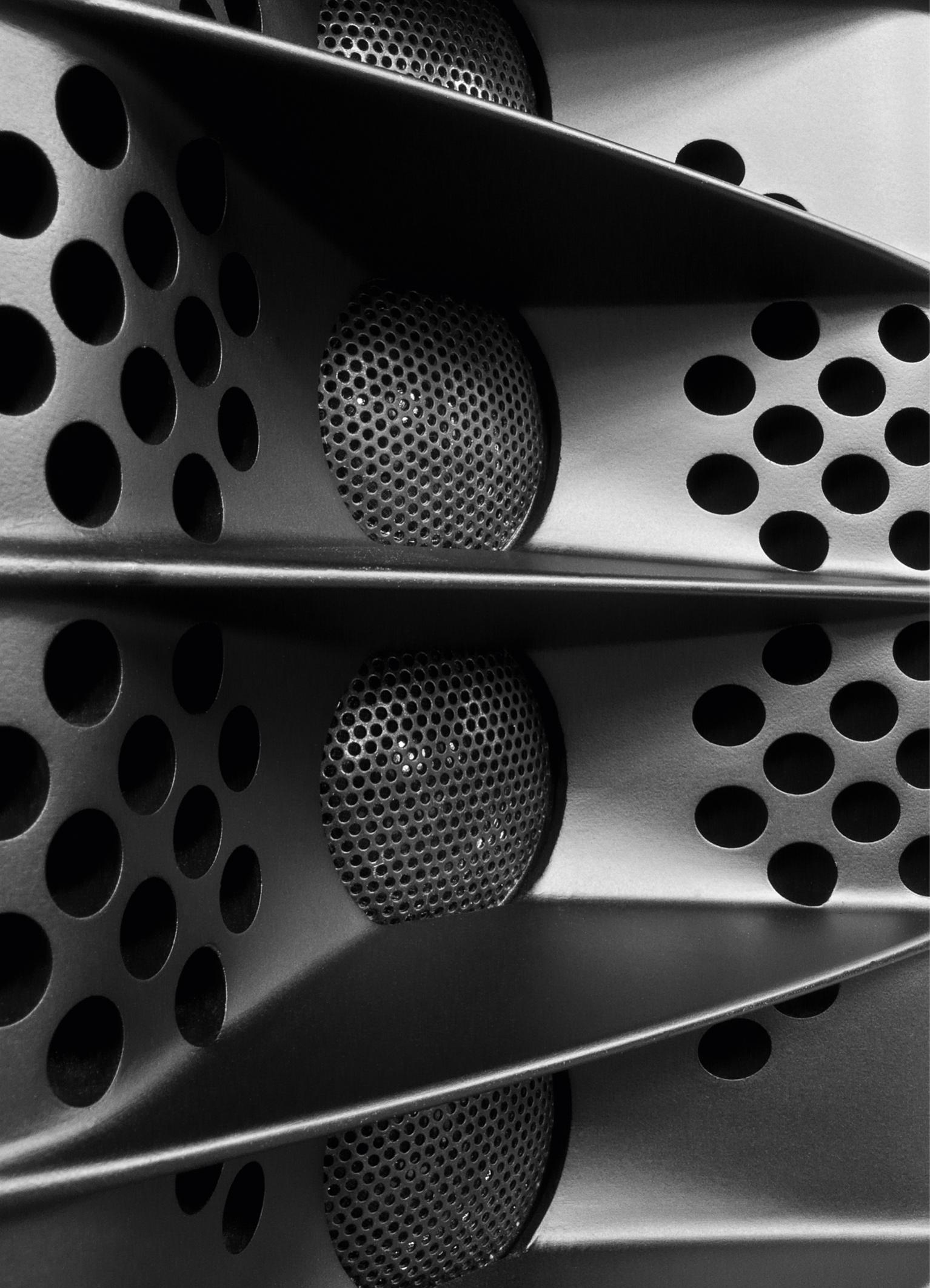

An intriguing picture of a line array horn was posted. What can you tell us about that horn's measured or expected or simulated performance?
More information would be very welcome 🙂

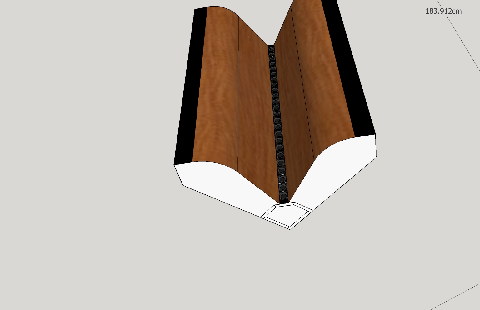

I am interested to see if the line array waveguide gets built and tested and the real life effects of the phase plug. Seems like it will be quite the construction project if it would be formed from stacked CNC cut pieces.
It does seem to be a good option for crumboo given the placement constraints in his room.
Yes, more info would be welcome. Building such horn is a big investment, so I need to be pretty sure that it works 🙂
I'm a bit worried about the the dip at 5 kHz also - can anything be done about it? I'd like to be able to do some simulations to get a clearer view on how the horn + phase plug works. I do have access to Comsol through work, but not the skills (yet).
A potentially cheaper way to make something like that waveguide would be to build it like an aeroplane wing, have a few of the shaped pieces as ribs and wrap it in thin ply. The void could be filled with whatever you like, halair's expoxy crete might work well and be heavy enough to be free standing.

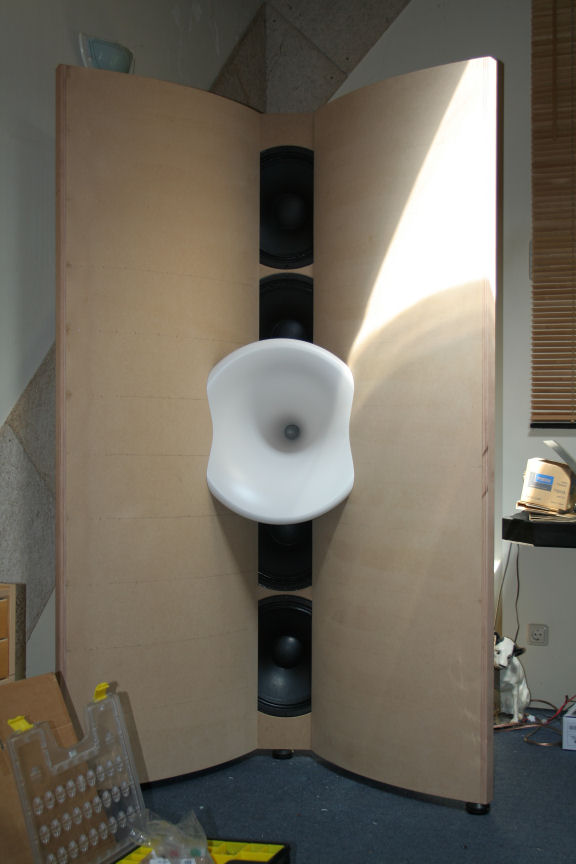

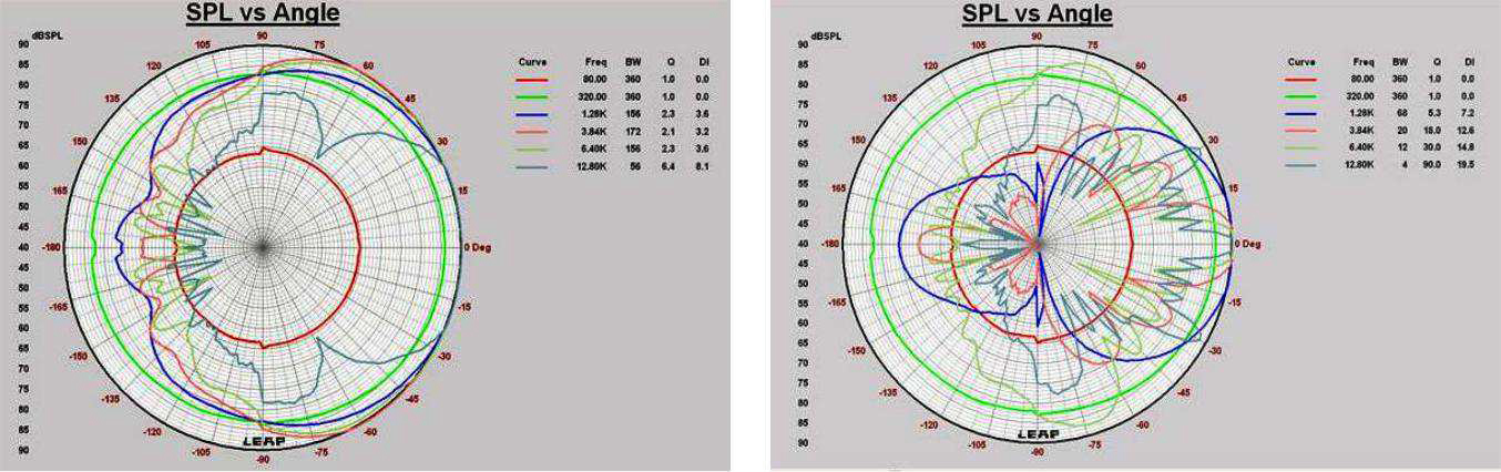

Here's a comparison between the horn vs non-horn. The left column of measurements is the non-horn single driver... right is the E-250 horn with four SS 10F drivers. There is only one phase plug in between the two middle drivers. There is 0.10% distortion through the midrange with the horn... is this good performance compared to non-horn multiple driver line array? Please share if you've measured your line array. My mic distance was one meter.
Are the basic horn (profile) and the slot width (1.7") of the E-250 similar to the horn of your line array?

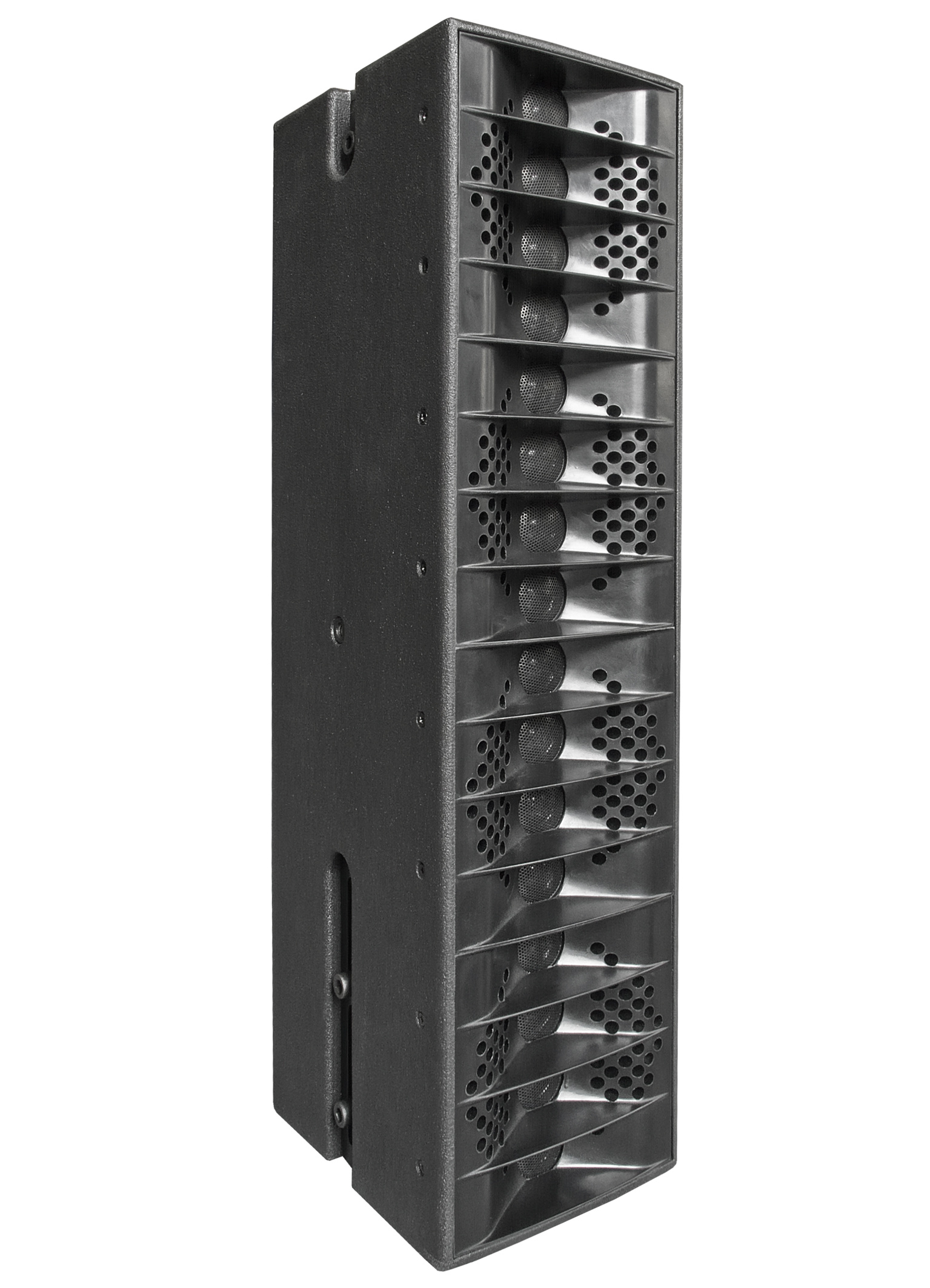

Seeburg's GL 16 for comparison. Some issues >4k, despite the use of 1" dome tweeters.

That's quite easy to test by measuring the 4 driver horn array from a greater distance and see if the dip moves accordingly. You'll change the difference in distance of each driver to the microphone that way.

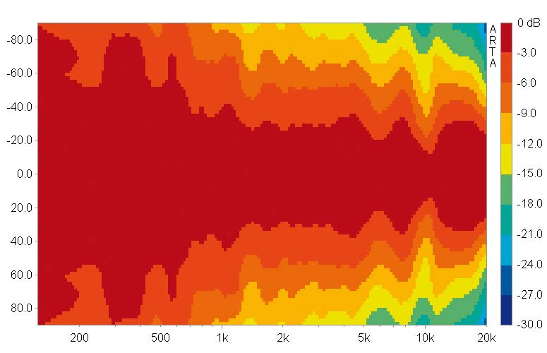

Joseph posted offaxis plots of the horn and 4 driver array in the thread before, that 5K dip is present in all of them.
attachment.php

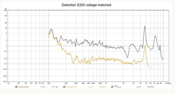

I had a look at Joseph's blog page on the setup
ScanSpeak/THIEL 10F/8424G02 4" Fiberglass Midrange in E-250 Horn – Joseph Crowe and I found an answer to the level question, measurement was taken at 80dB, distance does not seem to be quite as far but the picture could be deceiving.
On that same page is a distortion graph that shows a big spike at the same frequency as the dip
attachment.php
The most likely causes from looking at the layout to me are either a cancellation from the front chamber created from the horn overlapping the drivers or the single divider between two drivers. It does look as if the horn was designed for the Neo ribbon for which it works very well. A phase plug per driver would most likely bring improvements. A full line rather than a truncated one would also help.

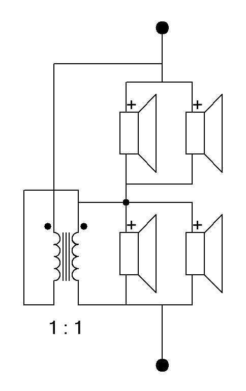

A fellow Dutchmen built a small dipole array with 4x VISATON FRS 5X and used Oasis (floral foam) as 'rear chamber'.
The transformer was used to match the impedance between the drivers.

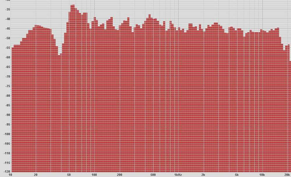

In room TrueRTA measurement of the same dipole array, 1/12 oct.
I hope this doesn't sound dismissive but that type of measurement tells me very little about the speaker 🙂

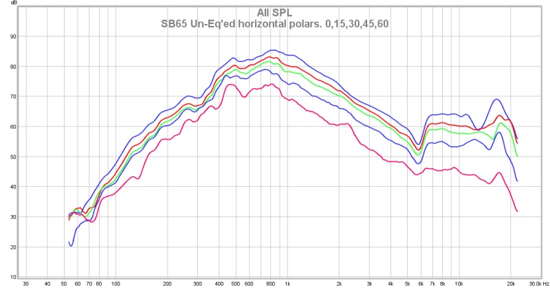

The dip, that is present on all off-axis angles reminds me of the Bookshelf Multi-Way Point-Source thread.
Here's a smaller SB Acoustics SB65WBAC25-4 fullrange driver on an 18 sound waveguide:
https://www.diyaudio.com/forums/multi-way/285030-bookshelf-multi-source-horn-19.html#post4581936
524988d1452800210-bookshelf-multi-source-horn-sb65-power-jpg
And after EQ:
https://www.diyaudio.com/forums/multi-way/285030-bookshelf-multi-source-horn-20.html#post4582003
He was able to get it to look like this:
https://www.diyaudio.com/forums/multi-way/285030-bookshelf-multi-source-horn-26.html#post4583417
525313d1452896913-bookshelf-multi-source-horn-freq-dependant-gating-5-cycles-jpg
By reworking the throat area of the horn and using some other tricks. I think a similar recipe might work here.

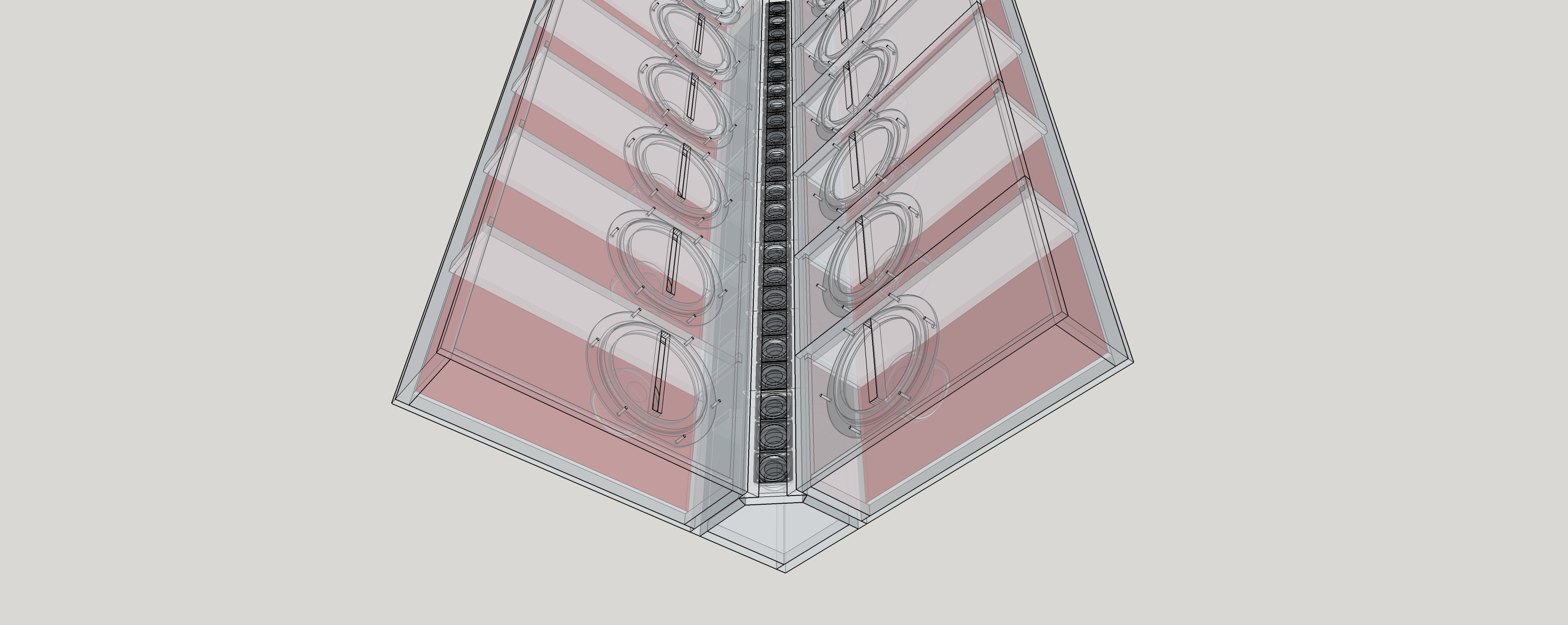

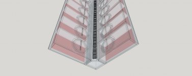

A interesting idea, and something I like to investigate further. I'd be happy if you guys could elaborate on this a bit more?
The basic idea is to put a line of woofers or mid woofers behind the horn walls feeding sound through holes in those walls so you can offload the fullrange drivers from 200 Hz where their excursion generally begins to rise on down. The CTC between the woofers and the full range drivers will be small enough so you can get a truly seamless crossover and the combination will be perceived as a single line. Dynamics will be improved as will the bass response....
Whether or not those are needed improvements for a subwoofer assisted line of TC9s is debatable, depending on your room and listening level among other things. But the concept does allow the use of smaller drivers with improved treble dispersion that are not as robust as the TC9 in the low end. And it can reduce the overall footprint to include sufficient woofage to reach down to 20 Hz w/o subs. To say nothing of the acoustic and visual dramatic impact of a really powerful truly full range system.
here is an xray view of a rough concept with 1.5" full range drivers and 6.5" woofers. the woofers hug the side of a murphy corner style full range array cabinet and form a 90 degree corner horn. The mouth of the horn needs termination. Nothing sophisticated has been done in the throat....but it shows the basic structure.
