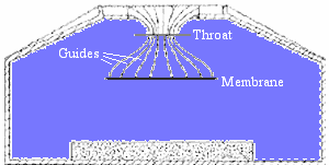

It kind of looks like a Beveridge lens without the guides:
technical_details
attachment.php
I share some concerns with fluid about this proposal. Basically we are creating a front chamber and have sort of a diffraction slot. The Beveridge lens shows guides and used a flat source, not cones like we do.

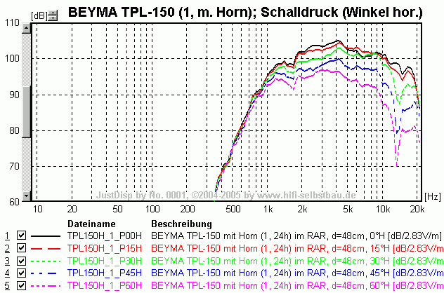

The Beyma TPL 150 would be sort of like a short array shape (long in vertical direction, short in horizontal) and have some vertical directivity to work with. But it won't be easy to hand off from that to the arrayed drivers. If I were to try or pick a tweeter it would be either something like that Beyma (rectangular shaped) or a short array of small tweeters.

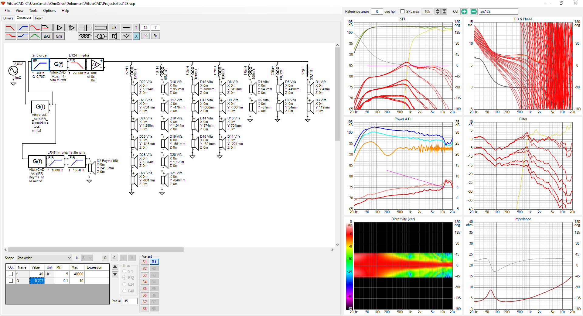

Digging into Vituix and try to implement the Beyma 150 as central tweeter flanked by 13 Vifa:s on either side:
(how can I make the pictures showing in correct size? When using the Attachment feature the just show up as thumbnails..?)
Looks like it could be made to work. Pretty big inductors...😉

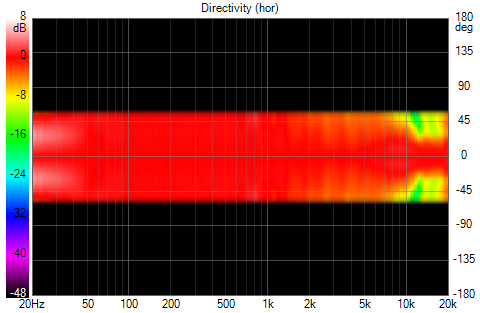

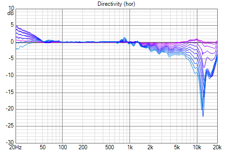

What does the horizontal wavefront look like? Curious to find out what the jump in directivity above 10K means.

There is a narrowing of the horizontal directivity above 10K which explains the jump:
attachment.php
attachment.php

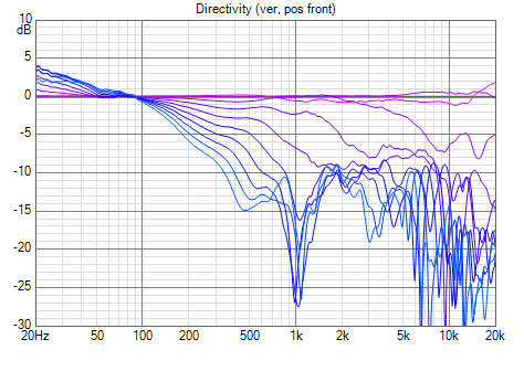

The vertical directivity looks like this (5 degree increments):
attachment.php
I was working with adjusting the inductances to have as an uniform response as possible within a +/-10 degree vertical window (which should cover both seated and standing) and at the same time keep it narrow for avoiding ceiling and floor reflections. Lots can be done here by adjusting the phase relationship between the drivers!

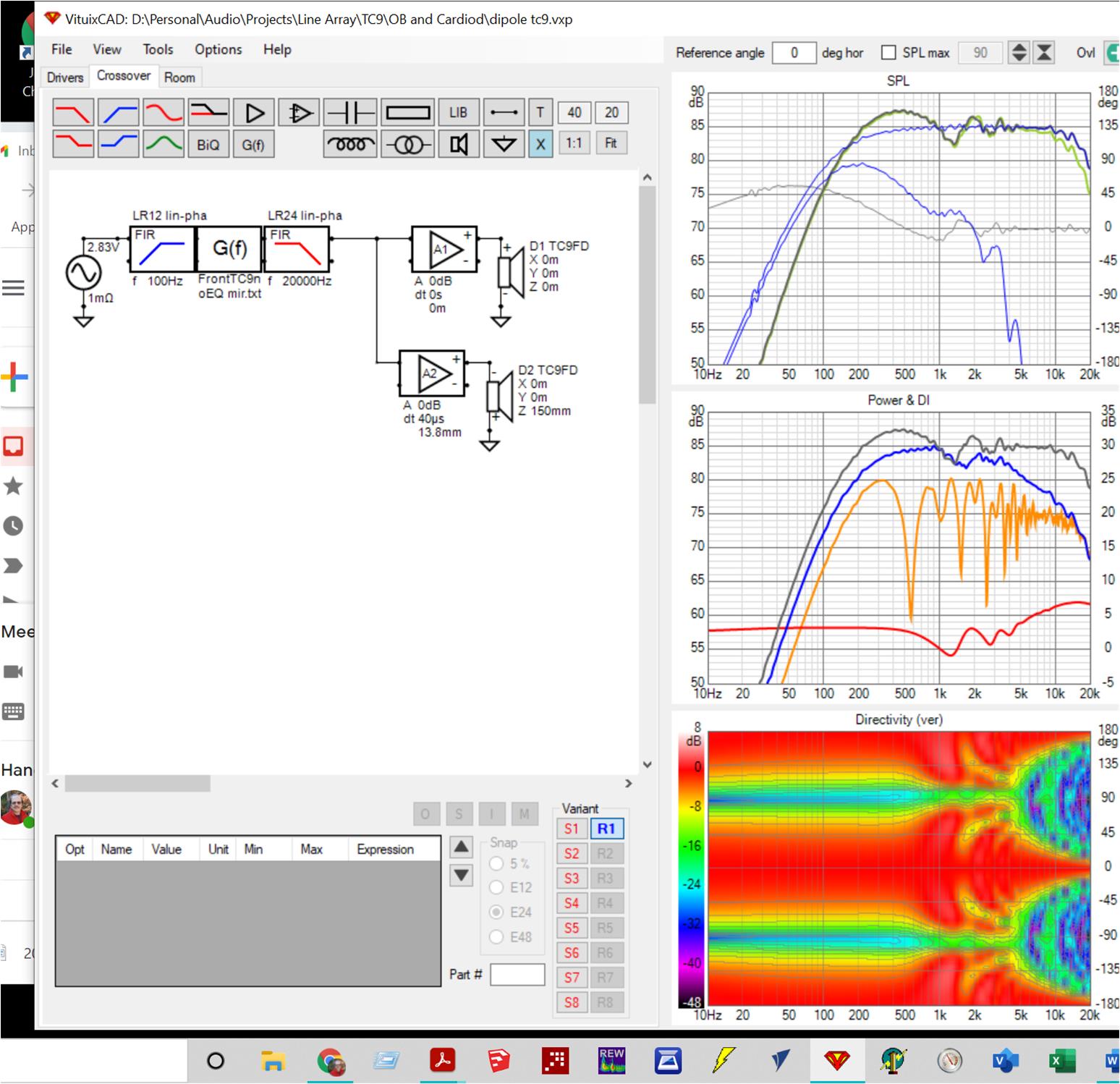

As to beam steering, what I found most effective in keeping sound off the sidewalls in simulation was modeling the Vifas as dipoles. The in-simulation caveat is caution about the potential effect of nearby sidewalls on the dipole effect.
In my sims, I had a lot of trouble maintaining flat response that far off center. This led me to placing the tweeter at ear height rather than array center. OTOH, I was optimizing for smoothness rather than averaging over a vertical window.
Can you model dipoles in Vituixcad? It would sure be interesting to have a look into it.

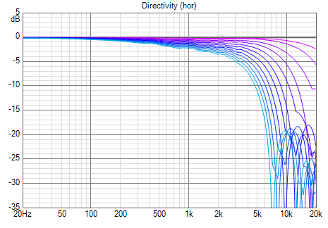

Found the diffraction feature in vituix and made a quick simulation of a single driver in a 10 cm wide baffle.
Horizontals in closed box (5 degree increments up to 60 degrees off axis):
attachment.php

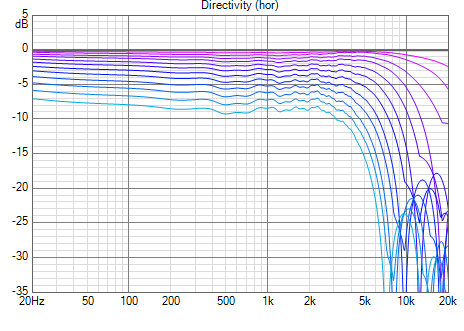

Same with open baffle:
attachment.php
There is for sure some potential there. As I still need to have the speakers close to the corners I would probably need lots of absorption behind the open baffles to absorb the backward wave... Hope to get some time to do measurements soon!

Nice driver, too bad you can't buy it. Point the tool at a real driver clicking in the file icon next to half space response in the lower right corner...
Use SPL Trace tool on data sheet if you don't have a measurement.
