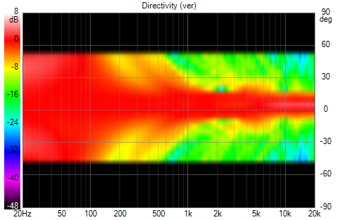

I checked the settings in Options and the Angle step was set to 15 deg, producing this polar:
Reducing the Angle step to 10 deg:
And then to 5 deg:
Maximum SPL is thus 5 degrees above listening position (about 2.5 dB more than in the seating/design position):
So, the SPL is at maximum in between the seated and standing position. Maybe the results now are more as expected...
We should keep in mind that this is interpolated data (measurement were only at 0, 15, 30, 45 and 60 degrees). When the drivers arrive I will do a set with more closely angled measurements.
Pfew, that really does make a difference. Hope to see some real life measurements soon!

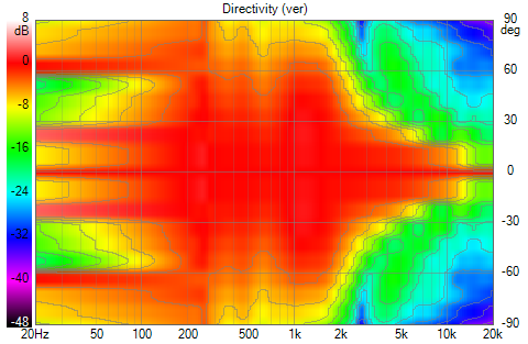

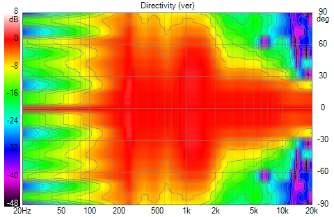

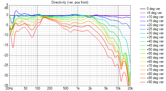

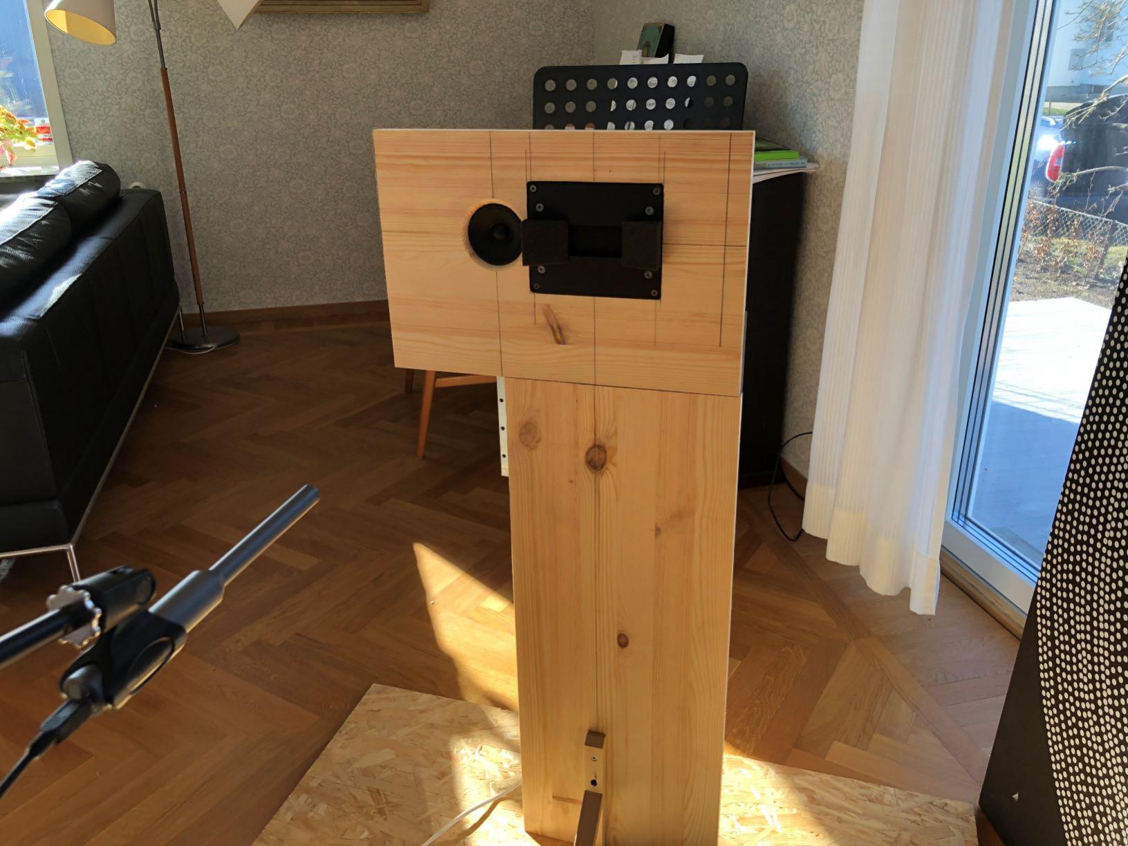

The Beyma 200/B:s have arrived and I finally got some time for directivity measurements:
All measurement were made with the mic 60 cm from the baffle and a 4 cycle FDW was used.
Measuring vertical and horizontal response in 10 deg increments from 0 to 90 degrees.

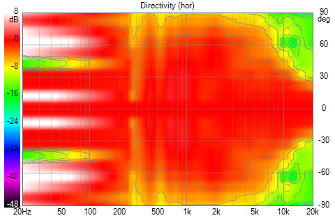

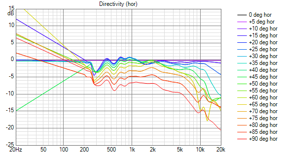

Normalized horizontal response for 200/B:
Giving this polar:
Much better I think! 🙂
The foam wedges results in a loss of sensitivity, but as the sensitivity of these drivers are so high this would not be of any concern I think.

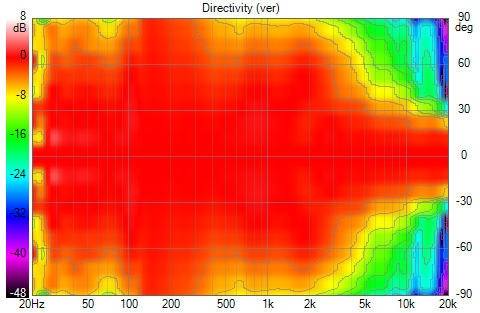

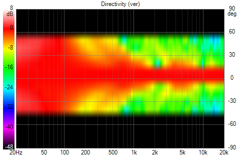

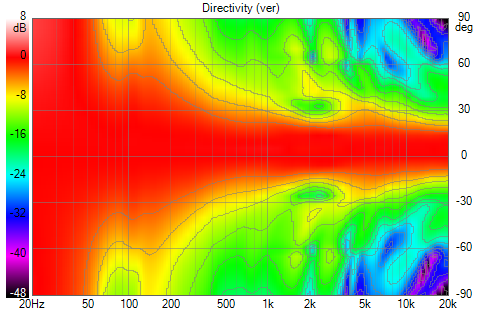

In the vertical direction:
And this polar:

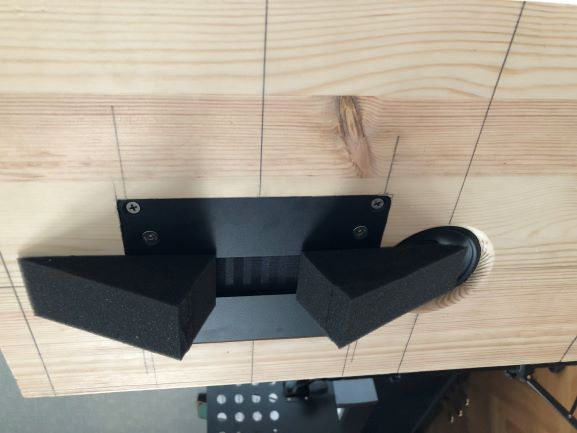

It gets super narrow in the top end... so I did some experiments using foam wedges to physically "shade" the driver. The most promising looks like this:
Now, the response gets as this:
Giving this polar:
Pretty nice I think!

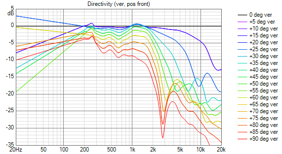

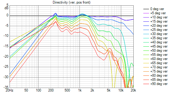

For reference, here are the results for the Vifa TC9F:
And polar:

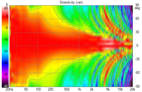

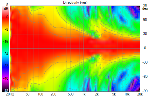

I made lots of more measurements with different variations of that foam wedge, and this looks even better:
Which gives this polar:
My best effort yet for the array (without the centre tweeter) have this polar:
It looks to that the best place to mate these two is around 3500 Hz. With 2nd order linear phase filters at 3500 Hz I get this polar:
Response like this:
While I think it is a good start, I'm not happy yet - the directivity dip in the 3-5 kHz range should be evened out. There are so many parameters to tweak in Vituix, both passive components for the array shading, filter slopes and things like phase eq:s etc...

The vertical is very narrow because of the length of the driver. A combination of a waveguide like that to control the horizontal together with the foam wedges could help tailor the directivity in both directions and maybe avoid the lumpy polar you get from a mismatch between the line and the AMT.Yes, interesting. But the second image shows a very narrow needle like response, or do I miss something here?
smoothing the directivity between array and waveguide has been the conundrum in all the like vituix simulations I've done. The best handle I've found is varying the XO filter slopes which indirectly controls the overlap and the overlap itself (different corner freq between high and low pass) between the narrowing array and the widening waveguide. Finally the array characteristics matter. IIRC, a line array narrows too quickly; an expanding array where the CTC doubles from one MTM pair of element to the next does better. My best results have been expanding array where the 2nd element is an small array that covers most of the distance from where it starts to floor or ceiling. One of the benefits of that is the same/similar low frequency pattern control as from a line array.

I believe the proof how smooth it really is, is clear only when you do check out the heights of interest. So you'd need to move the mic position relative to the speaker and check it's output. As the mic is fixed at zero, you need to move all drivers relatively to the mic (using the driver Y offset) and alter the floor and ceiling distances to correspond.
So if you use a distance of y=-100, subtract 100 from both ceiling and floor numbers, you have moved the mic 100 mm upwards, etc.

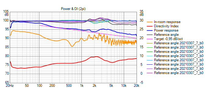

Something like this?
I moved up in 100 mm increments until +800 mm, which would be my standing listening position. Sorry for not naming the traces, it's hard to follow from the label. It's not super bad I think, but surely it could be better! 🙂
EDIT: Ah, I now see that it was the in-room prediction curve I was supposed to save...
lol, yes... floor and ceiling add to this game for the predicted in-room results.
But it doesn't seem to give bad results! The tweeter holds up nicely even if it is shelved down a bit.

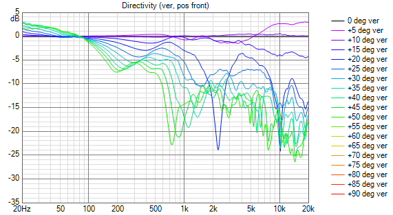

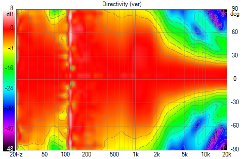

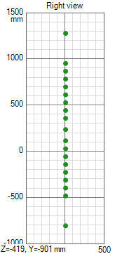

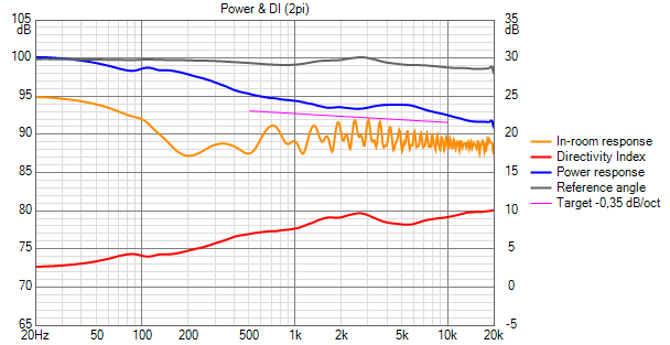

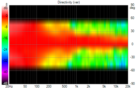

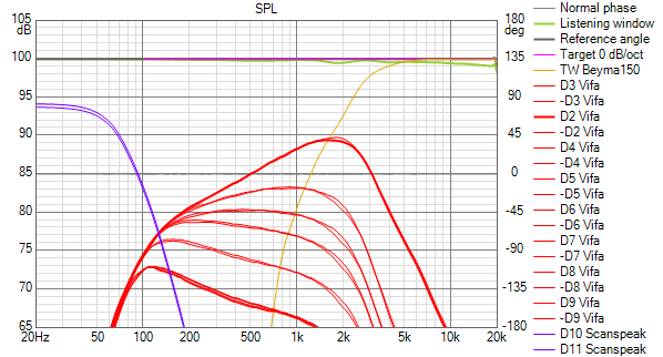

Here we go again! Lots of simulations and trying to get a good combination of smoothness in directivity/power response, coverage of the vertical listening (reasonable good response at standing position) and trying to minimise floor and ceiling reflections. This is where I am at the moment:
Polar plot. Note that the tweeter is positioned in the middle between floor and ceiling, which is 242 mm above seated listening position:
SPL curves of the drivers:

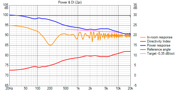

I have now replaced the four outermost Vifas in the array for 2 12" subwoofers (thinking of the same drivers as Wesayso used for his subs). 16 Vifas left, 8 above and 8 below the tweeter:

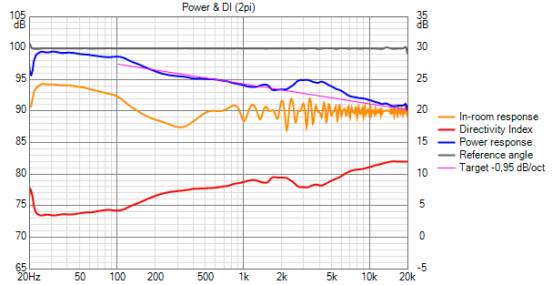

Power and DI plot:
Now, moving up to standing position we get the following:
I think I'm getting close to something useful here.

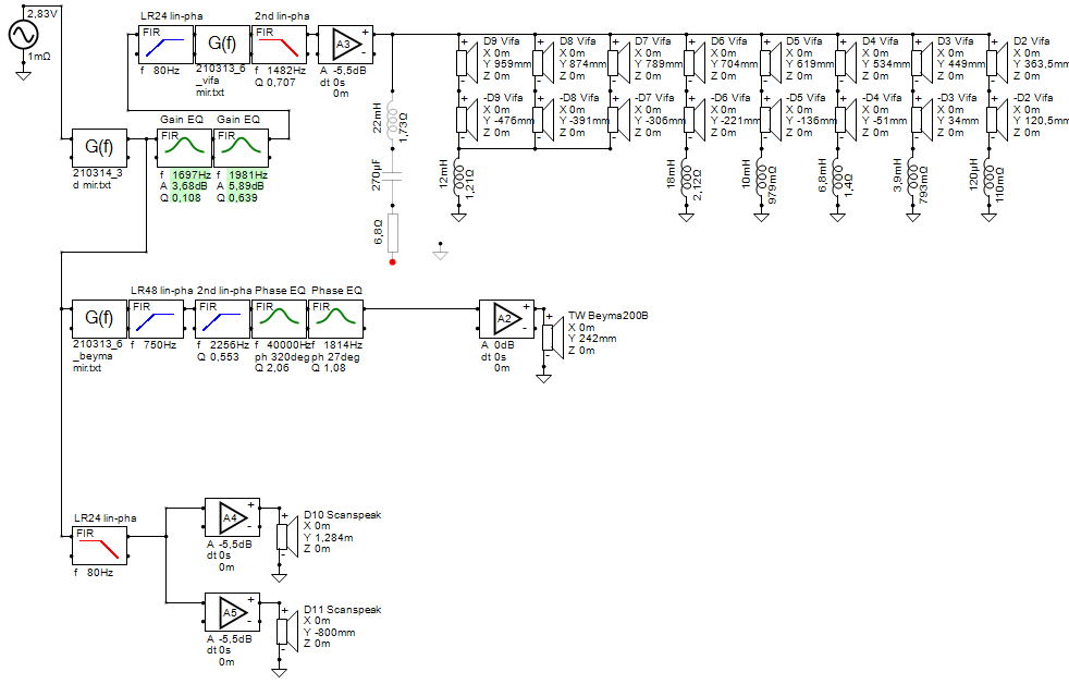

The schematics looks like this:
A key here was to make a gradual phase turn on the tweeter up high, and also some phase eq at the "cross over". I know that the wiring of the Vifas results in a pretty low impedance (about 2 Ohms), so I will do something to fix this also. But I start to like what I see here! 🙂 What do you guys think?
Power and DI plot:
