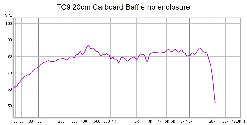

Just for comparison this is what I measured from a TC9 in a cardboard baffle at 20cm to avoid dipole and reflection effects.

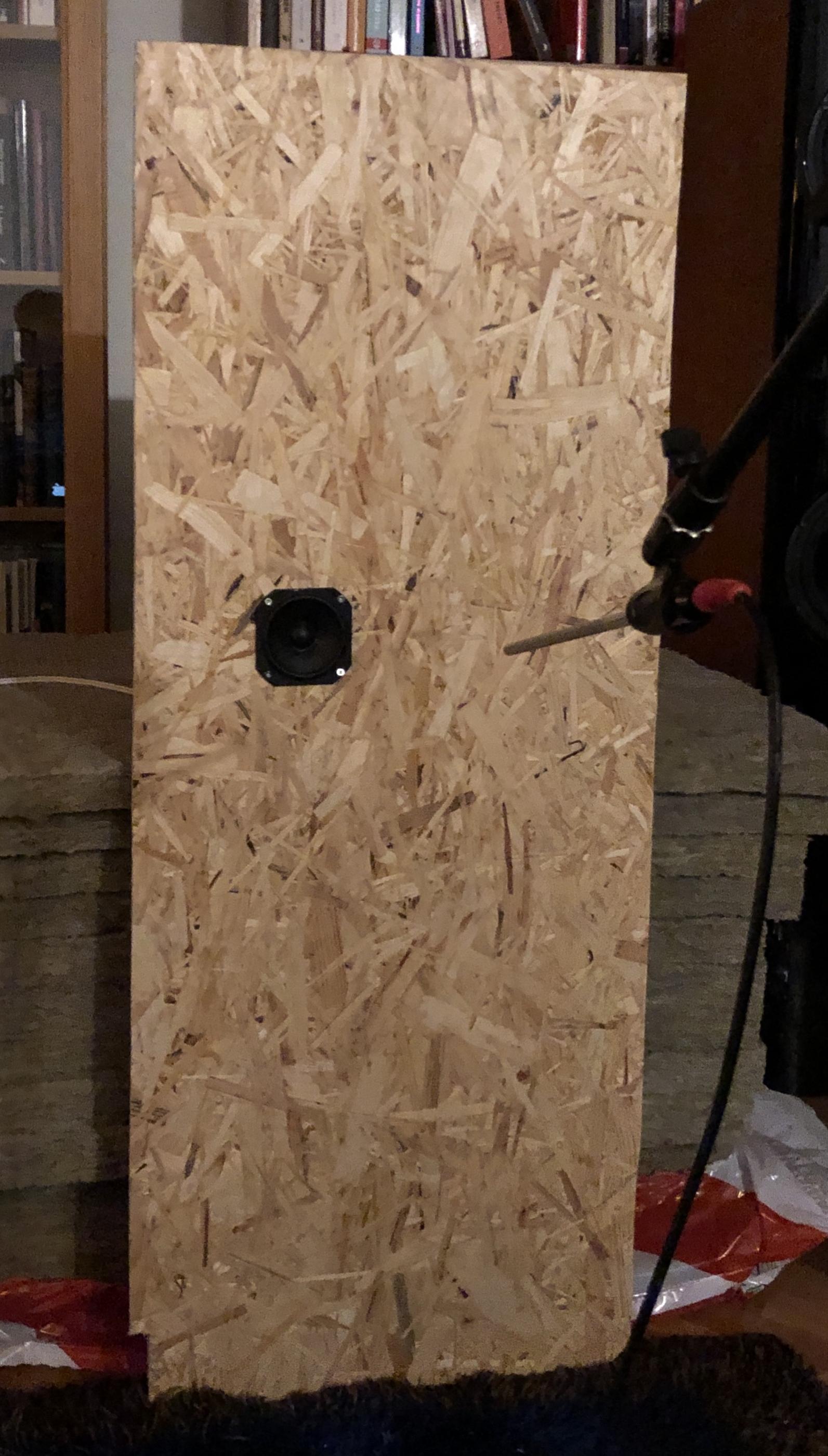

I'd concentrate on getting a clean measurement of a single driver, away from walls like the one fluid showed and next bring it into the corner for a few tests.

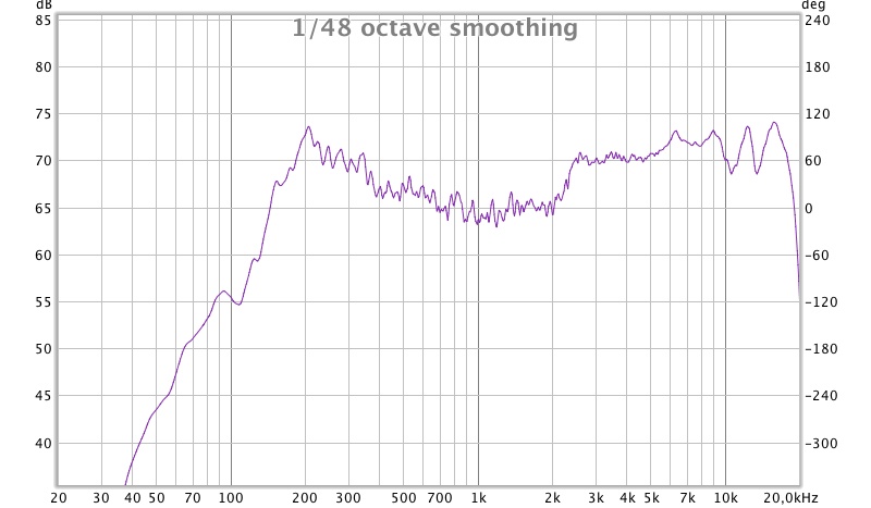

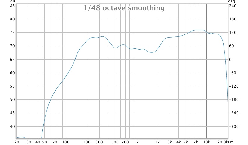

Here's a measurement at about 30 cm, away from objects:
Large time window, 1/48 smoothing:
The frequency response differs quite a bit from what fluid posted:
Any ideas why?

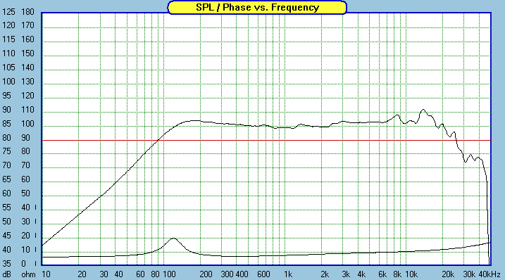

A guess would be simply production differences. They can actually vary quite a bit more than what people normally assume.
The difference in falloff around 200Hz is the most glaring to me, the rest looks like rounding and optical differences between the curves.

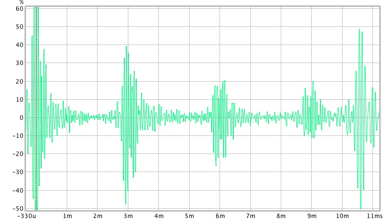

Well, I don't really trust the measurements to much at the time. Now I have som serious problems with the measurement setup - lots och clipping and distortion, some kind of feed back loop. When I turn the gain up on my mic amp there is noises coming out of the speaker. Even when turned down a bit to avoid clipping the impulse is looking like this:
Can't figure out what the problem is. Tried to change outputs and inputs on the sound card and different settings, but it's stuck like this..
No way it's going to make that much of a difference. Al least not with the batch I have.
Something else must be wrong, the IR isn't particularly clean either.
There's lots of TC9 measurements around, most of them look like fluid's example.
A couple of samples:
Vifa TC9 - 3" Midrange/Widebander REVIEW/Measurements | DiyMobileAudio.com Car Stereo Forum
https://www.diyaudio.com/forums/full-range/268626-vifa-tc9fd18-08-bang-buck-21.html#post4247669
2 samples from Zaph Audio:
https://www.diyaudio.com/forums/full-range/276429-fullranger-alert-tang-band-3-4-a-3.html#post4374856

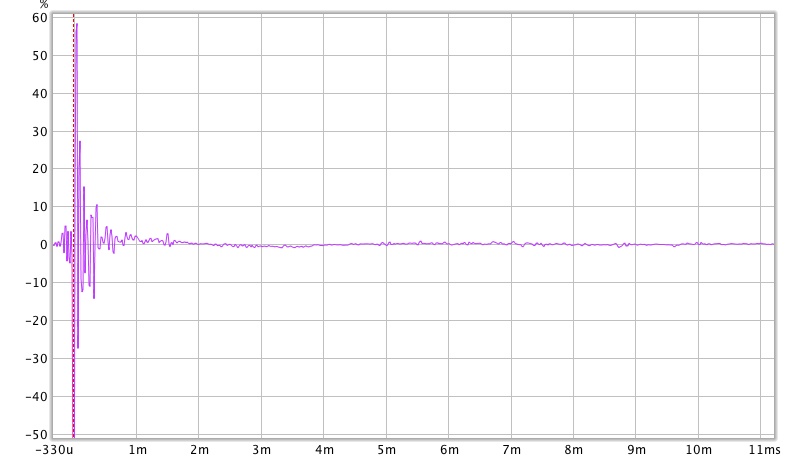

And an IR as example from XRK:
See what I mean with a clean IR? This was measured at 0.5 m.
Lot's more of these plots are available, none show that much deviation though. Could you state what the measurement setup looks like?
That top end of yours shows combing, the big hole at ~1100 Hz of more than 5 dB should not be there...
I'm not buying the lines from Squeak, even when comparing the used grit, 5 dB steps vs 10 dB on some plots, just look at how much flatter they all are pretty flat compared to Crumboo's results. Clearly XRK's FR measurement was gated though. But the IR from him is a good sample of what it should look like.

I figured something had to be off. What mic and measurement setup? Maybe we can find whats at fault.
