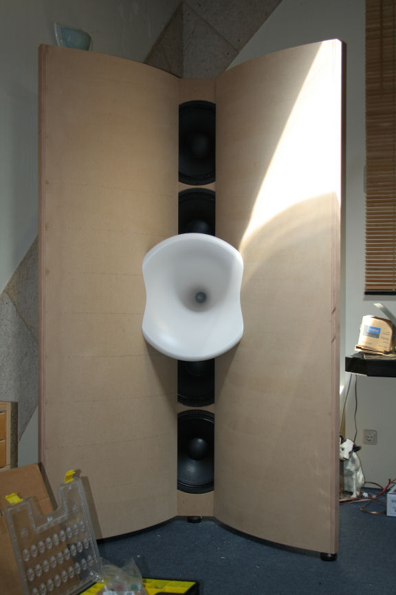

What does a your horn look like? It would be interesting if it could be made to work with a full line of drivers, the TC9's crumboo has are not wildly different to the scanspeak drivers.
It's the E-250 Front Horn which is available as plans to download. The madisound Thiel 10F/8424G02 are not longer available so it would need to be the standard version (10F/8424G00) or something similar. Distortion on the 10F is lower than even the BG Neo8 in the same horn.
E-250 Front Horn 3D CAD Files + Drawings – Joseph Crowe

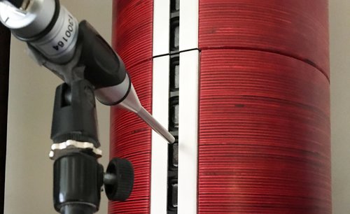

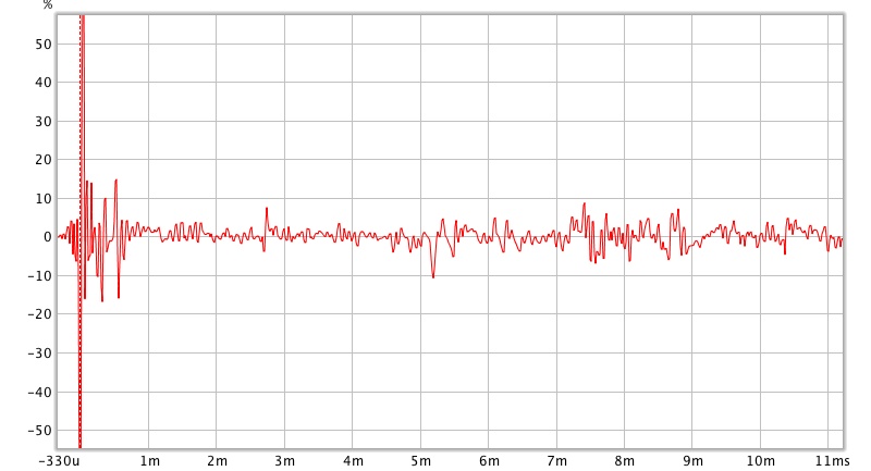

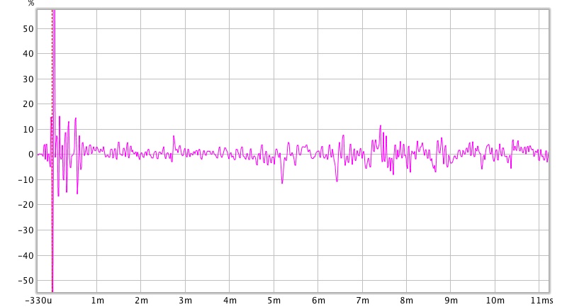

So here are some very preliminary measurements. One driver attached to a crude open baffle just to have a look. For the next measurements I will attach some box on the back side of the baffle. But still maybe som conclusions can be made from these first measurements. All measurements are done in the same spot (listening position).

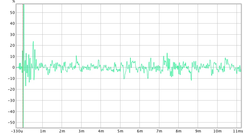

First, impulse response without any absorbers at all:
Some pretty strong very early reflections (< 1 ms).
Next, 45 mm absorber against the left wall (as in the above picture):
Reduced level of reflections up to about 6 ms.

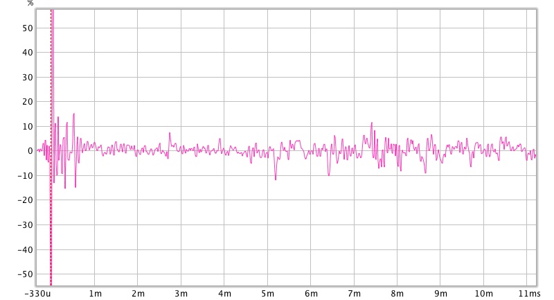

Now, like above but with absorber on the baffle to the right of the driver:
Not much of a difference.
Then, turn the right absorber so that absorbers form a V-shape with the driver in center:
Some reduction of reflections above 7 ms.

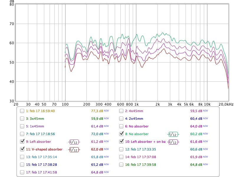

Lastly, frequency plots of the above (with separation), with 1/12 smoothing:

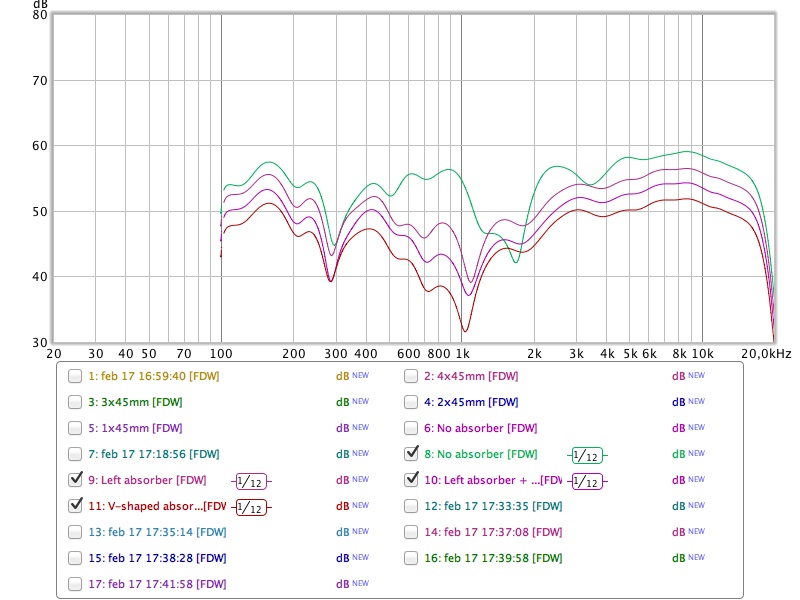

And the same with 4 cycle FDW:
Why the big dips in the response? The dip at 285 Hz may be due to destructive interference from the backside of the driver I guess. The other dip seems to move when the absorber on the left is added...
I will not draw much conclusions of this yet, more testing is needed (with a closed box!). Absorption on the wall seems as a good thing with respect to the impulse plots tough. Next I will try with a double layer of absorbers (90 mm) to see what difference it could make, if any. Since it's only one driver on the baffle there is probably some reflections from the ceiling in these measurements as well (I put some absorbers on the floor between the mic and speaker in order to reduce floor reflections).
Build the lines - then experiment with damping, horn... etc..
You will have a really hard time making anything out of these test vs how the lines will behave. Still, it could be fun!
FDW will show you more of the direct sound where the overall non windowed response will show you how the reflections fill in those gaps. To see the reason why look at the spectrogram in REW to see the response change over time or use the filtered IR to see what is happening to the reflections at different frequencies, as a plain IR or full band ETC will be dominated by high frequencies.

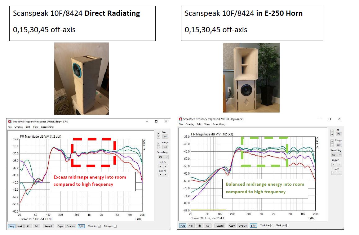

Here's a comparison that illustrates what I'm referring to. I've highlighted the midrange off-axis response and how a front horn drastically alters the power response into the room which has a significant effect on the perceived tonal balance. I should note that the 10F isn't much different than a regular dome tweeter's off-axis characteristics.
Crumboo, let's see what an enclosed driver can do. Maybe first well out of the corner away from any walls to get a base line.
Next we will look into what it does in the corner with different placement options.
Joseph: impressive! That's quite the transformation. Is that one or two drivers behind the horn?

A shallow slith opening has been used before on arrays:
818093d1582048713-corner-line-array-28-tc9fd18-ruel-jpg
818092d1582048293-corner-line-array-28-tc9fd18-ruel-speaker-jpg
Ruel R+
Thanks for posting the Ruel R+. I'd seen it before but lost track of it. The diffraction slit in front of the line is something I would like to try. Except for that though, the construction looks very much like yours. So they are a way to quantify your sweat equity. I wonder though how much market there is for speakers at $50K++ per pair.
Each horn has four drivers. The rear chamber is reflex tuned just below the cutoff frequency of the horn. This controls diaphragm movement outside the horn’s pass band. There’s a 50% reduction in %THD when using the rear chamber across the lower midrange.
Subjectively it reproduces some of the best midrange I’ve heard. I’m using it from 250Hz-20Khz.
