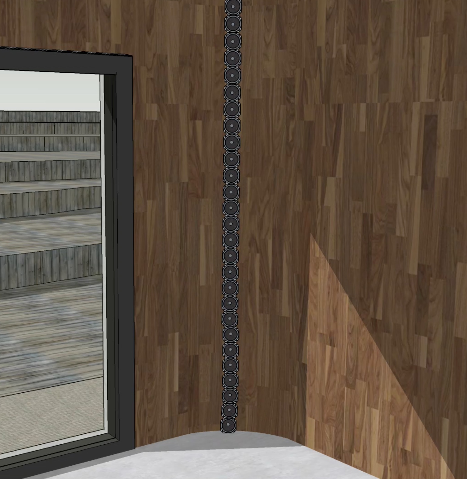

Another corner line array, 28 TC9FD18

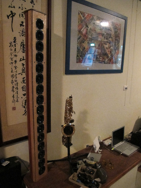

A few years back...
They were on the long wall, quite away from any corner, and in listening position, they were pulled in about 1m from the wall behind.
These were not floor to ceiling, mirror-image line arrays, so they were missing some advantages there. Your head had to be placed within the line.
Also, at 16 drivers per line, they needed subwoofers for bass duty.
Still, they were loads of fun.

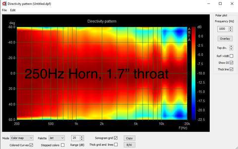

I suggest a throat width of 1.7” and use at least four drivers per horn.
This will provide decent treble coverage. I suggest a horn with a 250Hz Fc. This will provide the necessary off-axis pattern control.

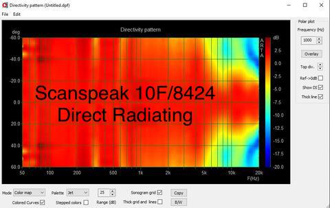

I’ve attached off-axis polars of the Scanspeak 10F/8424 in such a horn versus a non horn setup. The driver’s power response into the room is much more balanced with the horn resulting in good overall timbre. The non horn sounds like it’s overly aggressive in the midrange despite efforts to flatten with PEQ.
Also, once you’ve applied PEQ on the horn the resulting %THD will drop to around 0.1%. The best I could do with a non horn configuration was around 0.8%.

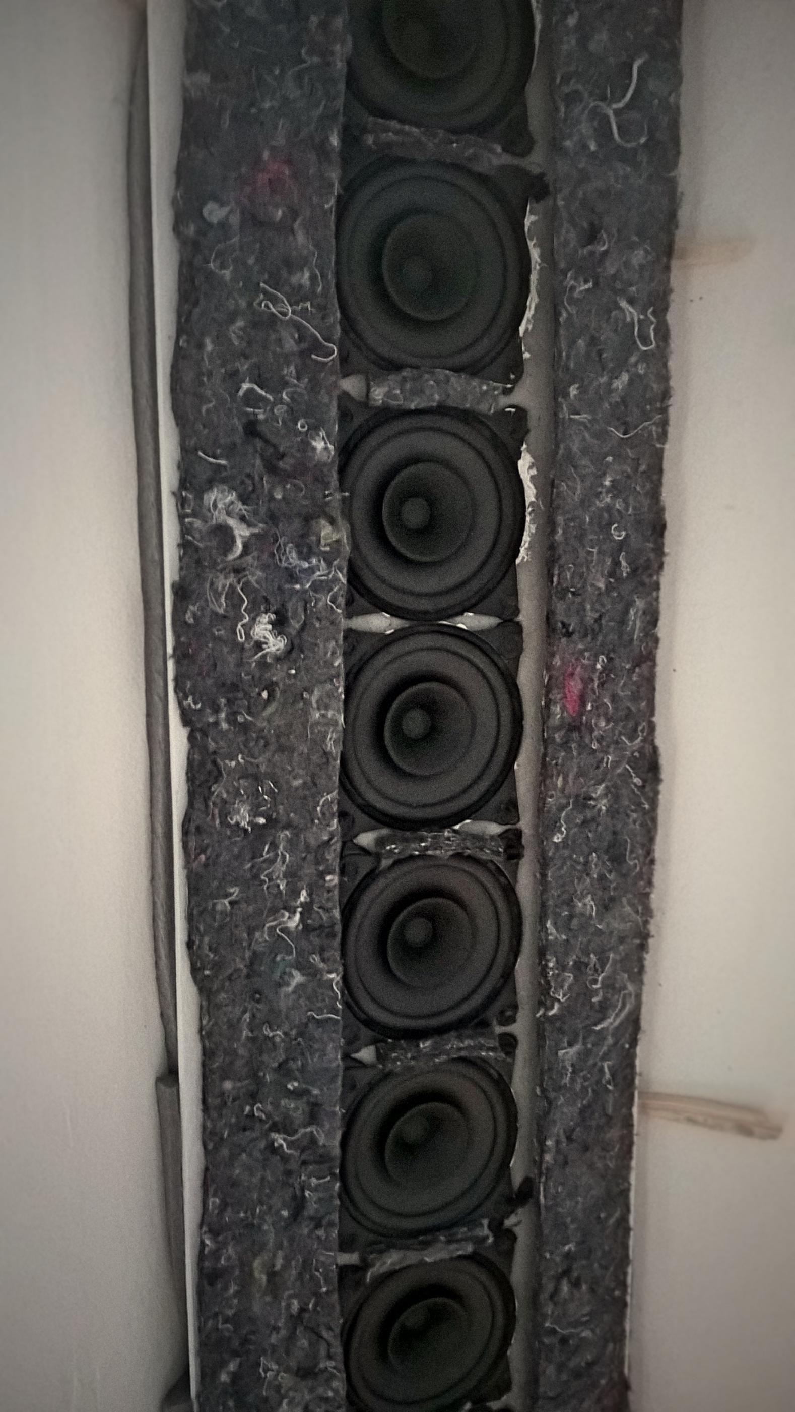

I have tried a number of different setups with damping using felt fabric say 12mm thick. Wider and narrower pieces close and further away form the lines (2-30cm). Also on the baffle itself touching the side of the drivers (pic!). Now I play without any felt damping. In the end it was the best. It could be brutal but I have found ways to improve my electronics but more importantly worked with EQ. Just ordinary PEQ as I do not have access to enough power for a FIR party. My drivers are very cheap but the lines have superseded my expectations and they do some thing really well.
I will in the future most probable build a new pair. The baffle will be concave, maybe elliptic!? (pic2) This is to create a seem-less surrounding to the line, just a completely smooth transition to the side walls with no vertical edges or angles whatsoever.

My goal here, or what I really wish to achive, is to reproduce the musical event as true as possible (well, that's what hifi is about isn't it?). I would like the front part of the listening room to dissapear leaving an opeing to the concert hall/stage. I listen alot to classical music: big orchestras, smaller ensambles, organ and choir. But then also more intimate jazz settings with only a few musicians.
I think, in my situation and room, that full range arrays have the potential to get me there. There is not enough room for big free standing multi-way speakers anyways.
You guys have so much experience than me on this subject, so I really appreciate all helpful comments and discussions. Then of course I need to make up my own mind in the end.
So here is a challenge ;): Given my room and other conditions - what would you do/how would you design (speakers/room) to reach my goal?
I think the arrays can get you to where you want to go too.
My experience matches in with most of what I have read from a number of different sources that lateral reflections that occur within 6ms of the direct sound are the ones than are likely to cause timbral degradation. As these are fused with the direct sound and cannot be separated as separate events like the ear can do with later arriving reflections. Avoiding those can be achieved by having more than 1 metre distance to any reflecting surface making the overall path length difference 6ms plus. Full range arrays need to be closer to the front wall for reinforcement 50cm from wall to front baffle has always worked the best for me for the uniformity of response below 200Hz.
In your setup that is not so practical so you are left with directivity or absorption to deal with them. Which is where your original idea stemmed from.
If your main musical listening is to classical, jazz and acoustic styles then I would advise against too much damping overall as these are the types of music that are much more tolerant of reflections and can often benefit from them (still trying to avoid the sub 6ms ones).
Using the ambience channels for an artifical Haas kicker is another way to inject back some of that room sound while also making it controllable. Maybe you have the space to make that work worth thinking about at least.
You may be able to make a free standing array and place it further out from the bookcase to peek out much like wesayso has done from his right hand niche, you could then meaure in situ and damp the areas that need attention. Angling the speakers to point directly at the listening position can have a beneficial effect in that the direct sound field is stronger that way and you benefit from the natural drop of of the TC9 at offaxis angles. 75mm fibreglass of medium density with 10mm felt over the top and an air gap behind is a pretty good panel for reflection control at least down to 500Hz. Making the panels only as wide as is needed to control the reflection can also help to avoid making the room overly dead, they do need to be full height with an array to have maximum effectiveness. From my own experience a few panels in strategic positions makes things quieter and more controlled without making the room feel uncomfortable or dead.
Yes, please tell us more about those horns. I have no experience with horns and not very familiar to the advantages/disadvantages with them.
Thank you. I have also been thinking about a concave baffle to get a really smooth transition to the side wall and book shelf. With a stacked design (and a friend with a cnc router) any shape should be possible. It should smear out the very early reflection making it less prominent I guess.
