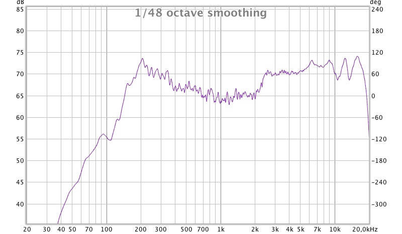

Here's a measurement at about 30 cm, away from objects:
Large time window, 1/48 smoothing:

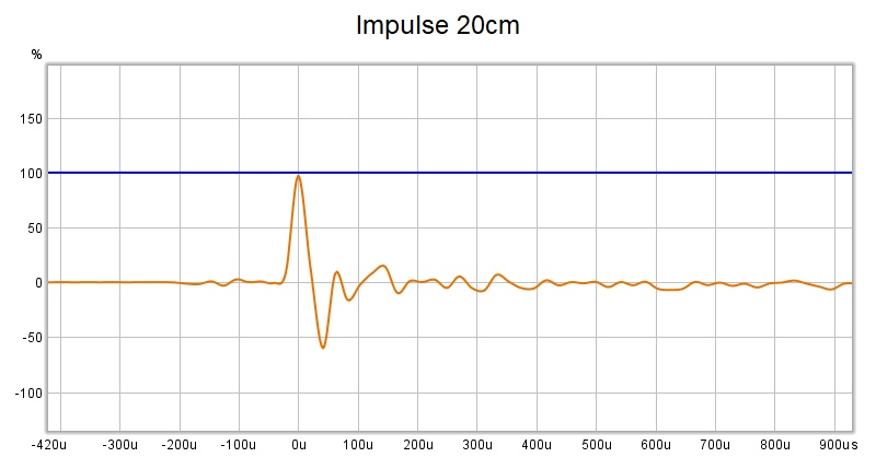

Here is mine a the same scale as yours to try and avoid the optical skewing 1/12 smoothing
Zoom in on your impulse to have a look your time scale is too long to see what the differences are but you have avoided reflections from further away well enough, a small one at 1.5ms, looks quite messy before though
This is mine and is pretty clean, you can also tell that from the phase above
I would say mainly baffle because yours is quite different to mine, and you are measuring further out, 10cm further might not seem like a lot but it is for baffle effects try it at 20cm centred on the baffle to get a closer match to mine.Any ideas why?
A guess would be simply production differences. They can actually vary quite a bit more than what people normally assume.
The difference in falloff around 200Hz is the most glaring to me, the rest looks like rounding and optical differences between the curves.

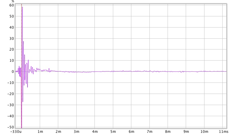

This sounds and looks like feedback to me. Are you using Java or ASIO drivers in REW and what does the control panel of your interface look like?When I turn the gain up on my mic amp there is noises coming out of the speaker. Even when turned down a bit to avoid clipping the impulse is looking like this:
Can't figure out what the problem is. Tried to change outputs and inputs on the sound card and different settings, but it's stuck like this..
I tried all sorts of different cables, settings etc. but couldn't get reliable results. I guess that's something wrong with the sound card. Just ordered a UMIK-1 instead so I can bypass the sound card thing. I'll be back!

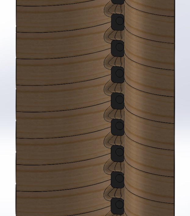

Backing up to the discussion of diffraction slot, I have some simulation results that will be of more interest once the measurement process is conquered.

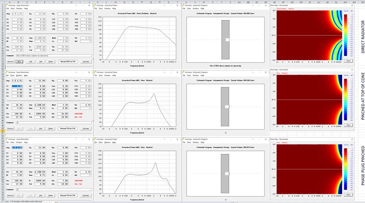

I'm simulating directivity of a flat piston with same Sd as TC9FD. The light grey lines in the frequency responses of the lower 2 rows allow their response to be compared to that of the direct radiator.
The first row of the picture is a direct radiator. It starts narrowing at 5 khz and has full range response only to about =/- 15 degrees.
The second row shows what happens if we place a disc over the surround with a hole only 8 cm2 area, just under half Sd. Beamwidth just about doubles so we get full range response out to about +/- 30 degrees BUT we also create a bandpass chamber whose acoustic low pass filter severely attenuates the HF.
I've estimated the volume of the throat chamber as having average area Sd/2 and a depth of 2cm. I assume below that the phase plug there is a gap of 4mm and same average area.
In the third row, I hypothesie a phase plug that fits over the TC9 and follows its cone with a gap of 4 mm to allow for its excursion. There is still a bandpass effect that can be equalized out but we don't lose any treble.
Such a phase plug is an obvious candidate for 3D printing. Make a solid that fits over the driver using its mounting holes and conforms to the cone surface with a cap. Drill a vertical tunnel on axis of the desired diameter. Make several radial slits at intervals up the tunnel to feed sound in from the sides...
Yes, I know that is easier said than done but also likely much easier to do than a Berstis lense. The benefit should be a wider sweet spot and elimination of the need to point the array directly at the primary LP.

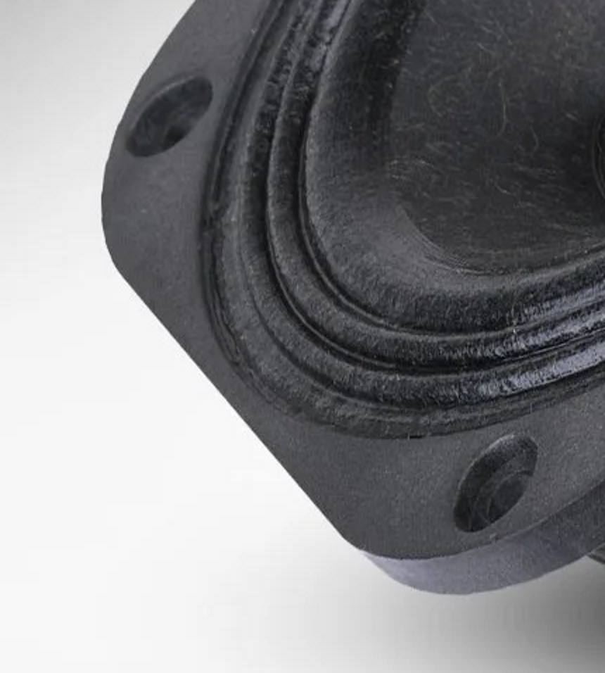

As I am somewhat allergic to roll surrounds, I'm looking for full range drivers with multiple wave accordion surrounds.
These offer at least 2 advantages:
- There's no surround sticking out, which makes mounting easier.
- Accordion surrounds usually go hand in hand with higher efficiency/sensitivity at the price of lower excursion (and higher Fs), which isn't troublesome in this case.

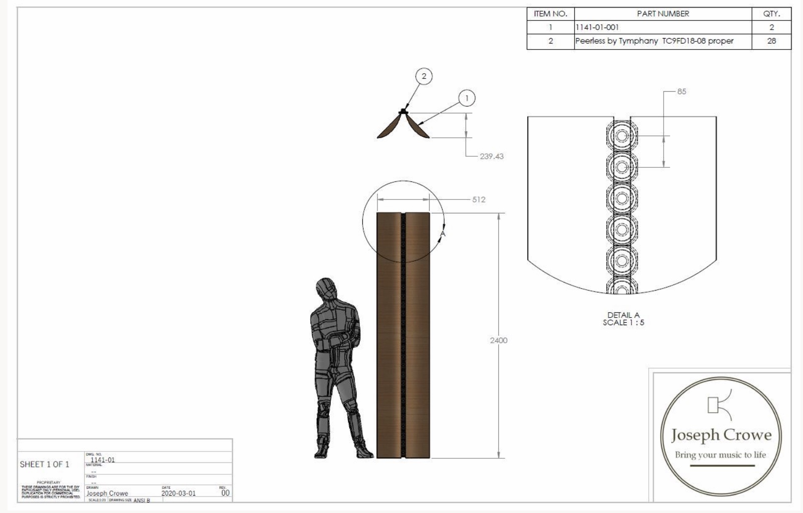

Hi all,

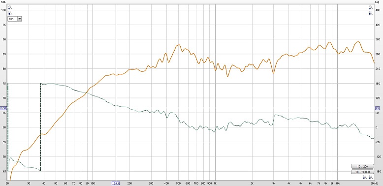

New measurement gear has arrived and I now have reliable measurements, with frequency response and impulse response looking as expected.
Meanwhile, Joseph has offered me a quote for a horn design for the array (see pictures which are a quick draft of the design). He also suggested the use of phase plugs to eliminate the cancellation effects in high frequencies. I do like the design and think it will fit perfectly size-wise on the sides of the book shelf. As of now I lean towards letting Joseph design the horns and use his CAD drawings to make a prototype for testing. What I’m not sure of is how wide/narrow dispersion that would be optimal with regard to my room. This controls the direct/reflected ratio in the listening position and amount of early reflections.
Comments and suggestions are welcome!
This makes sense and it's is in line with my own thoughts concerning some sort of throat adapter > simply put, drivers + horns work better with an optimized connection.
Phase plugs are not only useful to eliminate cancellation effects, the overall frequency response might improve as well.
Perhaps Joseph could post some measurement data of his array, preferably including phase plugs
Personally, I would be interested in measurements of a 'segment' of the array with 4 drivers.
In your room a(ny) horn loaded array is likely to perform better than a regular array, but I guess a coverage angle between 60 and (max.) 90° is more appropriate than a wider angle.
You might also consider asymmetrical horns.

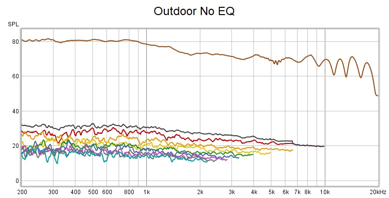

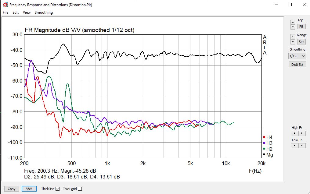

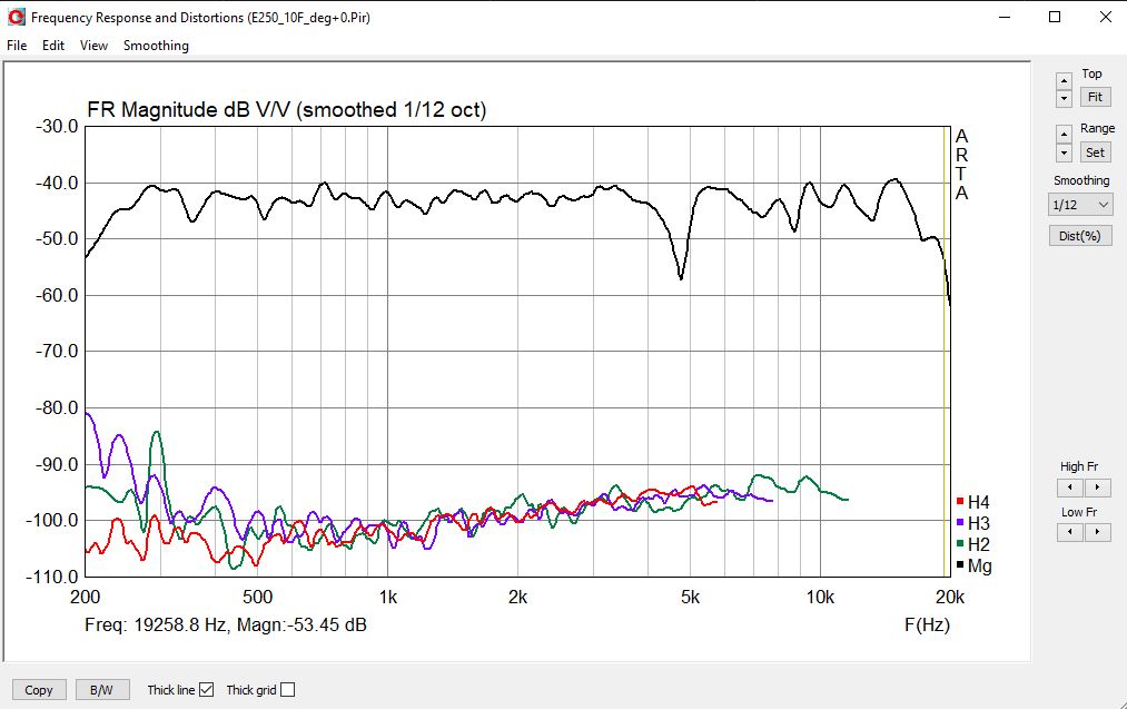

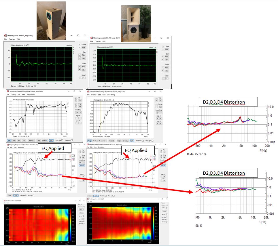

Here's a comparison between the horn vs non-horn. The left column of measurements is the non-horn single driver... right is the E-250 horn with four SS 10F drivers. There is only one phase plug in between the two middle drivers. There is 0.10% distortion through the midrange with the horn... is this good performance compared to non-horn multiple driver line array? Please share if you've measured your line array. My mic distance was one meter.
I have attached two graphs of my array, the first is a more recent indoor one with processing, the second is a raw outdoor one with no EQ. More of an orange to apples comparison given it is not on the same scale at the same spl etc....
The display ARTA gives is quite good for comparison of this sort of thing I'll try and check to see if ARTA can work with an REW measurement for a clearer comparison.
One thing I don't quite understand is the conversion of dB to percent that ARTA is using, according to the sengelpiel calculator, 0.1% is -60dB from the fundamental. I don't see your measurements having that much difference between fundamental and distortion components looks more like 50 to me from the image.
I would say that your result is very good In my graph you can see the bottom brown trace which is the noise floor of the room as recorded by REW at the time of measurement. As you can see the distortion is below that for the majority of the time. Given that I don't see going lower as likely to have any audible benefit, especially given that harmonic distortion in speakers seems to be another thing most of the experts agree doesn't matter unless it is outrageous, which mine clearly is not.
I tend to use it more as a check of my room and equipment to make sure that nothing is faulty or broken than something I am actively looking to lower beyond what it already is. The exception to that would be in the bass where a subwoofer would make quite a difference as the distortion rises significantly due to the boost.

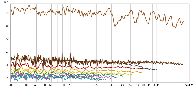

What SPL level was used for the single driver vs horn comparisons? All distortion products look bundled together in both of them. I would expect measuring at higher SPL levels should have an effect and make distortion products look more like in fluid's graph.
Not saying I'm not impressed with the results though. I measure at 2.7 m and about 80 dB levels (calibrated with an SPL meter) and get about ~0.5 to 0.6 from 200 Hz and up.
In response to the above distortion sweeps I've changed my measurement settings to display dB instead of %THD. I've selected a volume level that produced the least distortion for the non-horn speaker and then level matched the horn speaker's to the non-horn. This ensured I wasn't stressing the non-horn speaker which would invalidate the comparison. So the horn is -60dB from the fundamental (0.10%) while the non-horn is -48dB (0.80%), looking at 1kHz region.
That is what I figured, but that makes this comparison moot.
As what's being measured with the arrays, at least in my case is at the listening spot at or around 80 dB. (confirmed by an SPL meter)
From 20 to 20 Khz... with 2x 12"subs added I have it below 1% in the entire region. About 0.5 to 0.6 from 200 Hz and up,
the subs come in to help out at ~160 Hz. Still need to fine tune.
What is obvious though is that dip due to the horn geometry.
Adding a horn can improve that, but I don't like that dip though. What can we do to improve that performance...
