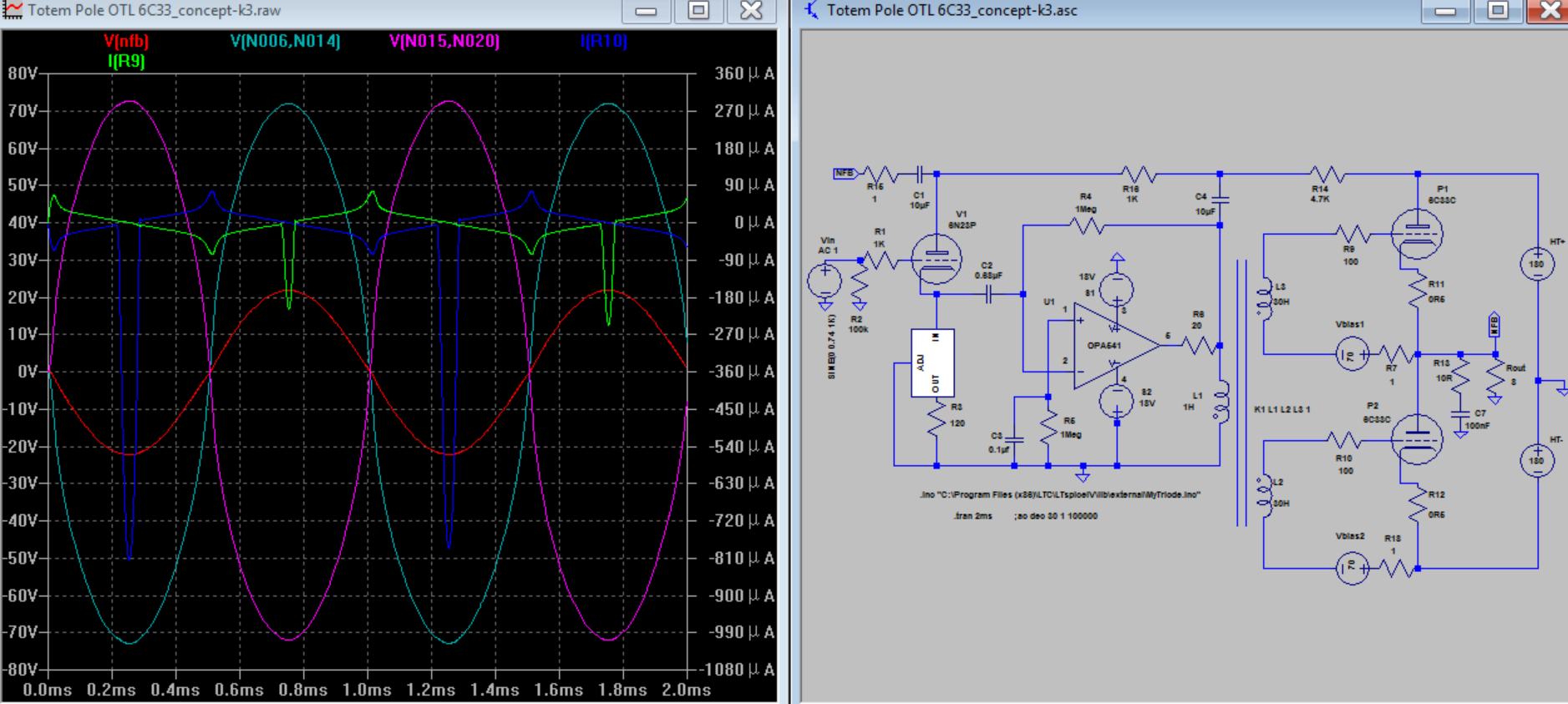

cnpope said:
"Maybe someone who has access to a 6C33C OTL could chime in here with a measurement? It's a very simple one to do."

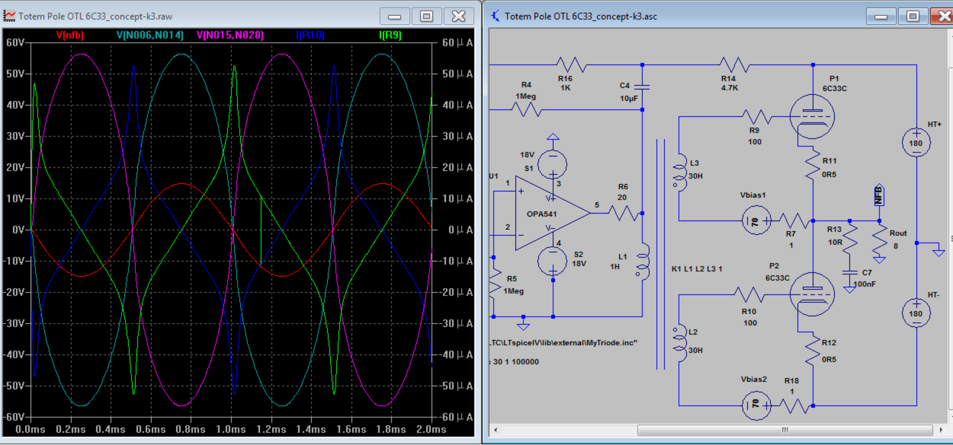

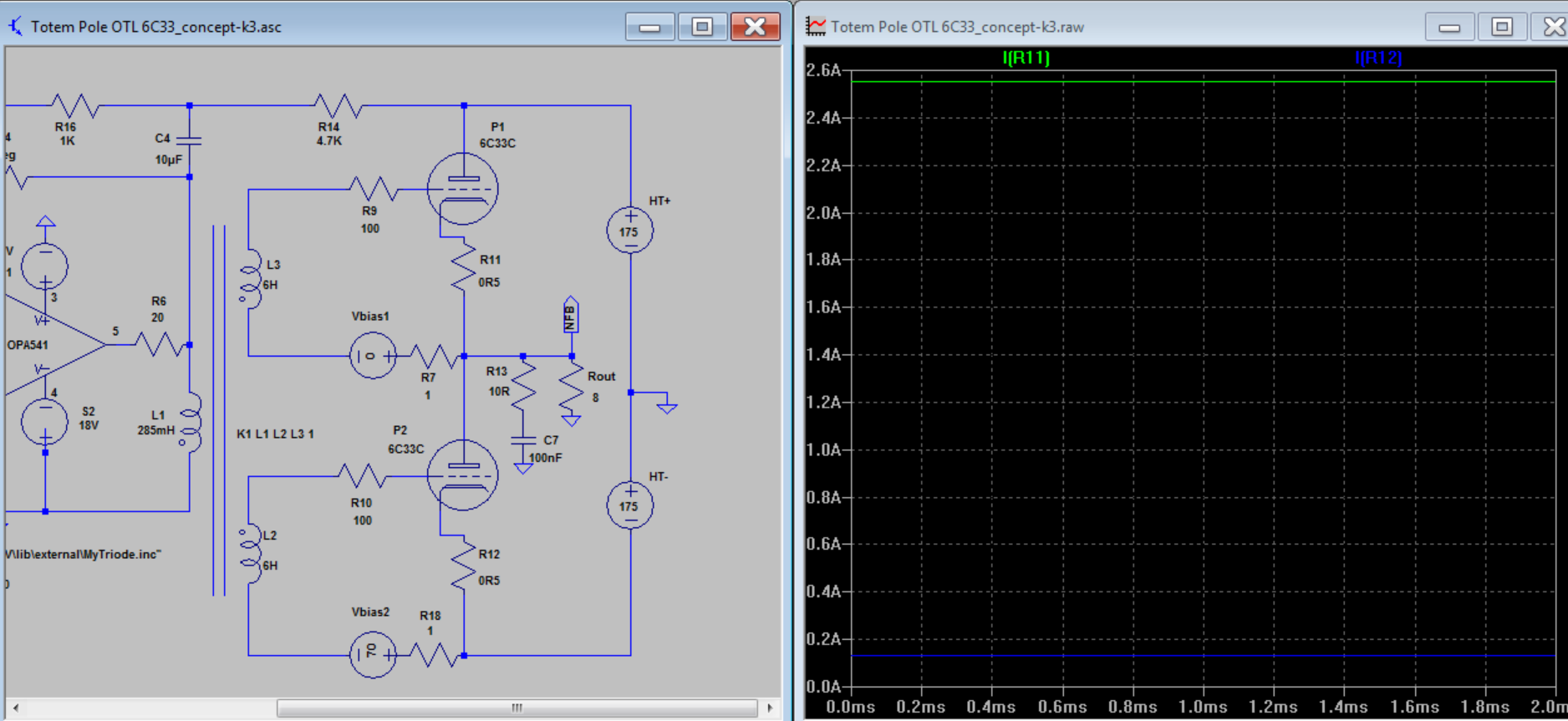

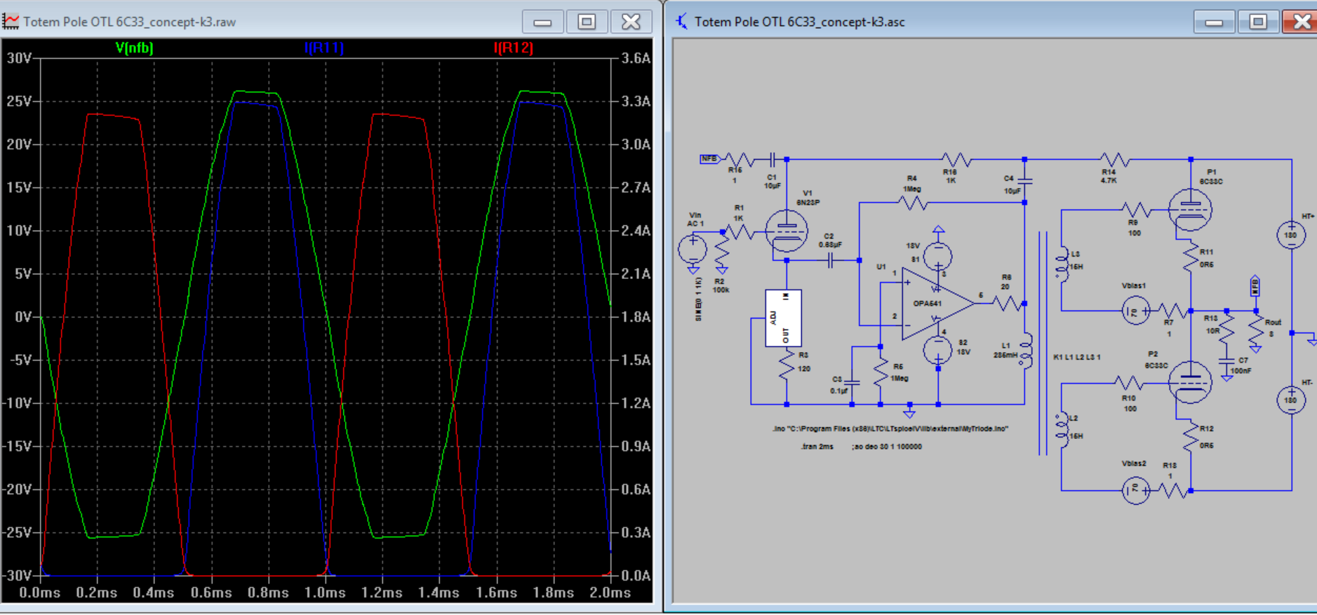

I only have 6C19p otl. But maybe spice model ok?

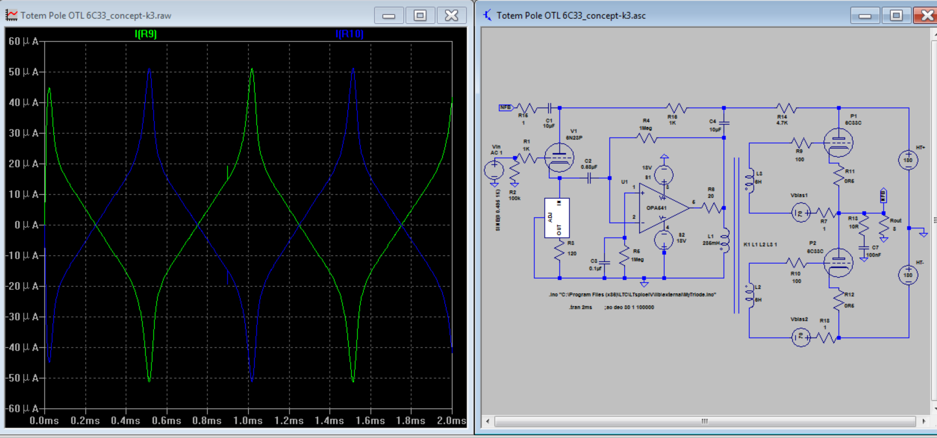

According to my ltspice simulation both drawn grid current except direct coupled one is drawing a little heavier 🙂
An actual measurement would be nice. Much better than a dodgy SPICE simulation done with a tube model of unknown providence.
I wish I had a dollar for all the amateurs misled by SPICE. I'd be stinking filthy rich by now. Don't get me wrong - SPICE is a very good tool in the hands of an expert.

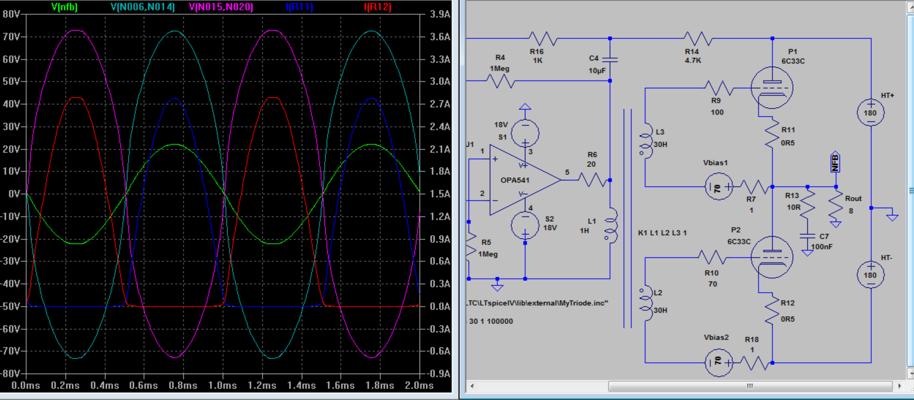

OK. Here is a better one. The thing is I need to reconfigure the inductance so that it is capable of over-drive needed for grid current drawn. The snapshot show only the inter-stage transformer, while the conventional cap resistor driver may not be able to overdrive as driver itself is clipping so there is nothing much to worry I guess. This is the thing about using OpAmp that does not clip before output tubes do. Still the grid current overdrawn is not that much, unless it's driven into! 🙂
It's not unexpected that a) raising the HT from 150 V to 180V per side (which increases the current for any given grid voltage), b) raising the bias from 47V to 70V, and c) getting rid of the grid capacitors, as you have done, would make it work a lot better.
But what IS the actual magnitude of the expected grid current in your sim?
Ok, I think so, sonic wise not too sure though.

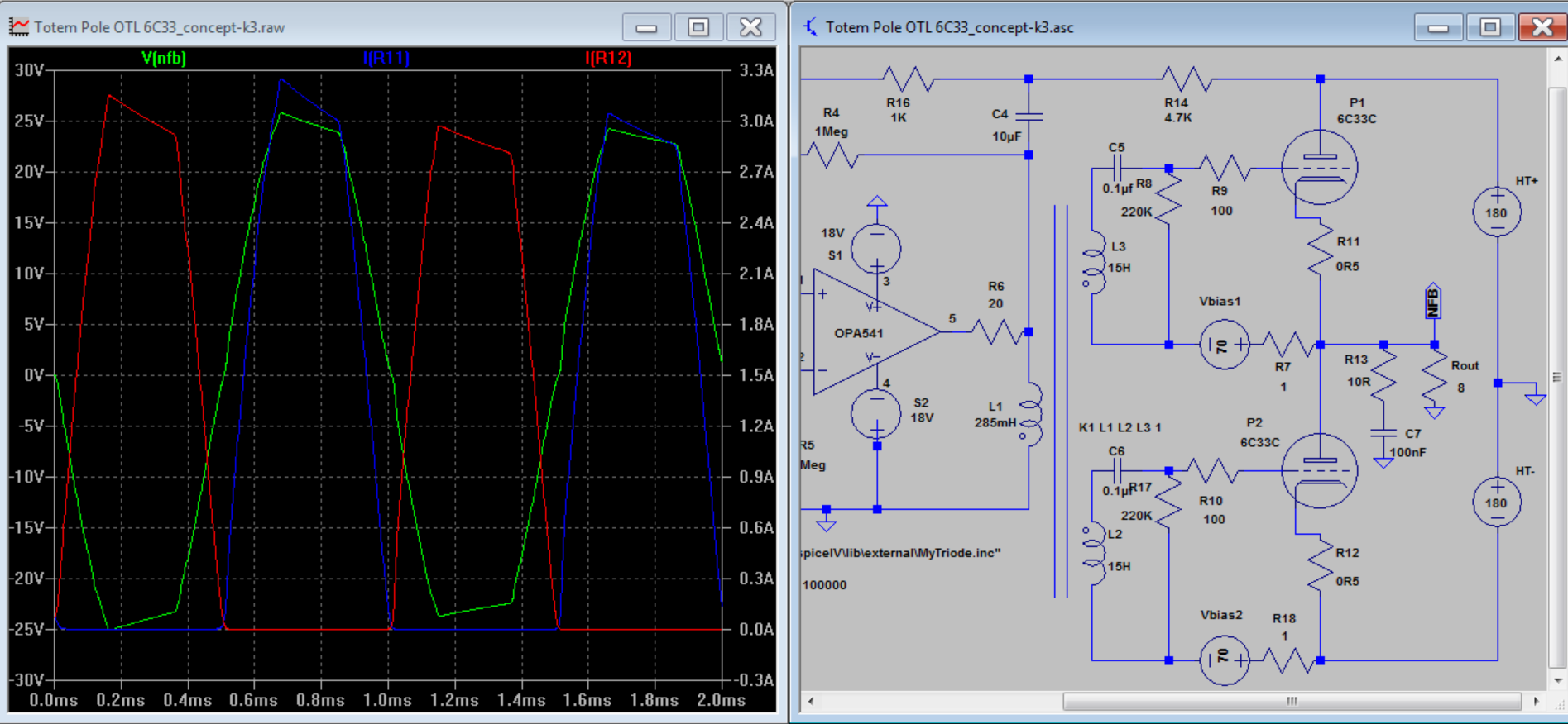

50uA. Please note the difference of 0.495V to 0.5V to input signal, seeing huge spike go up..just before clipping. not sure what it is at the moment.

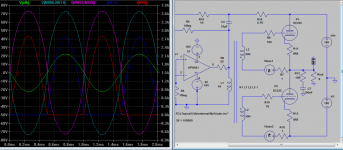

Now let's address the second point, whether my amp draws grid current. I am on the side saying that it's not. You are saying it is.
It cannot be the top tube drive, as on +Ve peaks you have it putting out 2.5 A. 2.5 A into 8 ohms equates to a cathode voltage 20 V. 6C33C curves only go to 1A but by extrapolation to get 2.5 A anode current at Va 130V, the grid must be positive (by about 12 to 14V).
I never said my amp puts out 2.5A. My 6C33C model gives peak current of 2A at Vgk =0v. I clearly said that on the first post. If you check again below graph, peak current is even less at 1.8A. This is because i am still not touching Vgk =0v. I am still below that where Vgk is negative, or no grid current teritory as we know it.
Now, 1.8A to 8R speaker means 13 watts which translates to voltage swing of approx 15 volts. First, let me assure you that the voltages shown are at the correct Node and that although i am newbie, i am not showing the wrong graph. Here is the grid voltage of the top tube at N007
Here is the cathode voltage at N010.
Here is the graph again..
So, is it clear now why there is no grid current?
One would have expected the grid drive graph to be with respect to cathode - that is the common convention.
Ask and you shall receive.
Just in case you are curious, here is the bottom tube cathode voltage vs grid voltage with respect to ground.

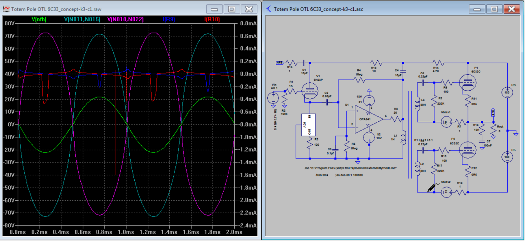

Here are 3 snapshots of grid current wave forms, below zero (<-70V and above zero (>-70V), Again I reconfigured the inductance for over drive to happen. Please help me to decide if this is for real, thank.

3. Removal of the grid capacitors and biasing in series per normal and necesary Class B practice.
So if Koonw found there is grid current, your amp, without these important measures, is going to pull lots of grid current.
