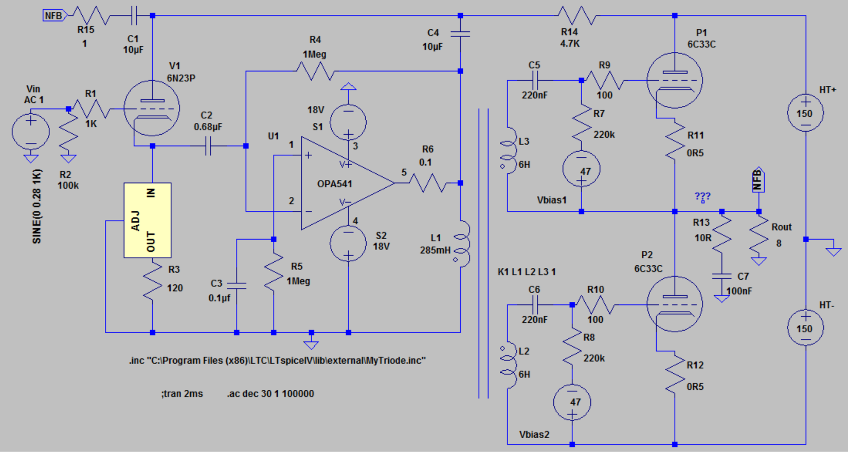

The output gets fed to the plate and comes out from the cathode attenuated mu-times lower.
The difference is that my input signal goes to the non-inverting pin.
That's actually a dumb thing to do. The relationship between anode voltage and anode current in a triode is non linear. So the feedback is non-linear. If the gain block is another triode it can be arranged that the distorted feedback cancels out the distortion in the gain block, instead of merely reducing it as neg feedback normally does. You can also do something similar if the gain block consists of a low distortion output stages eg ultra-linear driven by a triode gain stage and a concertina phase splitter. In this case the distortion from the triode gain block dominates, especially if the output tubes are not worked hard.
But that is not what you have in your circuit. Your gain block is not a simple triode. It's an op-amp driving a push pull pair. In your circuit, the neg feedback via the triode will make the system distortion worse.
Below is the more conventional inverted Futterman OTL. I dislike this version for few reasons:
1. The need for another higher supply +350V
2. Heater power elevation for the cathodyne is required
3. Since 6C33C varies wildly between each tubes, matched pair are very unlikely found and DC servo is needed to keep the output offset minimum. Hence another need for bipolar supply for DC servo op-amp.
Your circuit, according to your posts, must operate in Class B. You have transformer coupled the driver to the output stage as is normally required for Class B. But you have ruined it by inserting 220 nF capacitors. You are going to have big problems with grid blocking. To get full output (in fact anything much more than a watt) the grids have to be driven positive and will draw grid current, charging up the grid capacitors. The result will be really bad distortion.
The "Flutterman" circuit you posted has the same problem.
In Class B, the grid needs a low impedance DC return to the cathode. This is done by inserting the grid bias voltage supply in series with the transformer secondary, so no grid capacitor is needed.
Still, some people like a bit of distortion. Not as much as this amp will produce though.

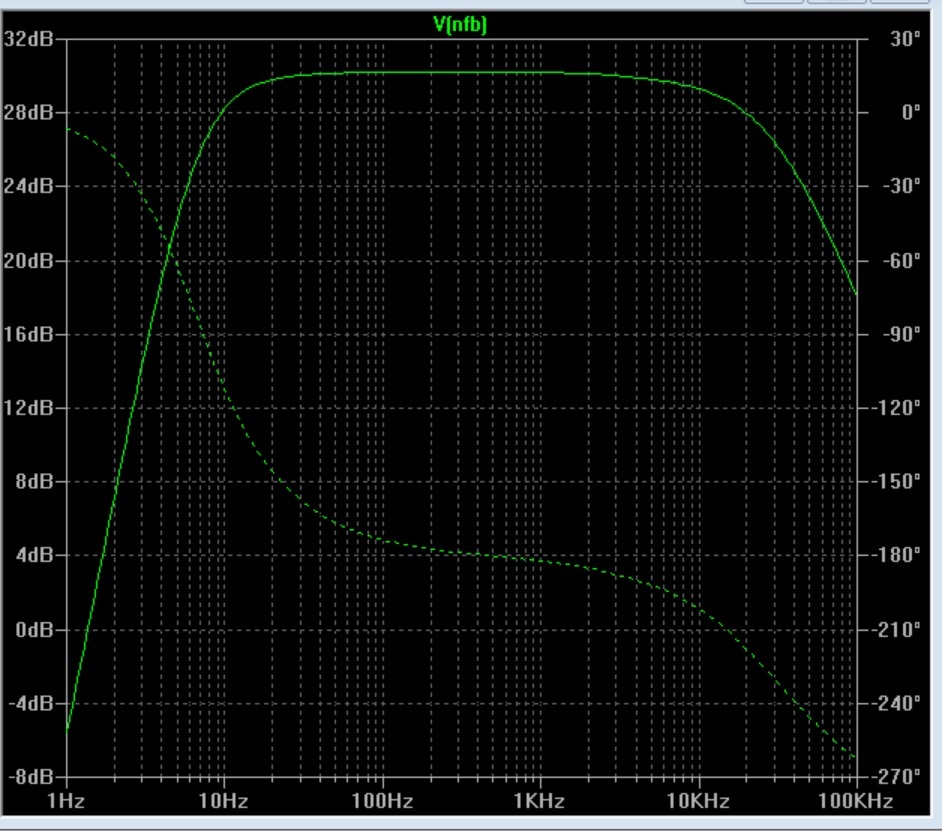

Here are modifications based on feedback, it works, please take a look and input more mods as needed.

What's that 1 ohm resistor in the output ogf the op-amp supposed to do?
It's not enough to prevent the op-amp from driving a large DC current into the transformer. It's too low to cure an instability issue.
Why have you added C4? It means the output stage has positive feedback around it (hence oscillation), and it will overload the op-amp.
That is actually the point.
Mine remains in AB1 all the way to 16W, no grid current here. That Futterman works in AB1 also, believe it or not. Ask Alastair E, he built one. Here's the grid voltage (green) compared to the cathode voltage (blue) of the upper triode. Green never gets above blue, so no grid current.
More proof, here's the current flowing on each of the 0.5R cathode resistor on the output tubes. That sure looks like Class AB to me.
I'd be interesting in seeing measurements of the circuit in question- the Futtermans actually measured pretty well (except for high source impedance).

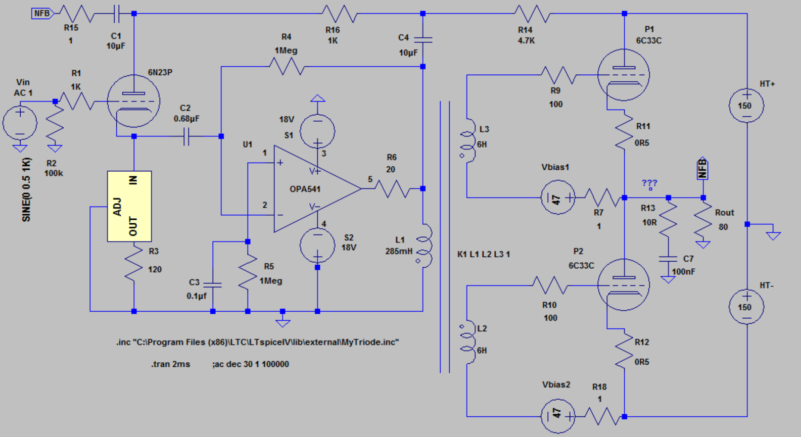

Thank you for feedback.
I have made another change about the inserted capacitor in sec winding of inter-stage trans you mentioned earlier, I can get rid of, not sure it's all very safe. You need DC path in drive for AB1 (draw grid current) to happen, now the output level has increased somewhat.
The output of OpAmp is supposed to AC tied to the tube anode isn't? They are same phase, no oscillation.
The 0.1hm resistor help to prevent back emf into the system I think, optimum value yet to be determined.
Keit pointed out this earlier:
"No, because they are feeding loudspeakers. A loudspeaker has a DC resistance about the same as its rated impedance. In the 1950's, when spekaers were more efficient, a typical 8 ohm speaker had a DC resistance of around 6.4 ohms. Today's speakers are built for better sound quality and not efficiency. Their DC resistance is closer to the nominal impedance.
But you are taking the output of an op amp direct into a transformer winding, in which we can expect a vary low DC resistance, so a much greater DC current."
I have inserted a resistor of 20 ohms to compensate for low DCR of this inter-stage transformer. It appears to work well when I try to reconfigure the inductance, it does make better sense now than before. Or you can insert DCR directly into the inductor.
Also the OpAmp output is tied to tube anode via a 1K resistor, somewhat isolated it from global NFB, you can test by change the load resistor from 8 ohms to 80 ohms, the output should be constant.
Any other comments are welcomed.

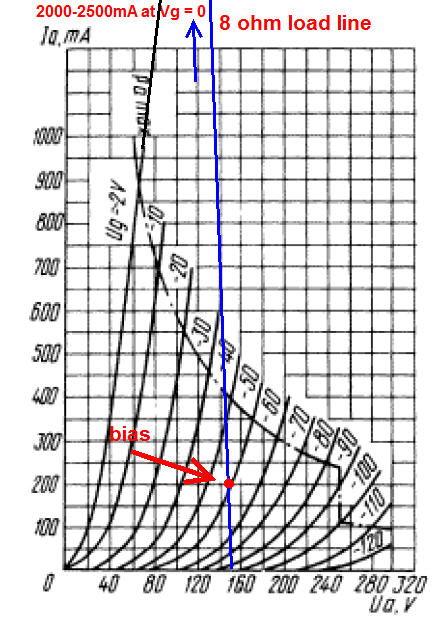

Your simulation graphs clearly show Class B operation - each tube is cut-off for approx half the cycle - that's the definition of Class B. See the cathode current curves flat along the zero amp baseline? Class B.
Your simulation graphs also clearly show that the grids are driven positive WELL into the grid current region. You have a grid bias of 47 V and a grid drive of 122 V pk-pk. For AB operation the grid excursion must be less than twice the bias.
The op-amp is in inverting mode. So if global feedback is negative at teh op-amp input, it is positive at the transformer. It's not teh op-amp that will oscillate, it's the output stage.
It won't do that. The output impedance of an op-amp is very low, and even lower with local feedback - you'll get no back EMF in any case (assuming the output stage doesn't oscillate - and if it does the resistor is not going to save the op-map then)
A couple small changes to eliminate the extra poles and enforce a maximum reflected impedance. Apparently I don't have the symbols for the chipamp and 317.
Seems my earlier post was ignored/overlooked. You must enforce a maximum reflected impedance, trying to reflect basically infinite impedance up until grid current where it will drop suddenly will cause issues with distortion and stability. It will work fine in spice, not in the real world.

Here it is explained by my previous graph.
Also, here is the other chart showing clearly there is no positive grid voltage with respect to the cathode.
Your own load line tells the story... I guess you can call it class aB, perhaps with a very small "a", for all practical purposes, most OTL output stages including this one, operate in class B1. Also, with a few exceptions, class B is not biased at "exactly 0mA", it is low, but not that low.
I dont think you can classify something with "low, but not that low". What is the exact bias current value where you differentiate between class AB and B? We are talking about clear cut differences here. My amp has a part where both devices are conducting around the crossover region, hence it is class AB. If both devices never conduct at the same time, it is either class B or class C.
200mA is not even that low. Linn-topology transistor amps like AKSA and Rod Elliott's P3A project are biased around 100mA and it still makes them class AB.
