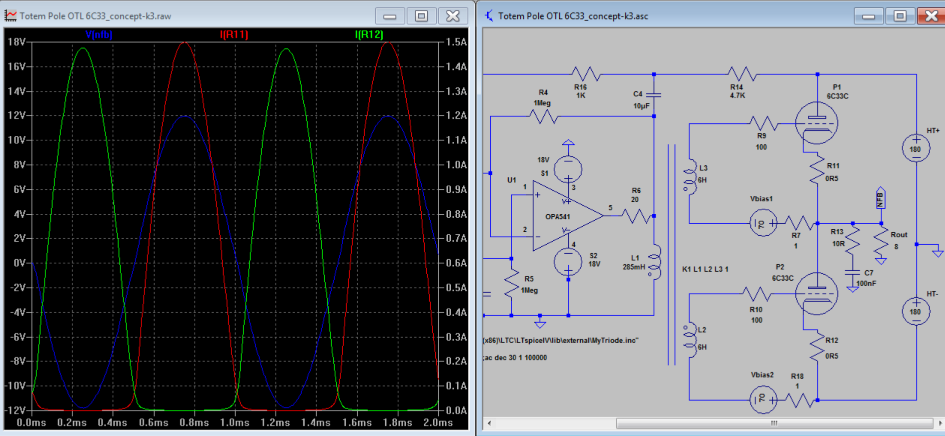

I read the story of perfect Class B design before any one can point it out where it can be located?

It's clearly Class B. Read the definition I quoted straight out of the Radiotron Designers' Handbook.
An AB output stage is one whether the tubes are each cutoff for much less than half a cycle. Class B is where each tube is cut off for approximately half a cycle.
There is no point in splitting hairs over whether its 180 or 181 or 190 or 170 degrees. The practicalities of tube design mean that an amplifier that cuts its tubes off for appoximately half a cycle, with very few exceptions, must draw grid current (or the power output will be less than with the same tubes in Class A - negating the only reason for using Class B).
But actually, whether it is Ab or B or X or YZ, isn't the main point. The main point is the OP's circuit causes the tubes to go well into grid current.
Grid current + grid capacitor means lots of distortion due to overbias. And post large signal parallysis as until the grid caps discharge back toward static conditions the tubes are held cut-off and ignore or heavily distort any small amplitude signals.

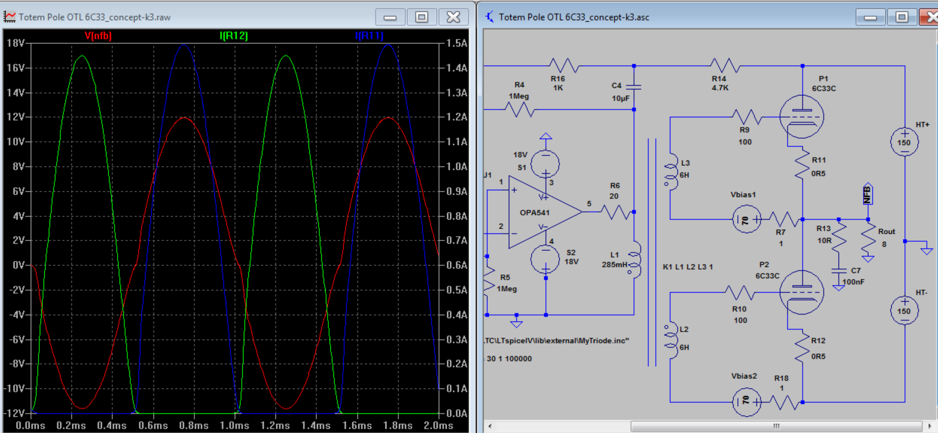

Thank you all for very informative feedback.
Now then I readjusted bias to -70V and increase B+ to 180V, now running at about 50mA or ~10W dissipation per tube, the cross-over distortion has disappeared! 🙂. Hope you like it.
