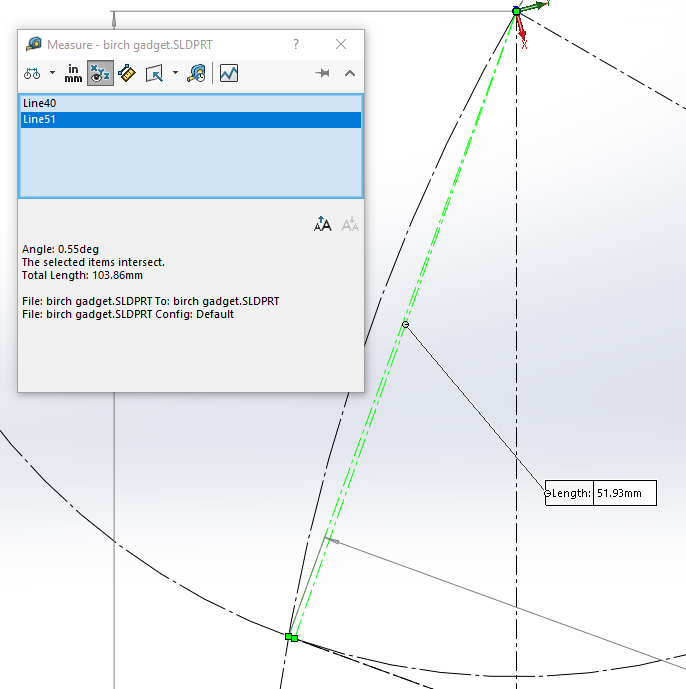

Hi Twice.
I've done an overlay on the dimensions and layout that you sent me to work on it: you managed to reduce errors in an incredible way. It would be nice to use standard diameter pulleys that can be bought, to allow a construction without a lathe
Even if the solution with runout could be feasible (I tried just for fun) now seems really unnecessary: + - 0.5mm of overhang is completely inaudible. And then, since i'm stupid, i like to K.eep I.t S.imple.
On this basis I think it's possible to make a mock-up, but since to be useful will almost be like making the working arm, before I'll have to re-study a bit of Static, to see what kind of forces can be found on P (and HP).
carlo
Not even if the tonearm moving against the moving pivot rotation will work.
Yes, there is something strange that I can not understand, but does not convince me: that knee joint that must open for 40 ° e.g. I tried to break down the forces and the torque on the pulley HP seems to act against, but should be impossible trough the bearing. Before doing even the mock up better to have clearer ideas on what happens.
Your solution seems to have less problems and is easier, if the pulleys can be kept in contact in the right way
Carlo

# 1605 - The B hypothesis was drawn to place the arm at a standard distance (225mm). The A convinces me a lot more (I think I have resumed your solution) because two well spaced bearings are stressed much better by this load, and maybe can be made very light.
Weight is definitely a problem - I'm thinking of fiberglass (pcb) for the "cranks" and thin aluminum tube instead of solid bar, but above all a spring instead of the counterweight.
Belt: the accuracy of ratio is crucial, and even some elasticity - troubles guaranteed. The Twice solution must be considered seriously: i've rotated two gears leaning on table and works surprisingly well
Frictions: I believe, however, that I will never reach the data reported by Niffy for linears (surprising even to be measured!). What I did in the second arm was much better than many commercial types lent from a friend who likes to build 3D printers, but still far from 0.9 mN on the stylus. That means just a small fraction able to push the cart.
I am comforted by the fact that your prototypes worked even with low VTF: and I believe that the guides, or the second crank were not friction less.
For now, I'm trying to understand something with faded memories of high school. Difficult that I could succed, because the system is really complex: two related rotational movements + one rolling (the pulley on the belt).
I decided to make a crude arm, reduced to the bone, instead of a mock-up. I will lose some more time but I will not risk surprises.

You can reduce the error at the outer groove to 0.55°, middle -0.55° & inner groove to 0.55° with 2 null points at 1/3 and 2/3 of the record by changing
the length.

Hi 2wice (sorry, sometimes I've called you Twice). The more I think of your solution and the more I think is the right one, simpler and with better application of the forces (bigger lever arm),
To reduce hor. mass can be used only the necessary sector of the pulleys (especially for the mobile one) and for contact I thought like you, but the opposite, an O - ring on the fixed one. Something must be invented to keep them in touch with just the slightest possible pressure.
I tried to trace the curve with two gears and a pencil and I discovered that the curve described is a beautiful spiral. May you model one for the belt? I'm curious to see if it's the same
Alighiszem - hope not, even with a similar feeling. To do so it would mean that the resistance on the belt (which is fixed) is less than on HP bearing (wich is "frictionless"): seems improbable.
But what learned from Syrinx is that we can't waste even a bit of the minimal forces available. Even a beautiful geometry it's not a working arm. In this phase are needed calculations, graphs, not feelings
