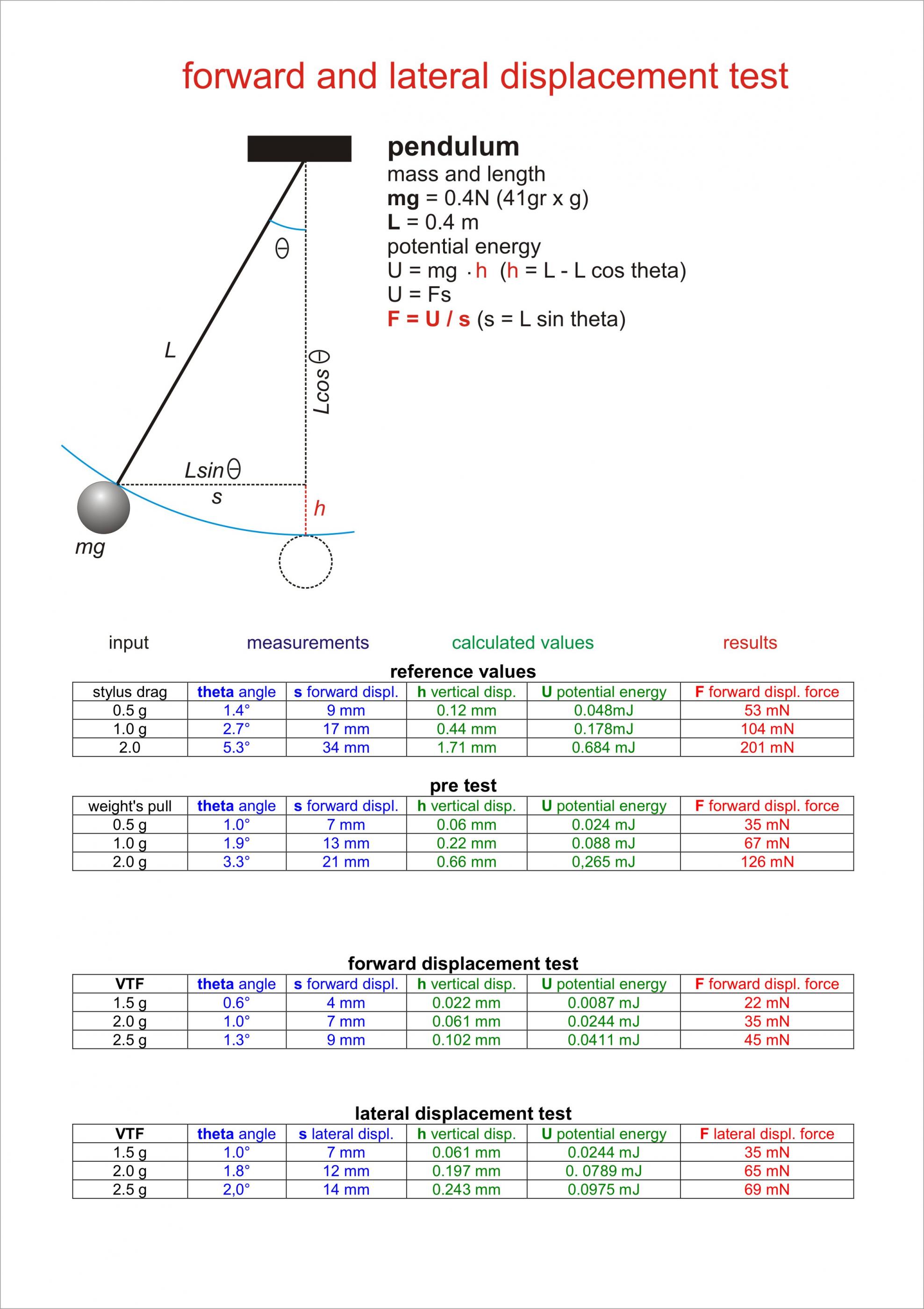

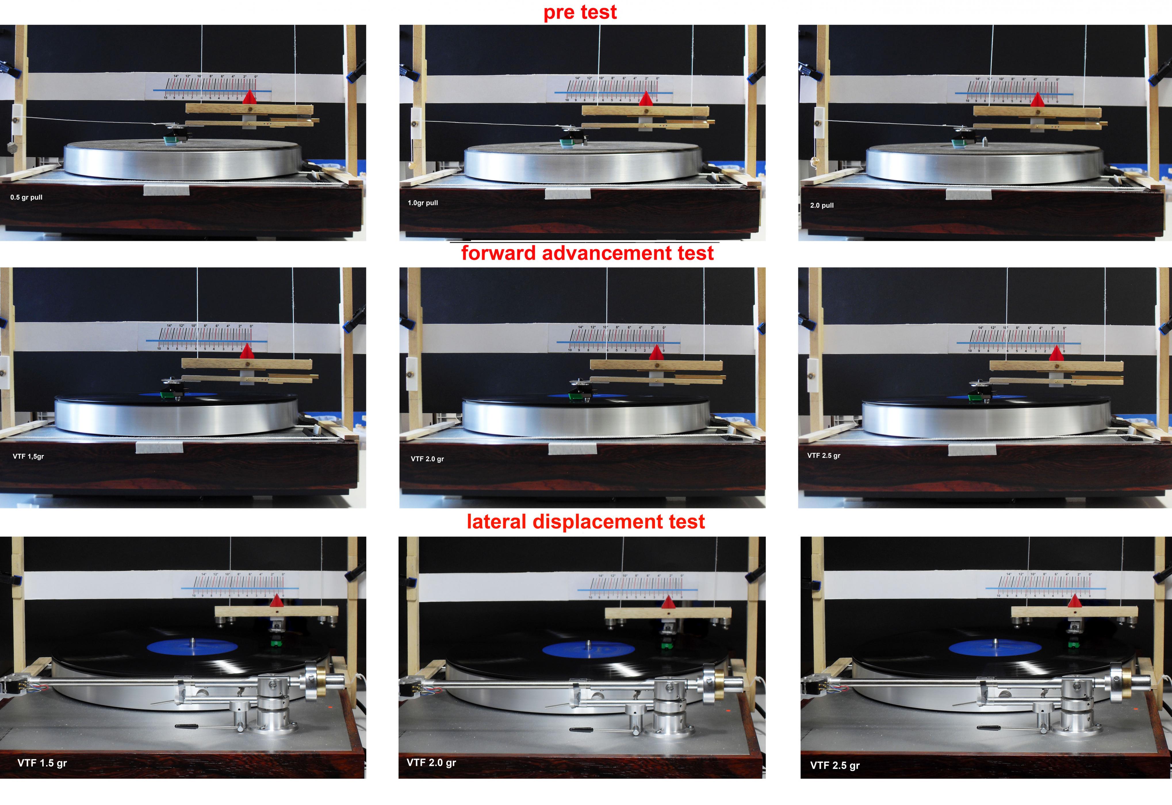

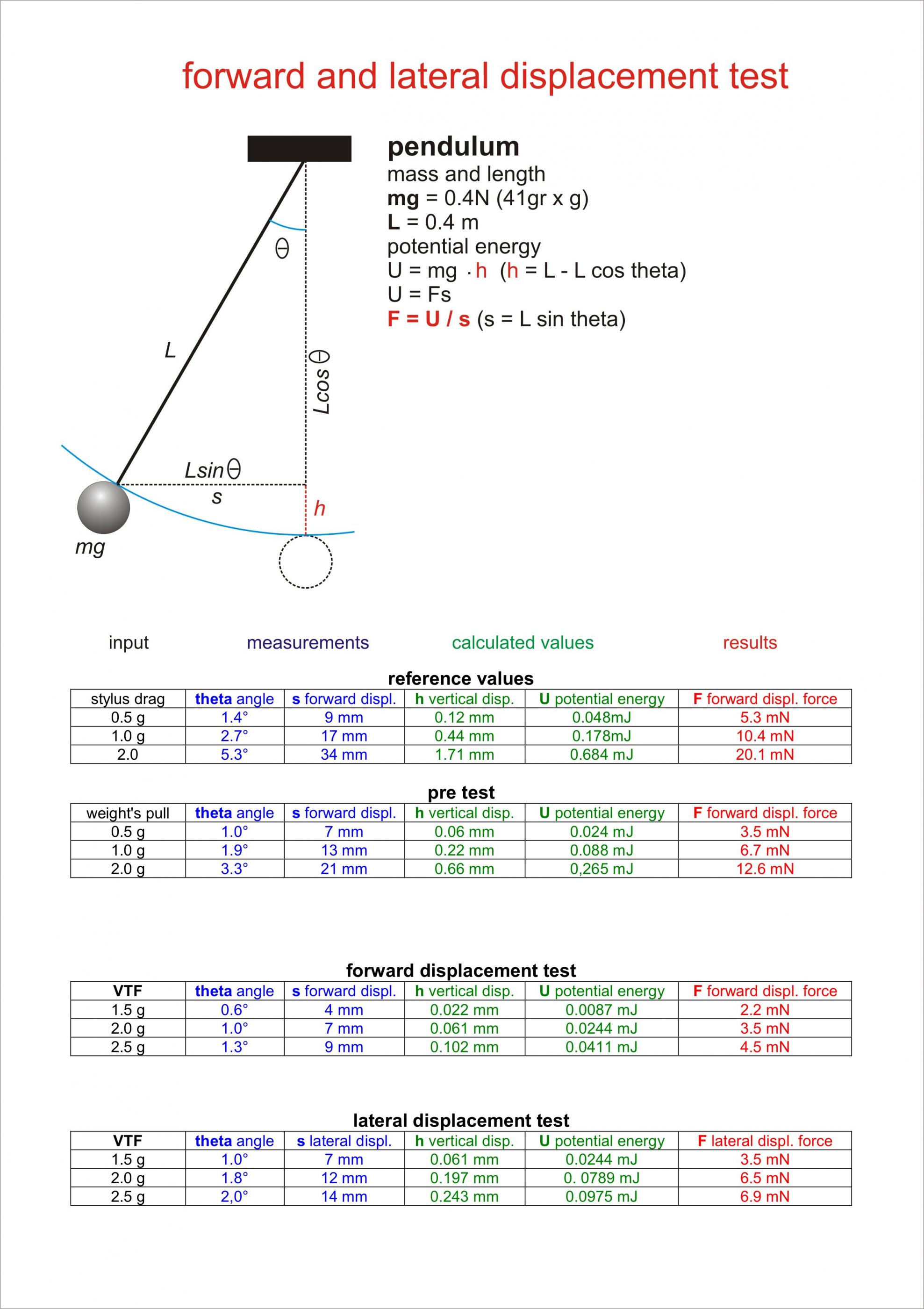

homework 2:
lateral displacement test
I had to change the layout of the post 1548 because a certain twist altered the measure and a uniform adjustment of the 4 strings was really problematic. Now a 15" - 0 offset tonearm, assembled with syrinx pieces pushes the pendulum trough a needle on the headshell. This brings a bit more friction.
The lateral displacement occurs until skipping.
test conditions: same as the previous test - for the data refer to the summary table and photos attached
Conclusions
Fascinating investigation. Looking forward to your conclusions (Niffy)
I hoped that calculations and conclusions on my observations (repeatable by anyone with little effort) would be posted by someone more qualified than me, but since it does not happen, will be posted toghether witht the side displacement test. It will only be the opinions of one who tries to make real arms. post #1587
Pre test:
The calculated values (0.34> 1.3) from these observations are lower than the theoretical ones (0.5> 2 gr) of about 30% (pulley friction, etc). Therefore, the reference values that could be observed with the theoretical drag stylus should be 30% higher, as those shown in the first table
Forward displacement test
the observed values (0.2> 0.45) are always below the theoretical values calculated both with the friction coefficient (0.5> 2.0) and the stopping method (04> 1.0).
The difference is significant, but could still derive from instrumental errors in this test, as in the others mentioned (we are measuring minimal and variable values).
However, this difference is crucial in practice, because with 2-300 mg it is very difficult to win the stiction of a linear bearing, and my two tonearms are unfortunately the proof. This makes some types of PLT arms (extensible Thales - tricycle and variants) almost unfeasible (at least by me) without advanced technologies and materials often mentioned in this and other threads. Unfortunately only mentioned.
Anomalies --- The force seems to depend on the VTF, but maybe the relative coefficient of friction is variable: the motion of a stylus is so complex that I dare not to say anything.
The force on external grooves seems much lower than on middle ones, and this is even more surprising (outer skating is greater because etc). Perhaps the friction also changes with the peripheral speed. More tests will be needed
Lateral displacement test
The values observed are always larger than those of forward displacement.
It must be said that this force (let's call "skipping force"), increasing groove after groove from 0 to breaking point is only the maximum available to move an arm (for that VTF and cartridge). Every arm hopefully uses just the fraction necessary to overcome the resistance of the constraint (pivot or carriage), for our cartridge's health.
It remains the problem of how this "mysterious" force is generated, and that must be leaved to physicists. Better not examining only the first groove....
Happy ending - Many will find these tests on so well discussed topics useless and childish; but I needed to see (and measure) the action in the real world of those elusive forces, anf this toy allows it. If I had done it before I could have avoided the construction of two useless arms, built on hearsay knowledge: instead those two big mistakes were needed to build this toy.
ciao a tutti - Carlo

Hi Carlo, a pendulum moves on arc, not linear. Your string should be very long so that the pickup can move horizontally, not elevating from the disc. Otherwise very clever measuring setup!

You 're right Icsaszaar, completely, but for angles <4° degrees the difference is so small that even the physicists do not care. My will was simply to see - and show - what would have been the displacements with the theoretical values, compared to the real ones. Photos speak for themselves.

Icsaszaar, sorry. I reread your post, which I misunderstood. Look better at the photos: the pendulum rises but the stylus that is placed on a small arm with a vertical pivot obviously remains on the disc. If not, what would you measure?
Confusion starts maybe from the photos of the pre-test with weights and pulley : there is needed that the whole mass raises (and there is not a disk).
The mass of pendulum 41gr = 0.4 N is given by rig + small arm + counterweight - VTF. Variations of VTF were compensated with small 1/2 g weights.
