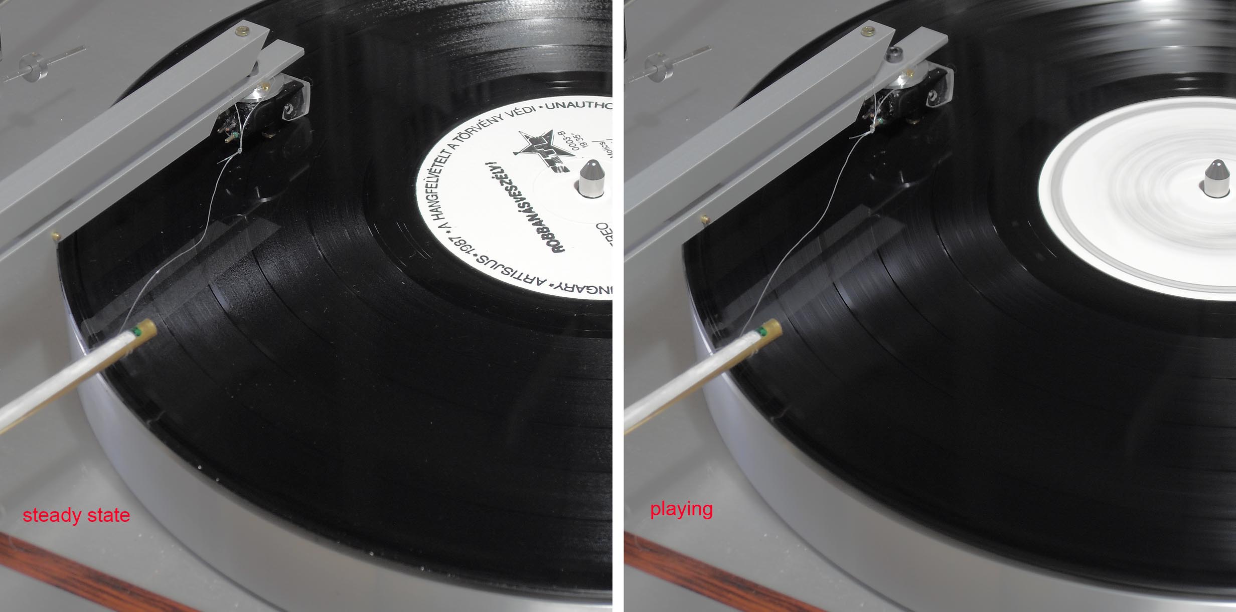

Icsaszar - again stylus drag
it is difficult to feel certain things without putting hands and eyes on; with traditional arms there is no direct experience. So I did again the guide test with the string from the middle point to show in pictures what happens. Without any guide this carriage goes to the end of rail, but now advances by 2-3 mm at best - it can barely stretch the splines of a 0.1 mm fishing line. Difficult to rely on this
Now I'm thinking a set up to make direct measurements of stylus drag and side force; If some result will emerge I'll post

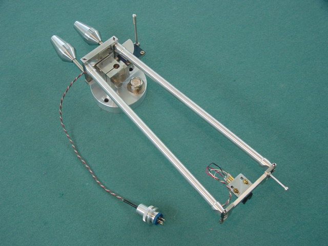

Carlo,
I was very sorry to read The Syrinx did not perform as hoped. It's still a beautiful arm and I believe the 'string gadget', one of the most interesting ideas on this thread recently, can still be effective. I think it's possible the binding bearings problem can be solved with a different sled using radial load ball bearings.
I really appreciate your excellent work, careful tests, and thoughtful explanations. If I can help with The Syrinx or a Birch arm, please let me know.

I was planning to do simple and cheap prototype of this arm; but due to personal work am not finding any time. I suppose we can use anti biasing string and weight to help whatever little stylus drag is there. Put an antibiasing string and weight as shown in following picture. In typical turntable the stand which holds the bias weight is fixed but here it is not so the forces act in both direction pulling both wands A and B. So the tonearm(B) moves forward. The weight can be adjusted. This way we solve both antiskating and tonearm moving forward problem.I'm convinced from my own experience, and now from Carlo's work, that the dominant force working on any tonearm is the side force and that stylus drag contributes very little, if anything, positive.
Regards
Thanks for supporting Doug, I'm stil in mourning** - With syrinx the problem seemed the bearing upon the horizonthal pivot, but with this second attempt with advanced bearing? Consider too that when the record is stopped, that bearing slides back (like in left photo) pulled by the splines of a 0,1 line, and not in axis! I think, and not from now (#1391) that the Baerwald geometry is much smarter than what it looks because the offset generates centripetal force (too much. unfortunatly) that aids to rotate the arm. With 0 offset maybe forces are quite balanced, and side force must be generated also by some cantilever offset, following next grooves of the spiral. Maybe experts may enlighten me.

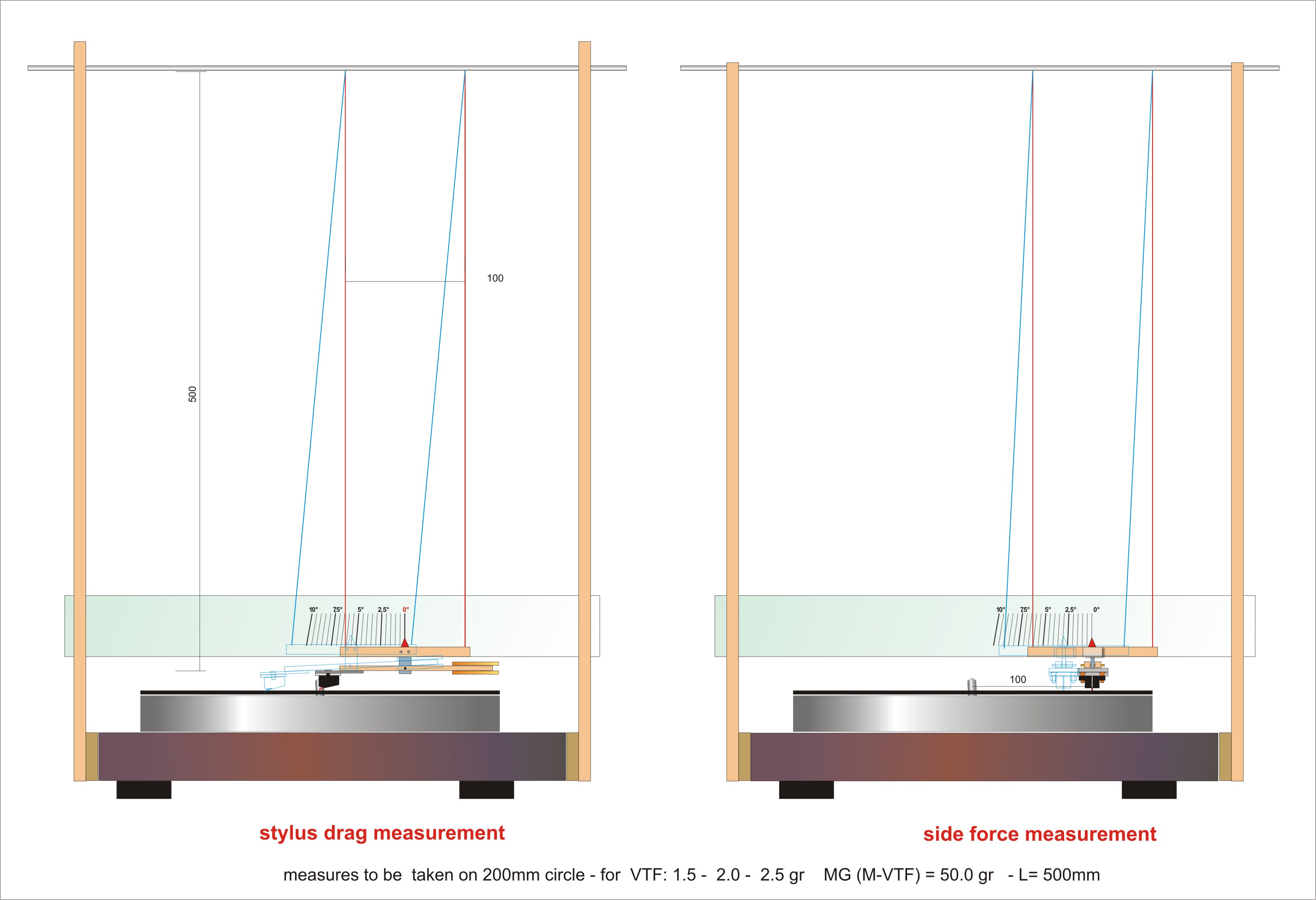

Measures (attachment)
Basically a ballistic pendulum; the idea is to measure the forces by angular displacement. (h = potential energy), in fact, all values - length, mass of pendulum and peripheral velocity are known. Stylus drag and side force are calculated as the mass of the bullet. Maybe before losing time in other mistakes if someone helps me I'll be happy.
carlo
ps - your measure seems realistic: found 1,1 resistance on syrinx and it does'nt move, the new one has lower with same result - what's VTF used? - ** pps - consolation: 3Points now beautifully playing .

Regarding side force
Hi dtut,
With an unmodulated record the side force required to make the stylus skip will be equal to the tracking force as the wall of the groove is at 45°. With a modulated groove the amount of side force will be dependent not only on tracking force but also on the frequency and amplitude of that modulation. Cartridge compliance and damping will also have an effect. It is not easy to calculate the side force required cause skipping for a modulated groove but the required side force will be less than for the unmodulated example, e.g. less than the tracking force.
Just because the stylus is not skipping does not mean that all is good and well. The side force might be only just below the point where skipping occurs. With most cartridges set at the recommended tracking force the cantilever will be deflected from tangency by about 3° before skipping occurs.
The whole point of tangential tracking arms is to reduce lateral tracking error to as close to zero as possible. Making an arm that is geometrically perfect but has high bearing friction, that causes the cantilever to be deflected by several degrees, will result in a worse lateral tracking error than with a conventional arm.
With a good tangential arm the side forces have to be as close to zero as possible so that the cantilever remains tangential. Stylus drag on the other hand is always going to be in the 0.5-2g range, dependent upon tracking force and groove modulation. You actually want stylus drag to be an order of magnitude greater than side force not the other way around.
With any pivoted arm stylus drag will translate into skating force that is itself a sideways force. Apart from causing skating force stylus drag is not really a problem. ANY sideways force is a problem as it will result in a lateral tracking error and that is a problem.

NiffY : 0,5 > 2g - have you measured? How? And with 0 side force what can move a tonearm (pivoted or linear)? and how?
It seems to me that Doug found SD an order smaller than SF, and me too: that's why we want to make some measures after the words we've read around. That things are complicated and variable is known, so as in every test is necessary to reduce them as possible, even at the cost of non-exhaustive results
carlo
Thanks for "beautiful", but for me a superb racecar that does'nt move is simply an ugly paperweight. There something deeply wrong in that design, all advices to find it are welcome. And yes, in ten years i've made a dozen working tonearms of different types, toghether with more than dozen mistakes

Hi Carlo,
0.5-2g drag.
Most cartridges fall in the tracking force range of 1.5-3g. The coefficient of friction between the stylus and record falls in the range 0.3-0.6 dependent upon groove modulation, stylus profile and vinyl composition. The drag is the tracking force multiplied by the coefficient of friction. Roughly rounded that gives the 0.5-2g. Most cartridges will fall in this range. Of course there are the odd example of cartridge that are going to have higher or lower tracking force and some stylus profiles and vinyl compositions that will result in differing c.o.f.
If we assume that the bearing friction is zero and there is no skating force then the only sideways force acting on the stylus will be that required to track the arm. (I am of course ignoring the sideways force due to groove modulation as this occurs at a frequency above that at which the arm moves)
As you are aware force = mass x acceleration.
The mass in this case is the effective mass of the arm.
With a perfectly centred record the arm tracks sideways at a near constant speed so there is zero acceleration.
Any mass x zero acceleration = zero force.
In reality there is always some bearing friction plus the flexibility of the wires so the side force is never going to be absolutely zero.
With a record that is not perfectly centred the arm has to be accelerated back and forth. A basic formula for determining the peek magnitude of this force is
Force = effective mass x angular velocity squared x twice the eccentricity.
All unit have to be SI. So effective mass is in kg , angular velocity in radians per second, and the eccentricity in metres. (Twice the eccentricity is equal to the amount you see the arm move from side to side) The resultant force is in Newtons.
As an example :
If we have a typical cartridge with a 15um/mN compliance mounted on an arm so total effective mass is 17g. The record revolves at 33 1/3 rpm (3.49 rad/s) and the eccentricity is 0.2mm. This is pretty typical/average.
The peek sideways force will be. 0.08mN.
(The average sideways force is this force divided by root 2. Which is 0.058mN.)
0.08mN is tiny. With our 15um/mN cartridge this would result in a stylus displacement of only 1.24um.
If the cantilever of our cartridge is 5mm long we can easily calculate the angular deflection using simple trigonometry. The deflection would be 0.014°.
There are more comprehensive formulas that take damping and resonance into account. I thought including them here would over-complicate this description and they give very similar results at this frequency, 33 1/3rpm.
So yes, there are side forces required to track the arm across the record but these are absolutely miniscule and do not cause any significant lateral tracking error. The tracking error due to friction is going to be much more significant.
I hope that this clarifies things.

Maybe we diyers are still believing to flat earth (flat like an LP): we see the sun rising up and we think it's running around us, we see the tonearm rotating on the platter and we think that a mysterious influence (the Side side of the Force) drives it to move and sound for us.
Well, Science clearly demonstrates (thanks Niffy) that there is only the stylus drag (vtf x friction's coeff. = 0,5> 2gr) and not the side force (zero acceleration = zero force - elementary, Watson) that appears only with eccentric disks taken from garbage, and so small (6 milligrams, homeopathic dose) that it is not the case to worry about. The stylus drag instead is so healty that it's enough for everything, and even more (skating as bonus)
Clear: so evident that with foggy memories of half a century ago I had almost got the same ideas #1536. Just thought of being crazy. You've convinced me: no more doubts, even in front of deviant behaviours of tonearms. (that's the science, baby, the Science ).
But please, convince also my poor Syrinx arm: because if pulled in axis with 1 or 2 g it rotates smoothly (Ray will be glad) but when put on a record it's nailed there like a mule.
carlo
just kidding, Niffy. Thanks instead for detailed and rigorous explanation: seems perfect on tangency, with uniform motion. But this motion is circular not linear (with centripetal acceleration ac= v2/r = 1,84 m/s2 for external groove, not zero - so there is always side force, and less stylus drag, since vtf generates both). Unfortunately Newton's laws are three, not two
carlo

The point being that the summed direction of the drag force is not tangential just because the cantilever is tangential. The effective pivot point has to be tangential, and it never is with these type of arms.
