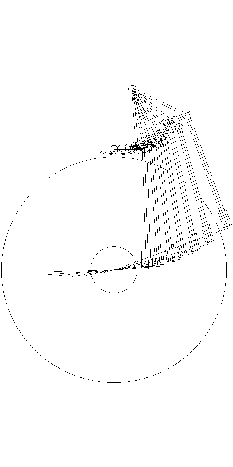

Sunday morning: some sketches about.
More great drawings and ideas from Carlo again! By making the vertical movement independent from the carriage, you do get more options in designing vertical bearing AND guiding mechanism. I was just taken by the simplicity of two ball bearings but other methods are totally valid. I wonder if sliding in a small chamber of fluid can have low enough friction for the elongation movement? :scratch2:

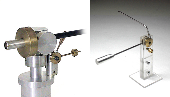

The rolling balls idea reminds me of this tonearm from another thread:
I would prefer the sub-arm to be easily removed from the carriage so you can swap cartridges easily.... kinda like those removable VPI unipivot armwands.

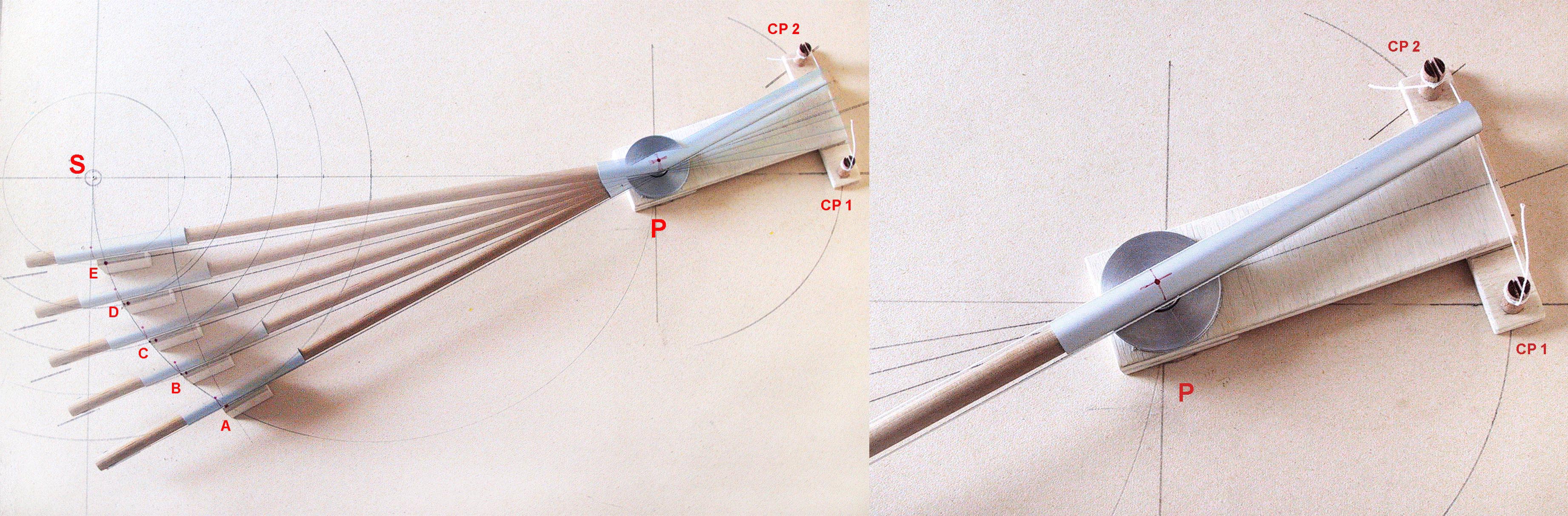

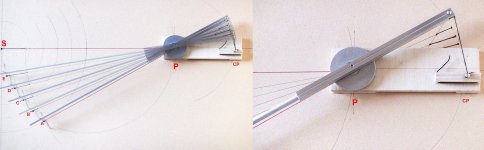

Here are the first practical tests for my Thales extensible arm (Syrinx B - C solution #1252 - 57 - 76). Good to verify the geometries, but not so useful to find constructive solutions.
As you may see the results are quite good - always 0 offset (and 0 skate?) < 4mm max underhang on B solutiom < 2mm max for the C. What's noticeable is that the friction for the linear elongation seems negligible compared to the angular moment that moves it. Maybe an extensible arm is feasible, if the elongation is related to the rotation of the arm, instead of the stylus drag.

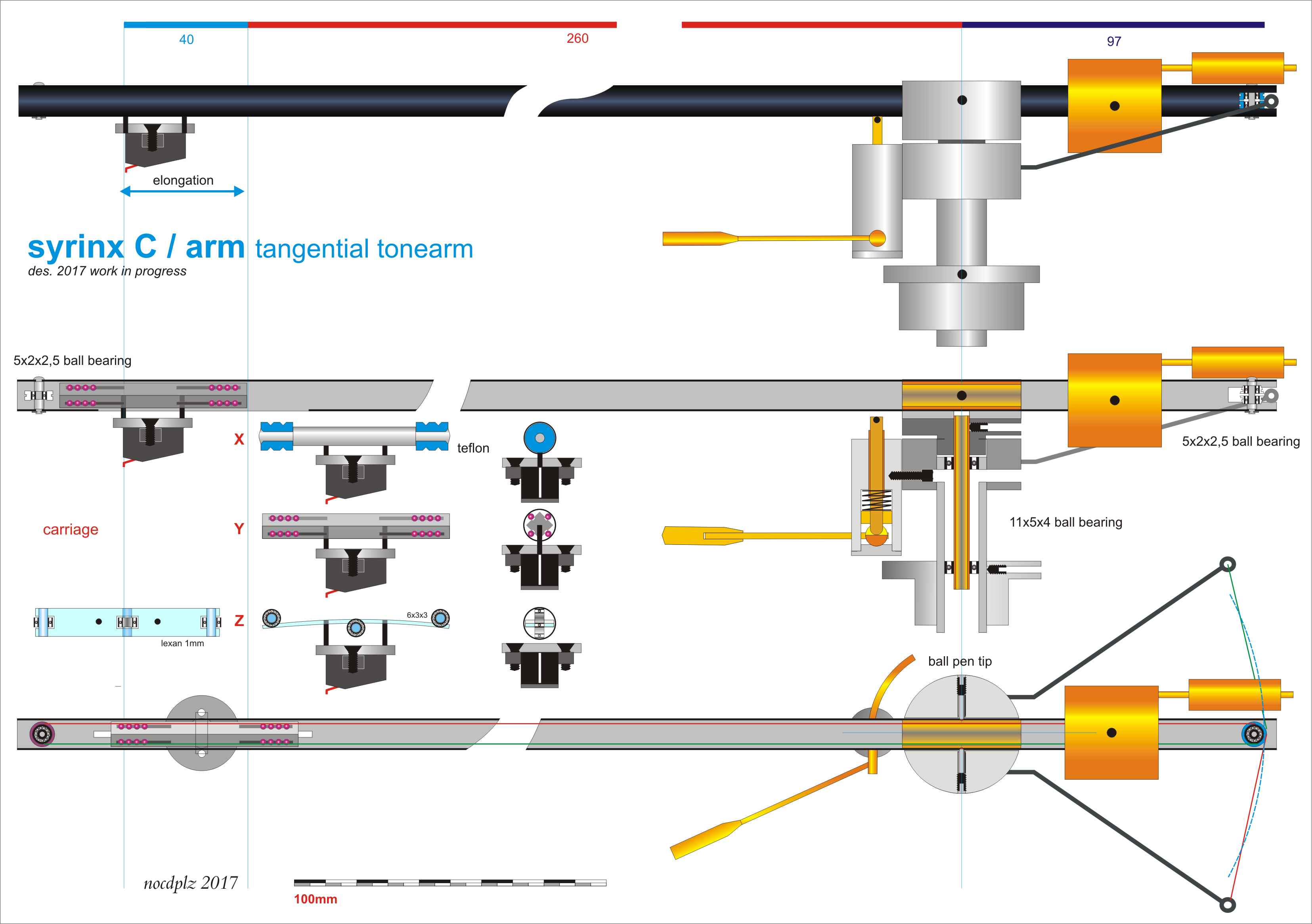

The feeling is promising for both, but these arms are so different from what i've built before (and the B from C, like an unipivot vs gimbal) that the last miles seems really steep. Design in slow progress (attachments). Problems: choice of best nullpoints, B: spring with only 1-3 grams boost - C: 3 pulleys+carriage with less possible friction and chattering - help needed!
That sliding headshell version (C), perhaps, can use this extremely low friction linear slide from Del-Tron, as can be seen here.
My own hybrid approach would be using your two-string guide mixes with Dynevector split-plane style and implement the Del-Tron slide for the vertical armwand. Just a thought.

Last night (insomnia!) I worked on this, trying to solve some problems.
Carriage: those linked seem to be excellent (many around now, for CNC routers) but somehow heavy and bulky: here may be enough much less. With angular guiding, friction worries me less than chattering.
Guiding: the 2 strings system seems nice, but not without problems. So I'll have to build it with the right materials to say if it can be a real solution.
Lifter: Dynavector solution does not work: our sub arm travels for 40mm, while the Dyna has a fixed length. Till now nothing convincing (i don't like ringing levers)
Interchangeable Arms: a couple of solutions, but this also increases the mass (already worrying)

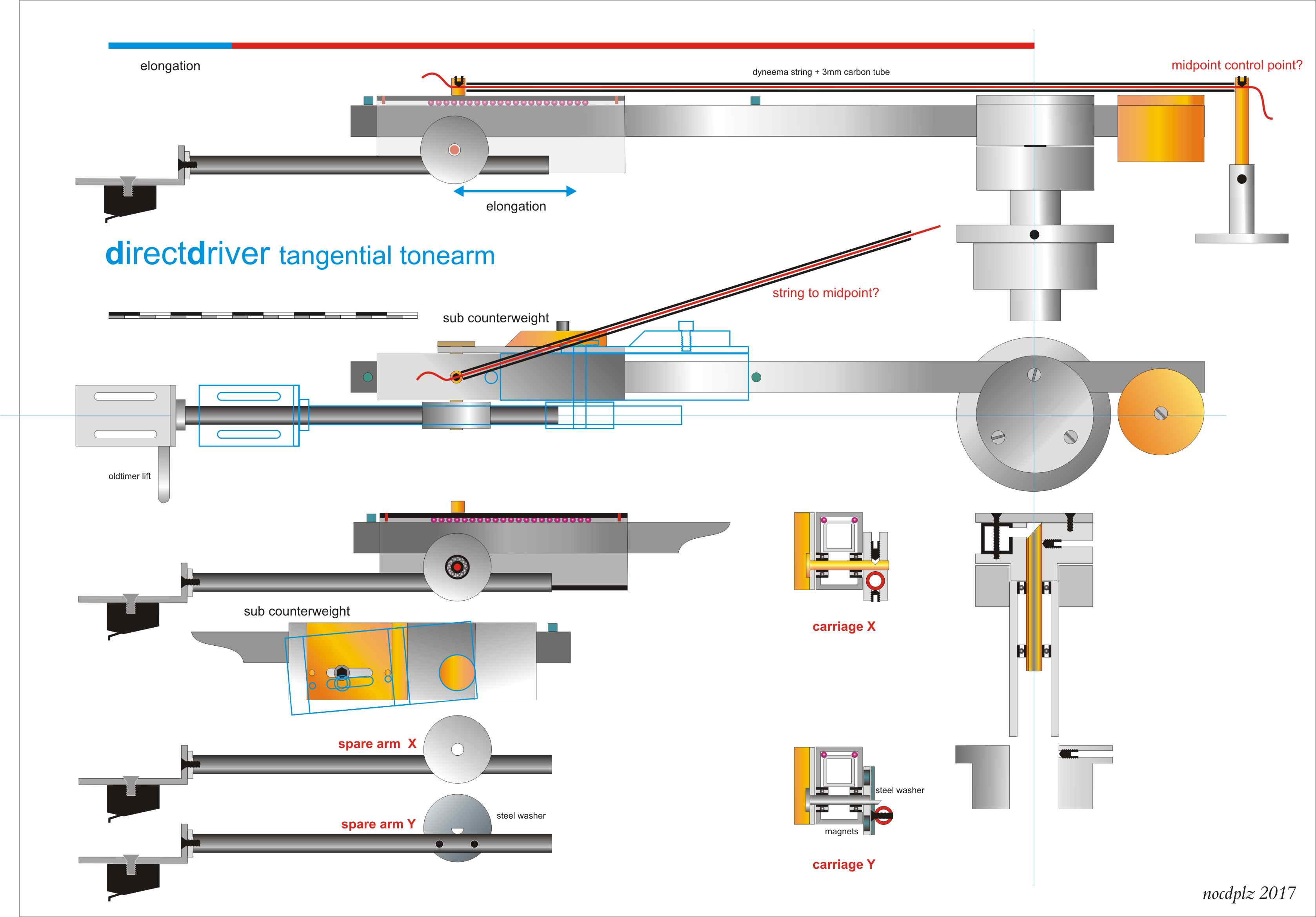

Hybrid teamwork
dear Dd, I was wrong: those carriages are OK, small, lightweight and well done (I had seen always others too big)
And, if one uses them this way (attachment), moving the rail instead of the carriage, even better.
Maybe we are beginning to see the light, a simple, low mass tangential!

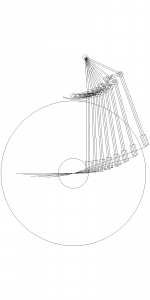

Thanks for all the drawings, Carlo. The design I have in mind is more like below, reusing your drawing and modifying it. It lacks detail but you get the idea. I prefer the slider right above the vertical arm so the carriage does not have to move high mass. Since separating vertical movement away from the carriage, the guiding mechanism can be anything and independent from the vertical arm, be it one string or two string approach or whatever. The tied point can be anywhere as long as stylus is tangent. Thanks again for your graphic work.
no thanks please, Dd - i make drawings because of my bad english, and doing those on your ideas makes me learn (it'easier to learn by others than by ourselves).
Personally i prefer arms with low effective mass, more adaptable (just add weight..) to cartridges with different compliance, and with the stylus kept as far as possible from chattering sources. But your solution is really valid, and even simpler to build.

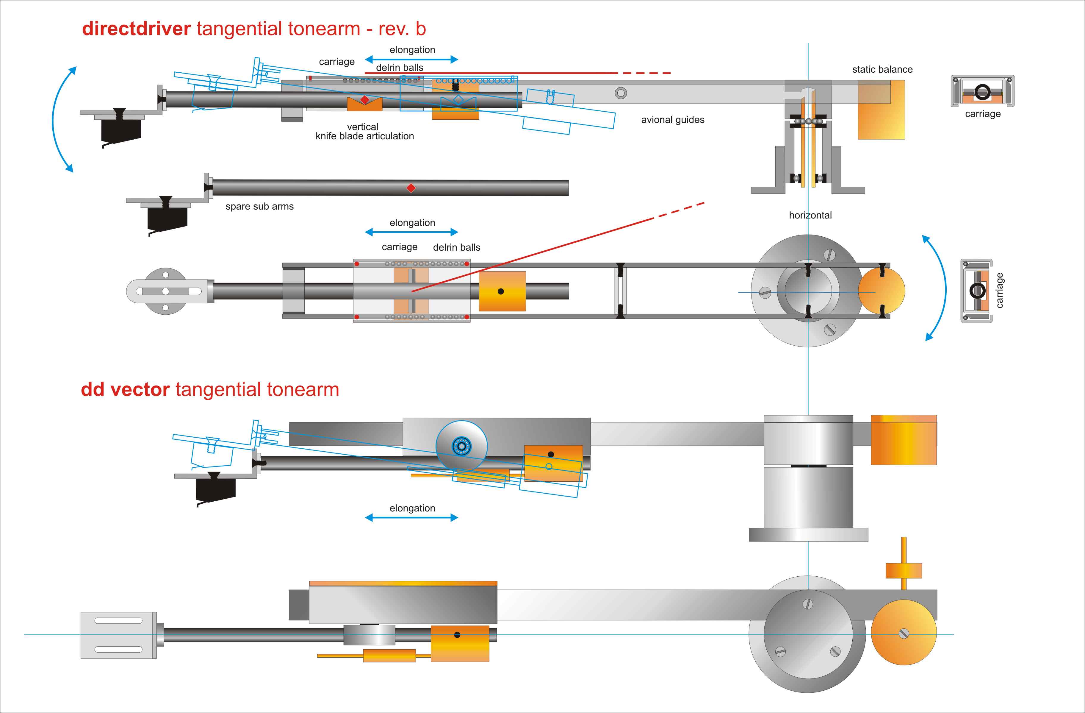

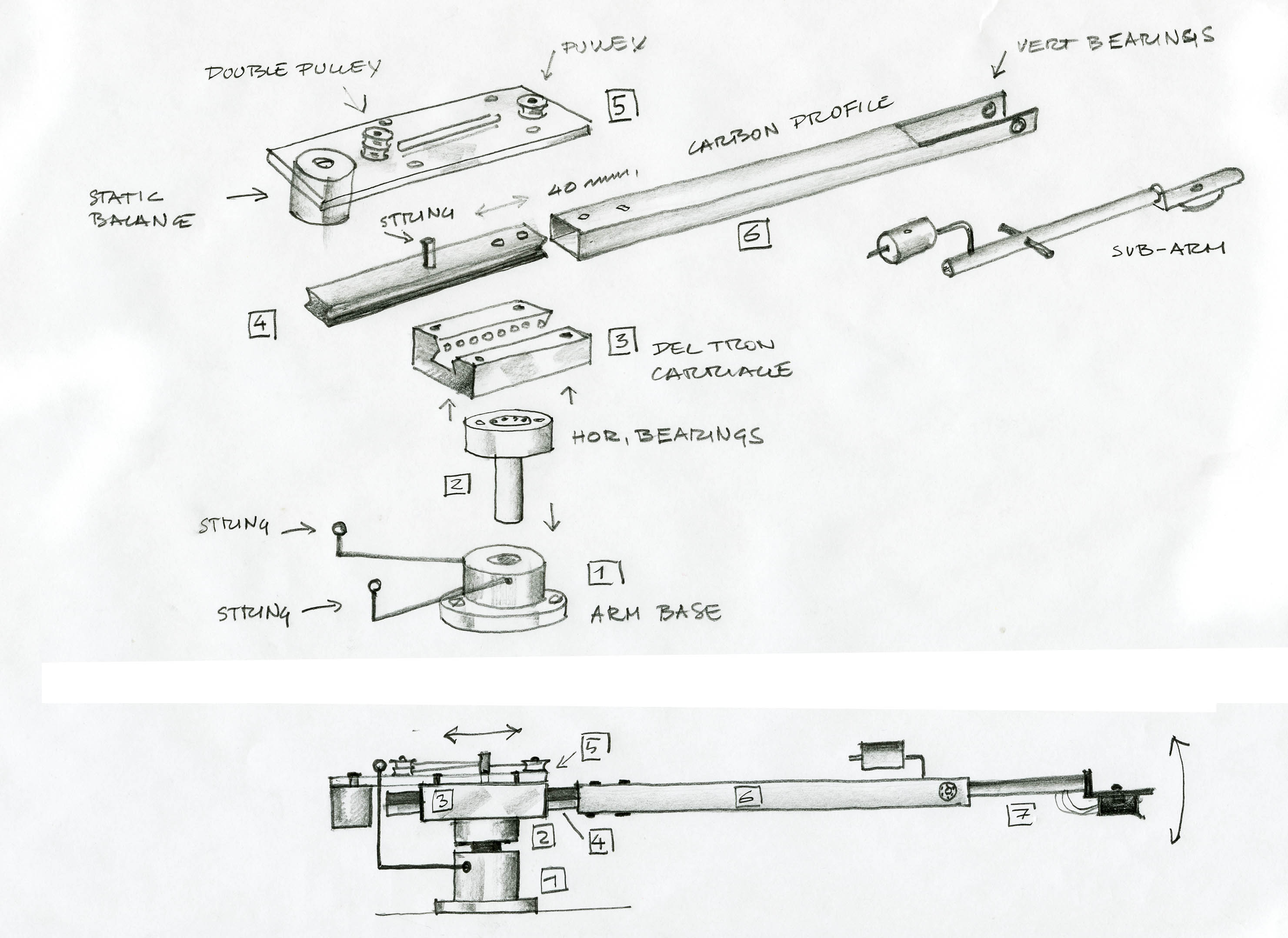

Last drawings for my Thales extensible arm.
Completely revised, according to the concept - fixed carriage, sliding rail - of which I had previously talked with Direct drive.
This allows to bypass some problems, including the VTF change (thanks Mark: although aware of the problem - post # 1254 - I had found - what a dumb - a totally wrong answer: the variation is unacceptable) and maybe get a smoother elongation than with the telescopic shaft.
Disclaimer:
This is not the design of a working arm, just my base to build one, and see if it works, and how.
Lot of doubts: It's complicated, and complicated things often work worse than simple ones. And for me are ugly too. For sure many things will change during build, starting from all those ball bearings ...
Any advice?
ciao carlo
If you enlarge (i've posted a PDF for this) look at the "elongation rail" that has a small brass rod. This rod will be tied to the string with a clove hitch, or other. This way it can move only due the rotation of the arm, it's not free to go anywhere, not forward nor backwards.
Now i'm convinced that the guiding mechanism is the crucial part of a tangential arm: if it's not in axis with the cantilever you'll get a skating force. If you leave it to the stylus drag it will overshoot till bending (as in linears, imho).
thanks for your attention, carlo
